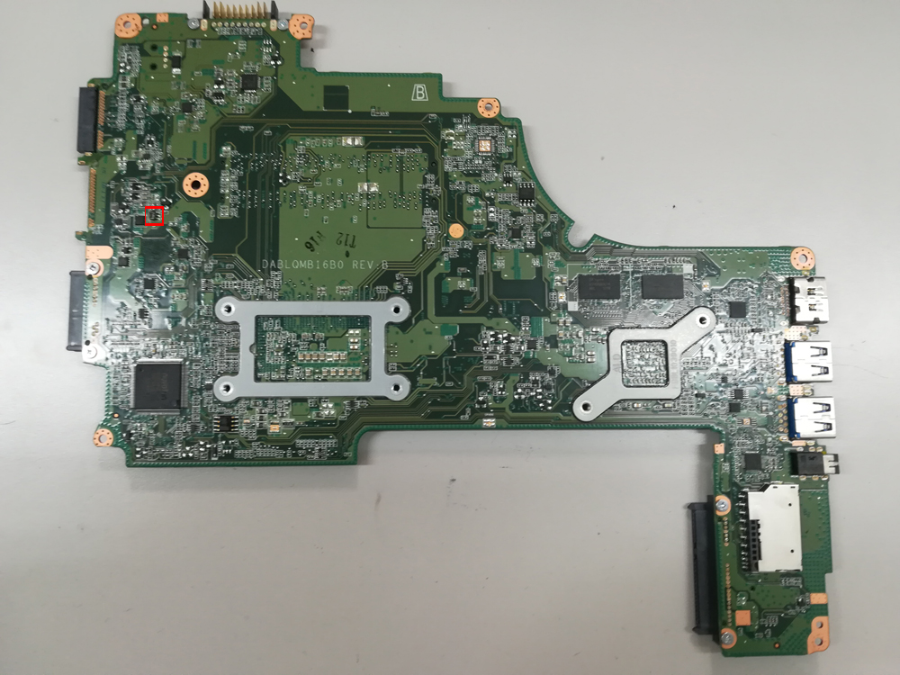

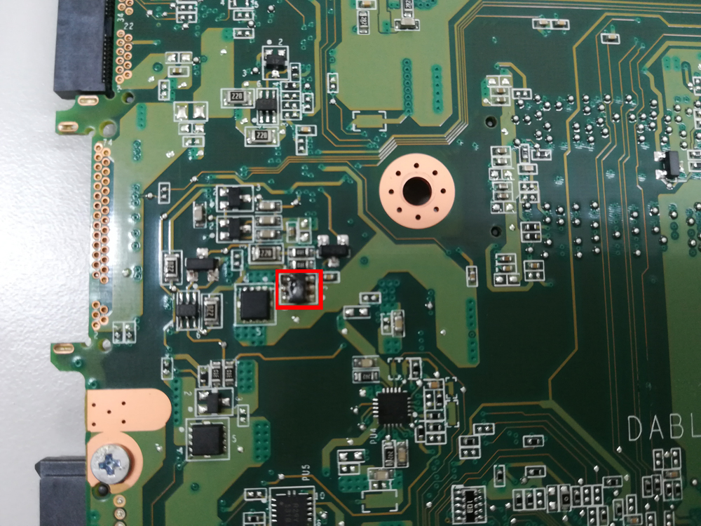

    Hello friends!
    This laptop has short on the line of 3V3.
    After visual check, I detected component in the photos melted, burnt, and shorted.
    I could not identify, to the lack of scheme, which I looked for.
    Some help?

    Re: Toshiba Satellite L50-C-1VK / Motherboard DABLQMB16B0 Rev:B / Identify IC
    That is actually a MOSFET similar to https://cdn.badcaps-static.com/pdfs/...efa9f251be.pdf
    Usually those are used to conditionally pass 3V, 5V always/S5 Rails to VS/RUN rails after the power button is pressed. They are less likely to fail their own. My guess is something on the output side has short circuit/leak which caused the MOSFET to overheat and burn. Start removing the MOSFET and check in the output side first
      Hello!
      It's not what I thought... pads are diferent...
      Any tips?
        Maybe 42RV ...?
          Originally posted by prolixo
          Hello!
          Any tips?
          I have an HD image of your board and the pins seems to be matching with the MOSFET datasheet i have posted.
            I have that mainboard here. The component as marked with 42CA 1N
              Hi Cláudio!
              Nice.
              Thanks for the help!
