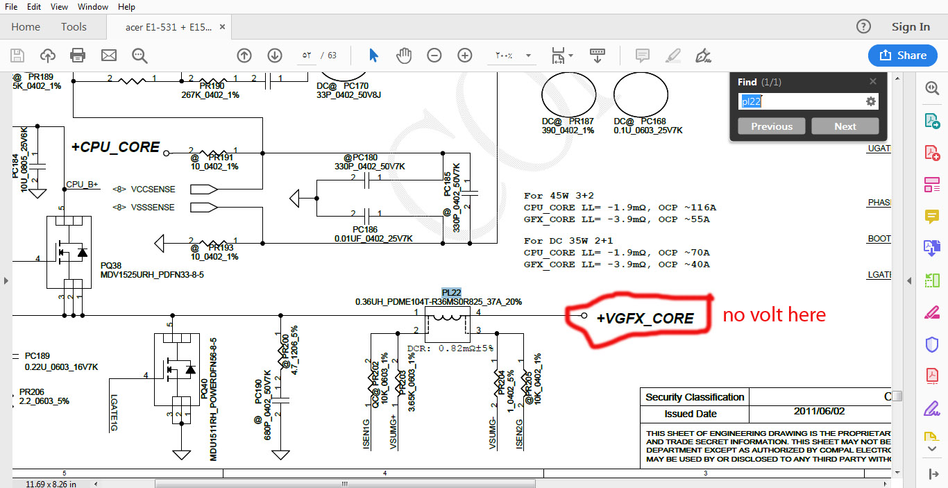

    I have acer aspire e1-531 turn on but without data . after check voltages all voltages is found except missed volt on coil PL22 for GFX core . I changed CPU but no data . after then I changed IC CPU ISL 95836 but no data too . I need for help

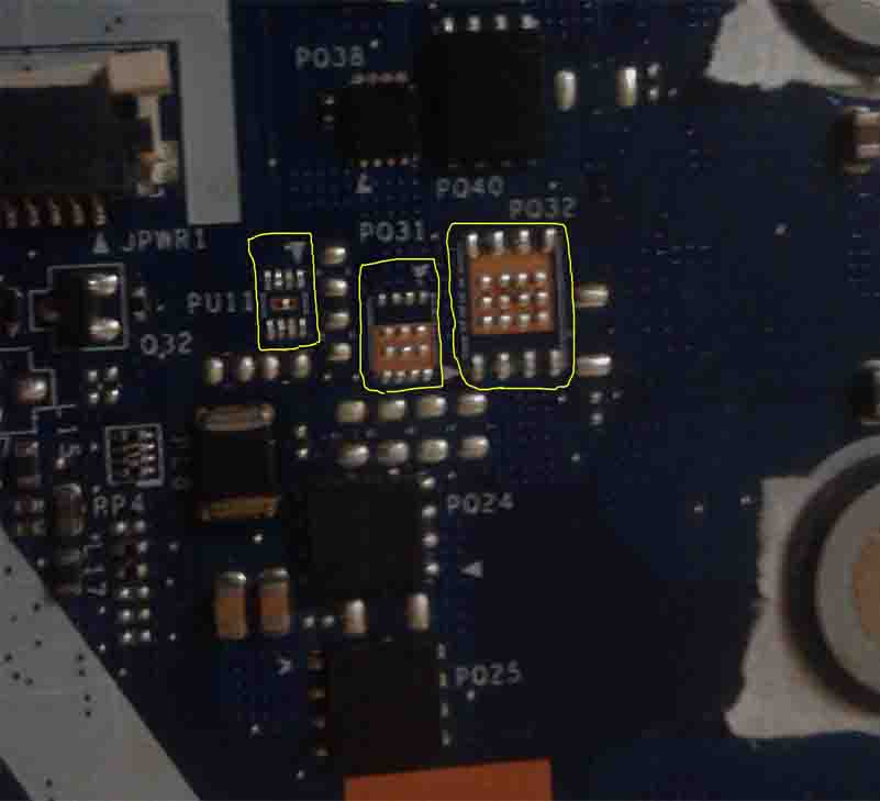

            Re: acer e1-531 black screen
            Note: PU11 + PQ31 + PQ32 not found on mother board
            https://www.badcaps.net/forum/attach...1&d=1560501457
            I tested the points again but the same measurement I wrote you in the previous reply

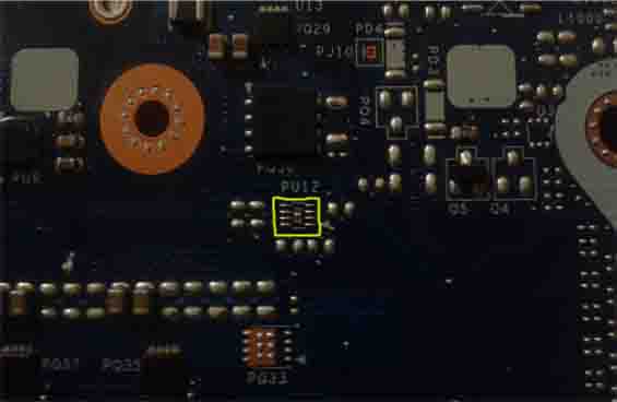

            PU12 voltage - Pin 6= 5 volt / Pin 7= 0 volt
            Note: PU12 is not found on mother board too
            https://www.badcaps.net/forum/attach...1&d=1560502748

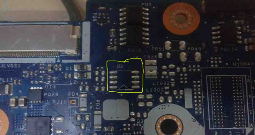

              OK page 44 is +VS line test U22 U21 U2 all pins (123) (4) (5678)
              • aliiash
                • Jun 2019
                • 99
                • england
                U22 - S= 5 volt / G= 19 volt / D= 5 volt
                U21 - S=3.3 volt / G= 19 volt / D=3.3 volt
                U2 all pins = 0 volt
                Note. U2 is not found on mother board
                https://www.badcaps.net/forum/attach...1&d=1560538948
                I wait your answer . Thank you

                        i think your mb is either LA-6901P or LA-7912P and on both these mb, missing gfx core is due to bad pch in most of the cases though main bios flash does help sometimes. So after probing all aspects if you dont find anything, try changing pch.
