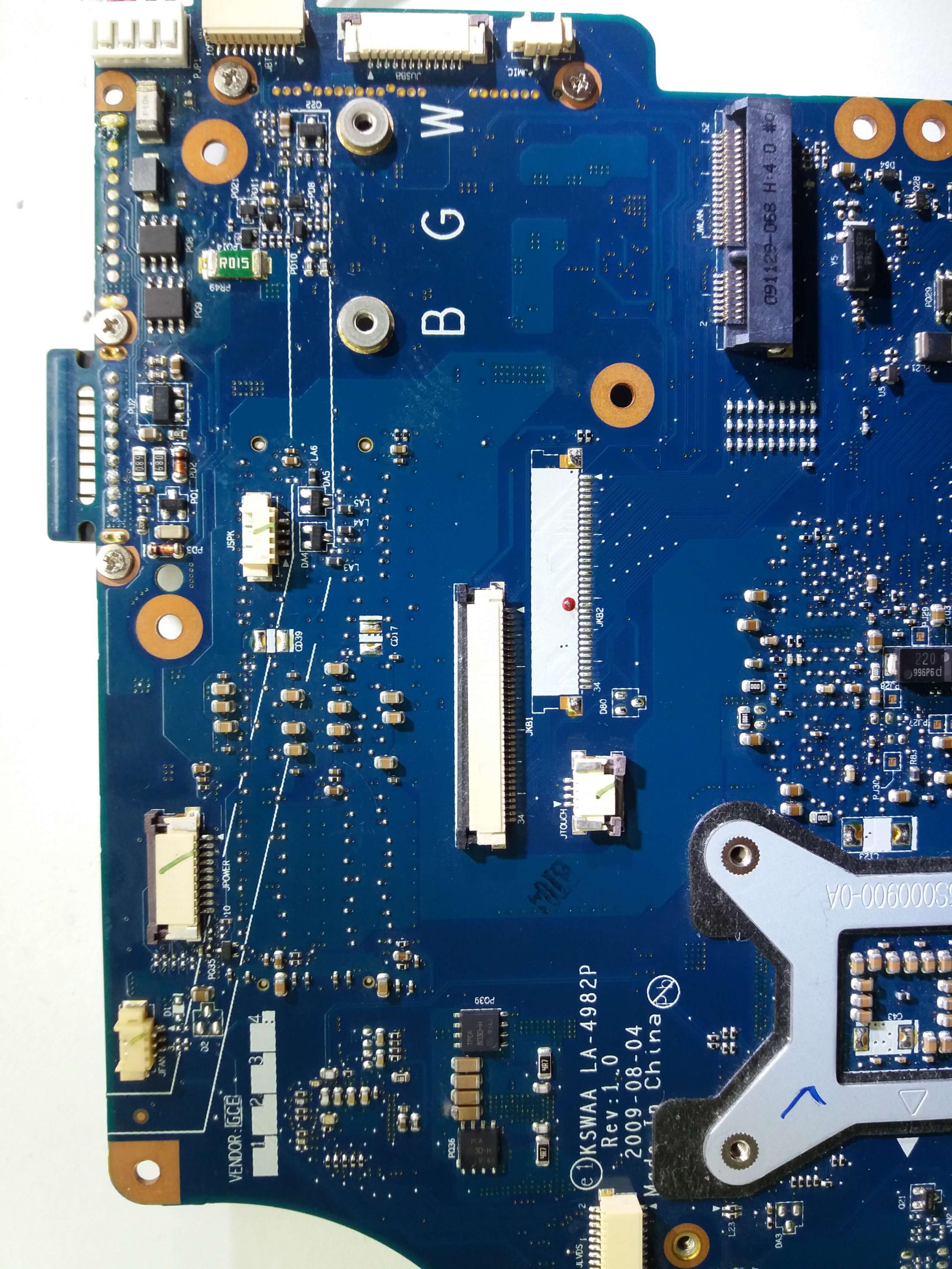

    TOSHIBA L500-1QE KSWAA LA-4982P REV 1.0 with VGA ATI 216-0728014
    no power, no led signal.

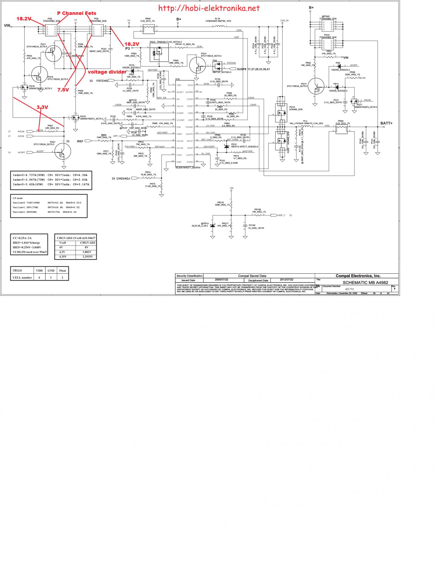

    the Voltages on PQ8 PQ9 not correct output pin 5678 of PQ9 must be 18.2V
    first test you Fets for any short & Ohms

        Test Voltage on PR67 both sides , try to find in GOOGLE how to test P-Channel fet S D G you have to check between don’t replace if you’re not sure

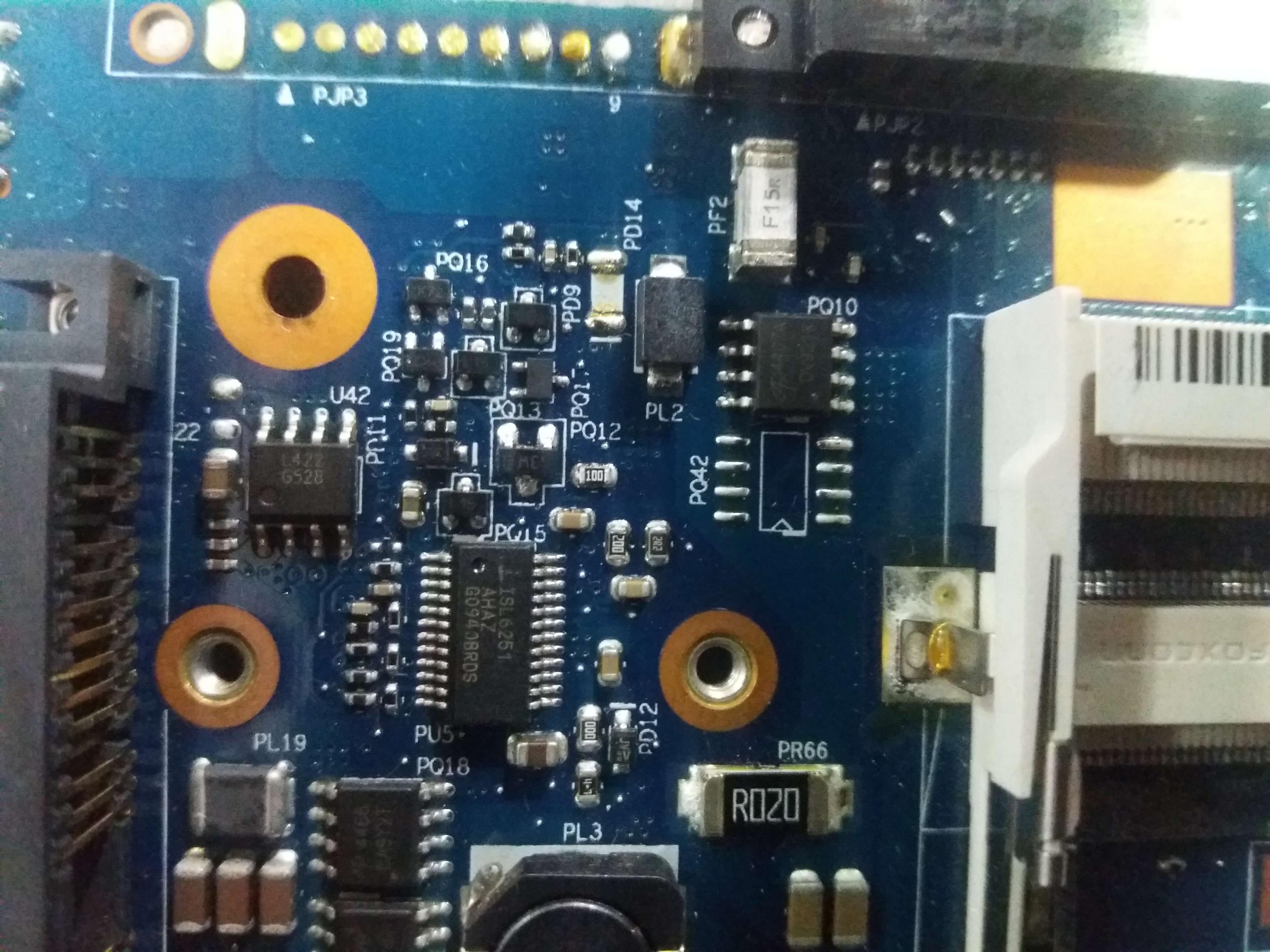

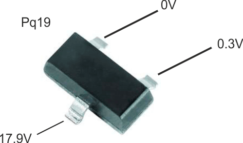

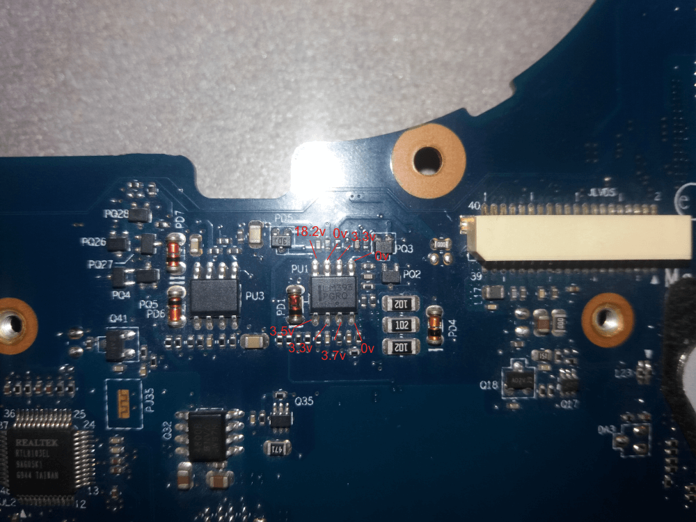

            ok then voltage on all legs PQ19

              Re: TOSHIBA L500-1QE LA-4982P no power
              Voltage on all legs PQ19

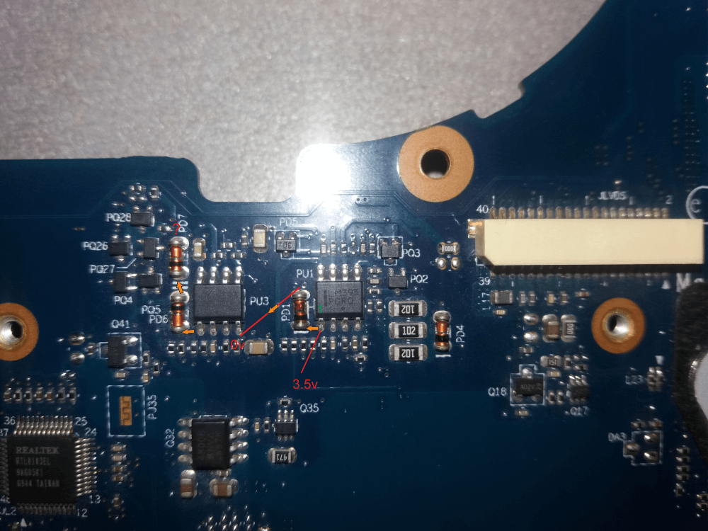

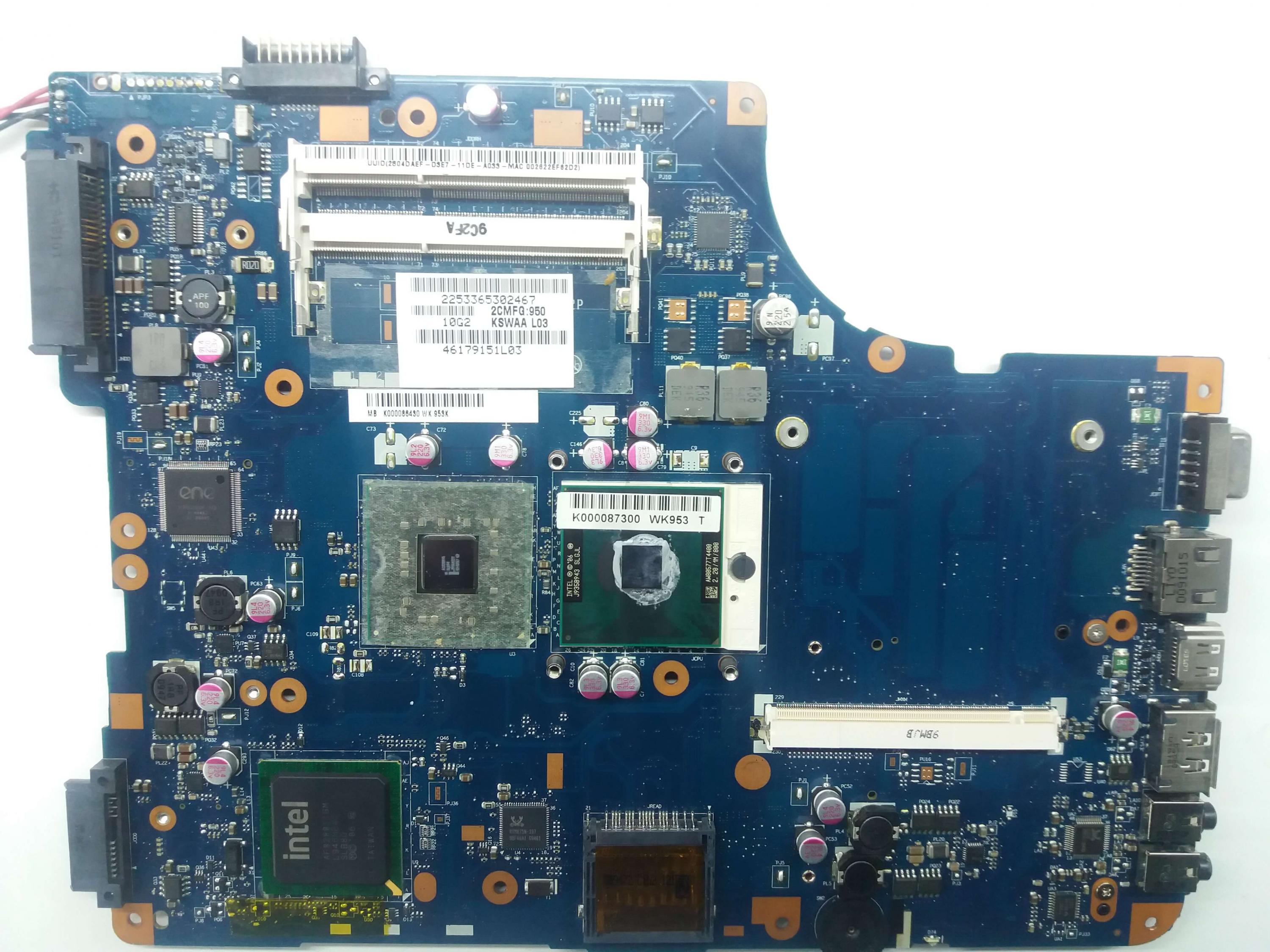

                PU1 A IC pin1 you should get 3.3V find that IC, PQ19 gate voltage should be 3.3V PACIN, what is the charger you are using try with another charger if you have uplode both side of the Mob in 2 pic
                  PQ19 gate voltage 18V???
                    PQ19 gate voltage must reach 3.3V this voltage come from LM393 PU1 comparator pin 1 3.5V through the Power diode PD1 one side 3.3V test the Voltage & PR67 but the register he’s not marked anywhere you have to do a continue to test to find out one side of PD1 is connected to that register PR67

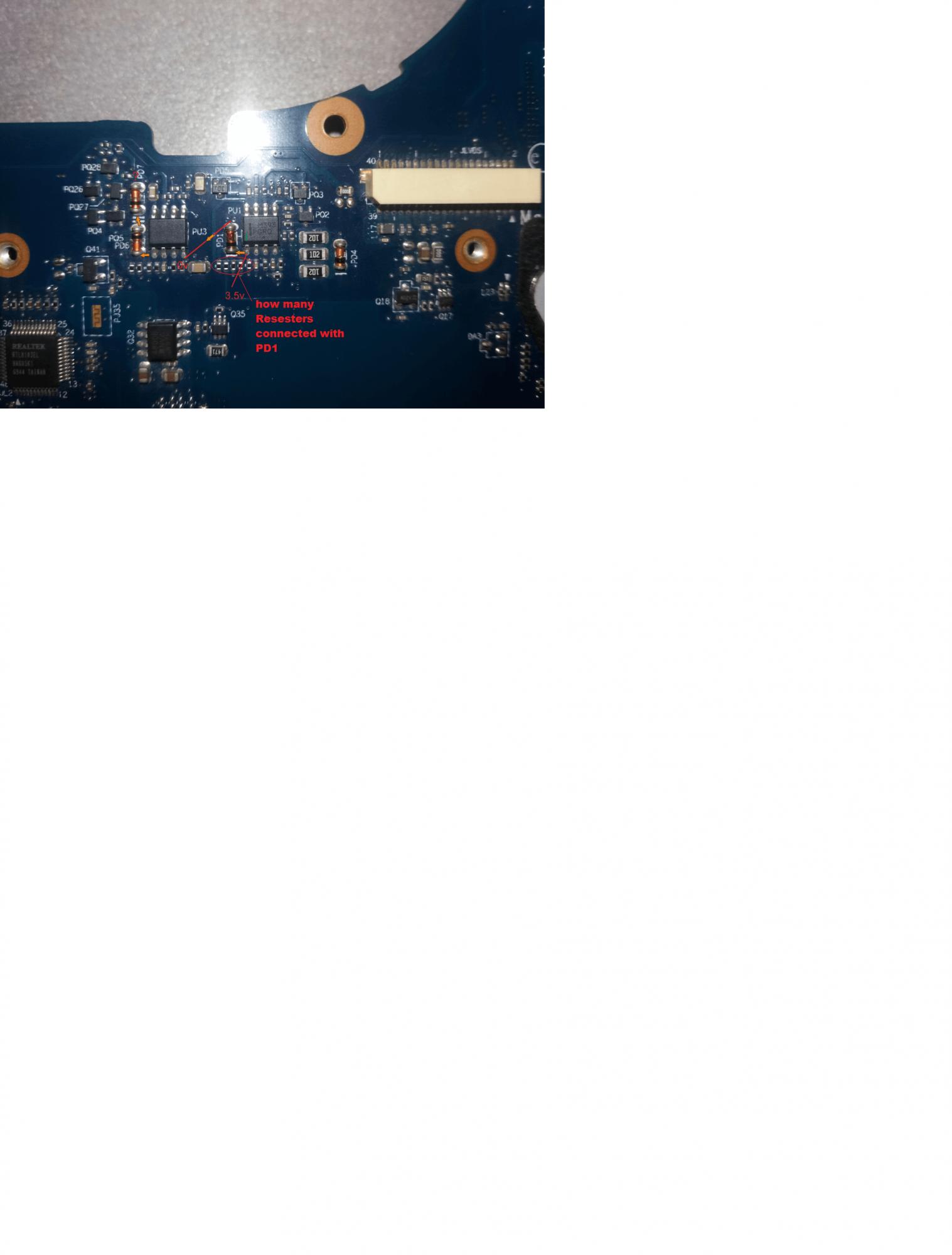

                        voltage on PD1 ? put the Multimeter meter in continuity mode and test how may Restarters of next to PD1 connected with the it
                          For a strange reason when i test Restarters of next to PD1,after that the laptop work....
                          Maybe a short somewhere...??/
                              no worries ,breaking solder joints may be the cause in that area you may have to heat up with some flux over heating might kill the Mob
