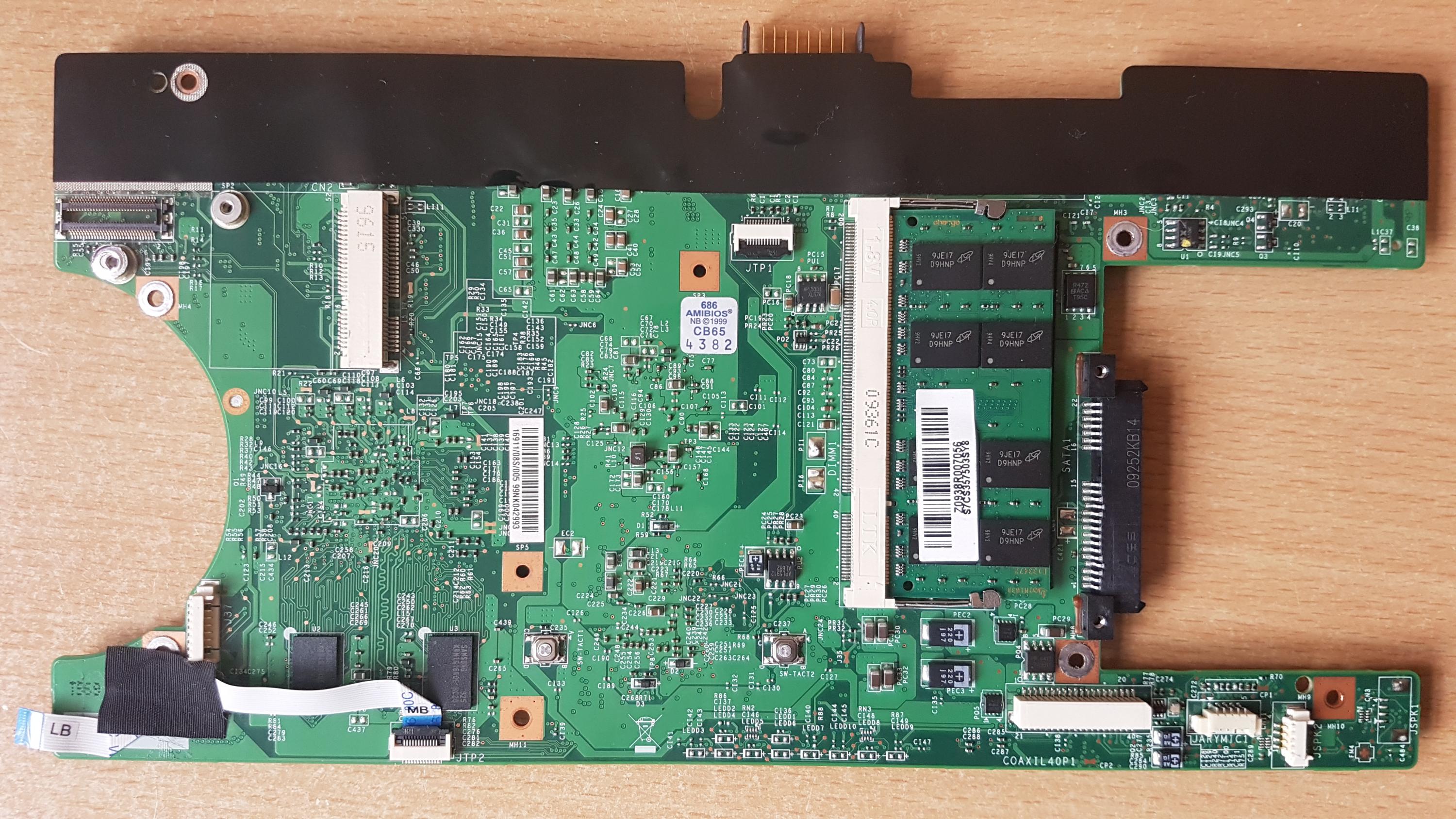

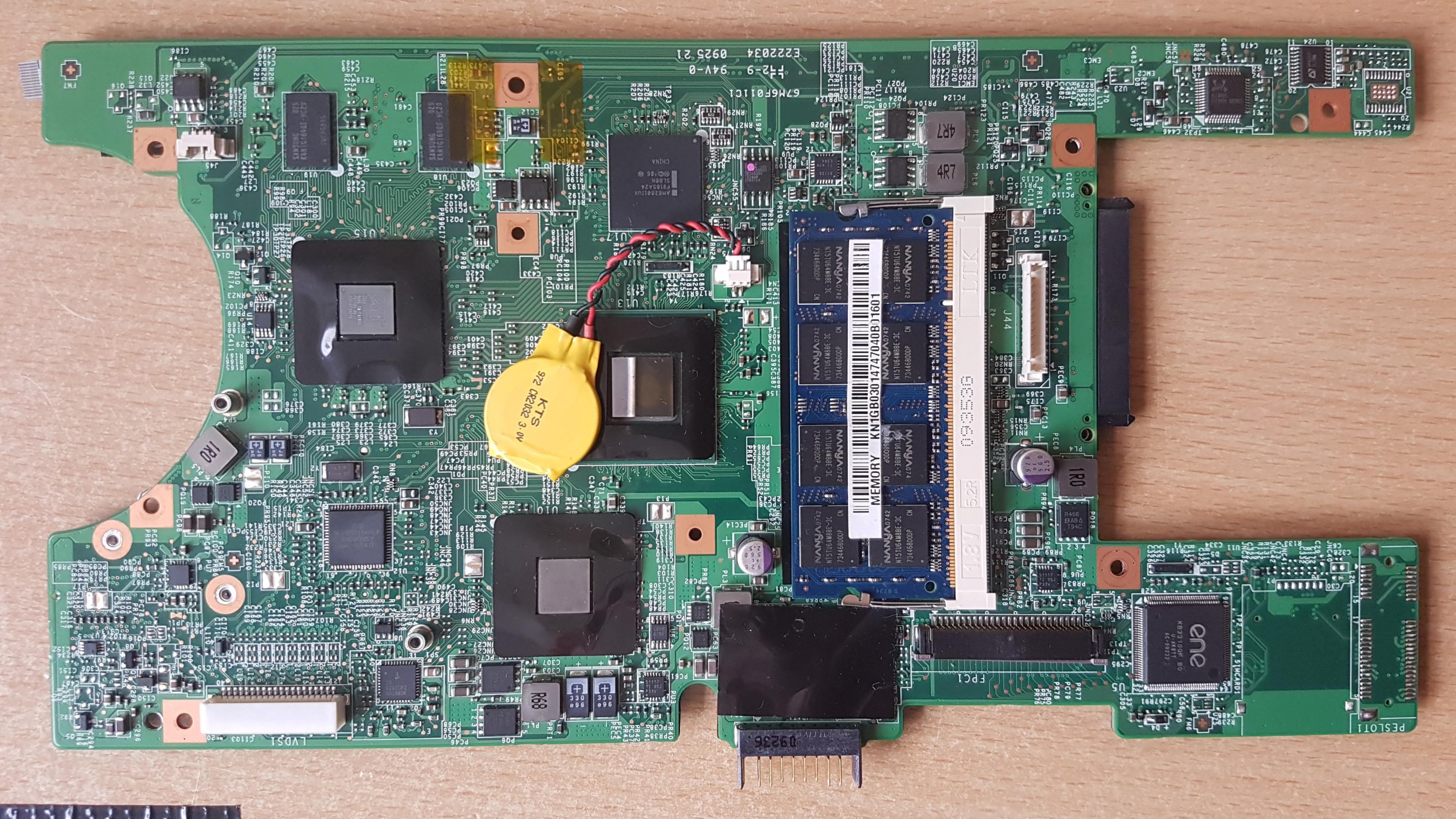

    Re: laptop Medion Akoya MD 9764 does not work anymore
    Here are pictures of motherboard
      check which ICs get warm or hot and which voltage rails are present on the mainboard.
        Hello, thank you
        I have 19 3.3 5 volts
        the laptop goes on and fan still lives
        an IC gets slightly warm
        Medion S5612 67M6F011C1 E222034 0925 21
            it is possible to be a Bios problem, but more probably it is a GPU problem. In addition, a few other problems are possible. Does the CPU or the GPU have voltage on this mainboard?

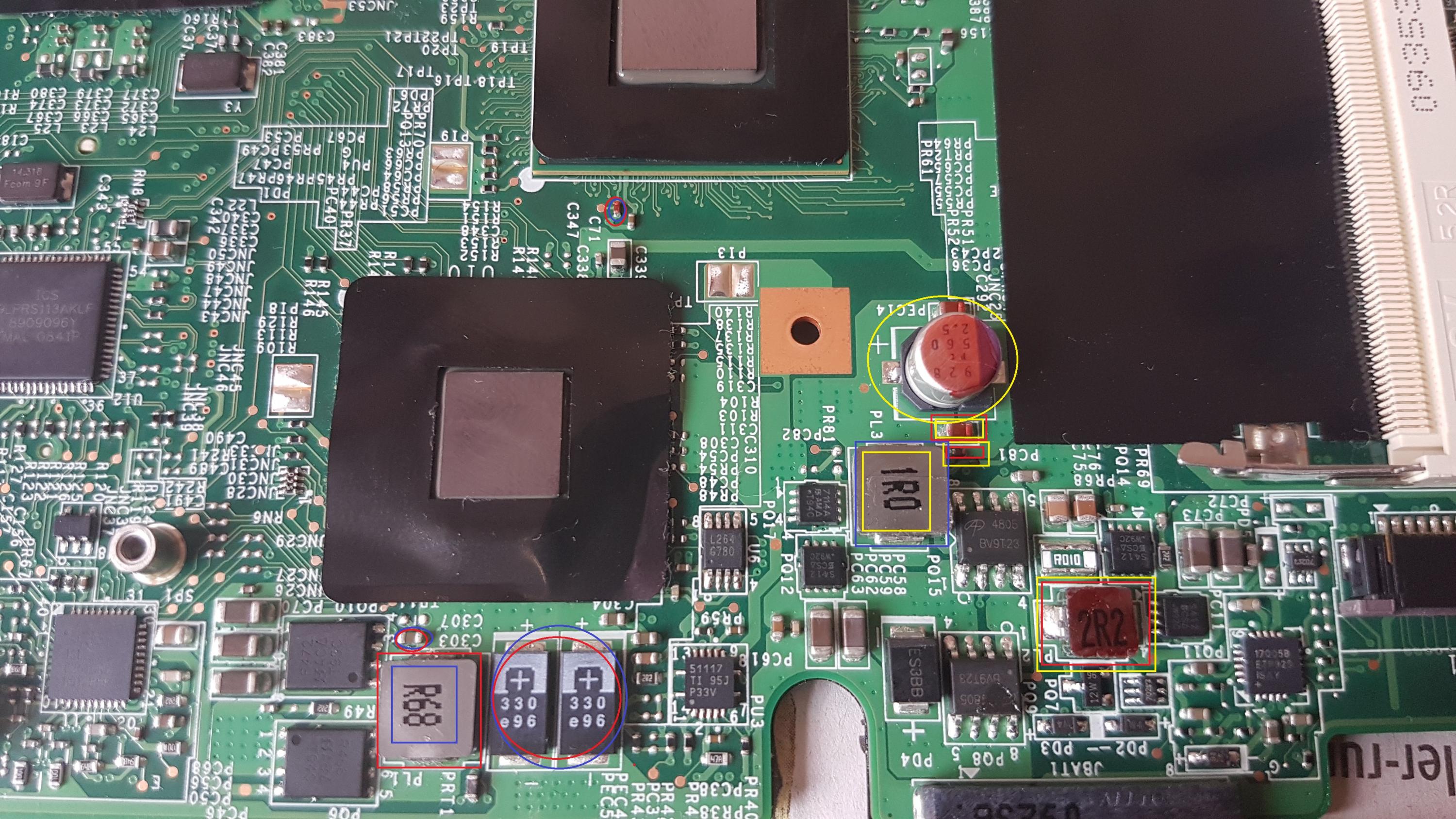

                                    yes I had bought that from Aldi,
                                    I have in marked places pieps tone, capacitors
                                      • 20792
                                      PQ8 looks damaged .
                                        hello no that's left of glue
