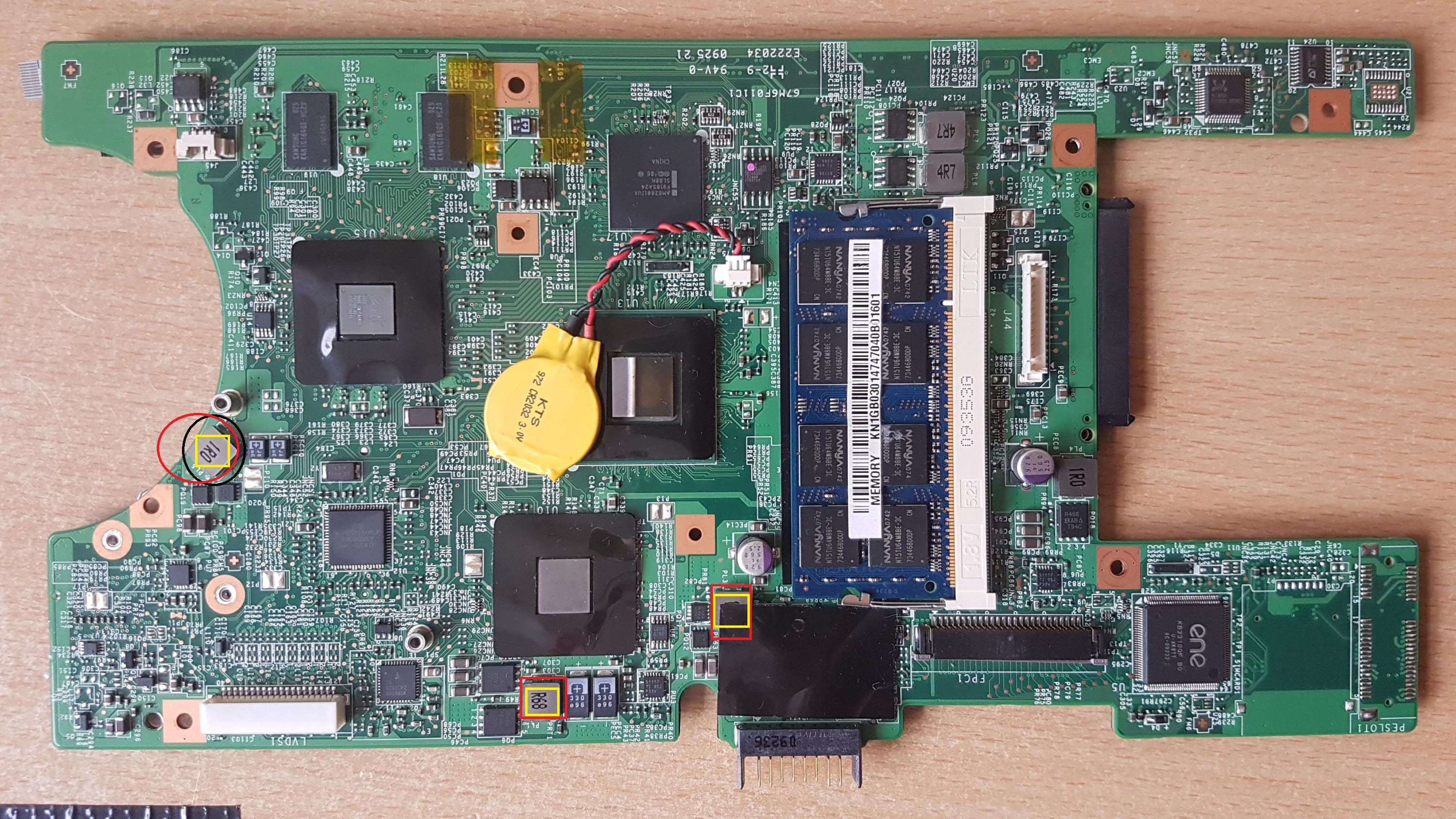

laptop Medion Akoya MD 9764 does not work anymore

    do you get a picture on external vga/hdmi

      Re: laptop Medion Akoya MD 9764 does not work anymore
      No
        I have no electricity at 3 coil
        1R0
        R68
        1R0
          Test PU2 voltage on all pins .
            Hello
            Thank you, I found it and I'll test it right away
            if that is broken, how do you recognize that ??
              hello i have all the pins the values
              1. 0.00
              2.808 V
              3. 1,522 V
              4. 1,522 V
              5. 5.0V
              6. 4,23 v
              7. 5.06 V
              8. 1.88 V
                • 21923
                Pin 6 should be 5V ,next test PQ3 .
                  1. 5.06 v
                  2. 5.06 v
                  3. 5.06 v
                  4. 17,61 v
                  5. 5.06 v
                  6. 5.06 v
                  7. 5.06 v
                  8. 5.06 v
                    • 21923
                    #29
                    +5VRUN is ok, now test volts on everything that follows in the power sequence on page 10 of the schematic.
                      Hi
                      Can you please give me the wiring diagram link?
                      why is soldered too hard, how can I desolder if I find the mistake
