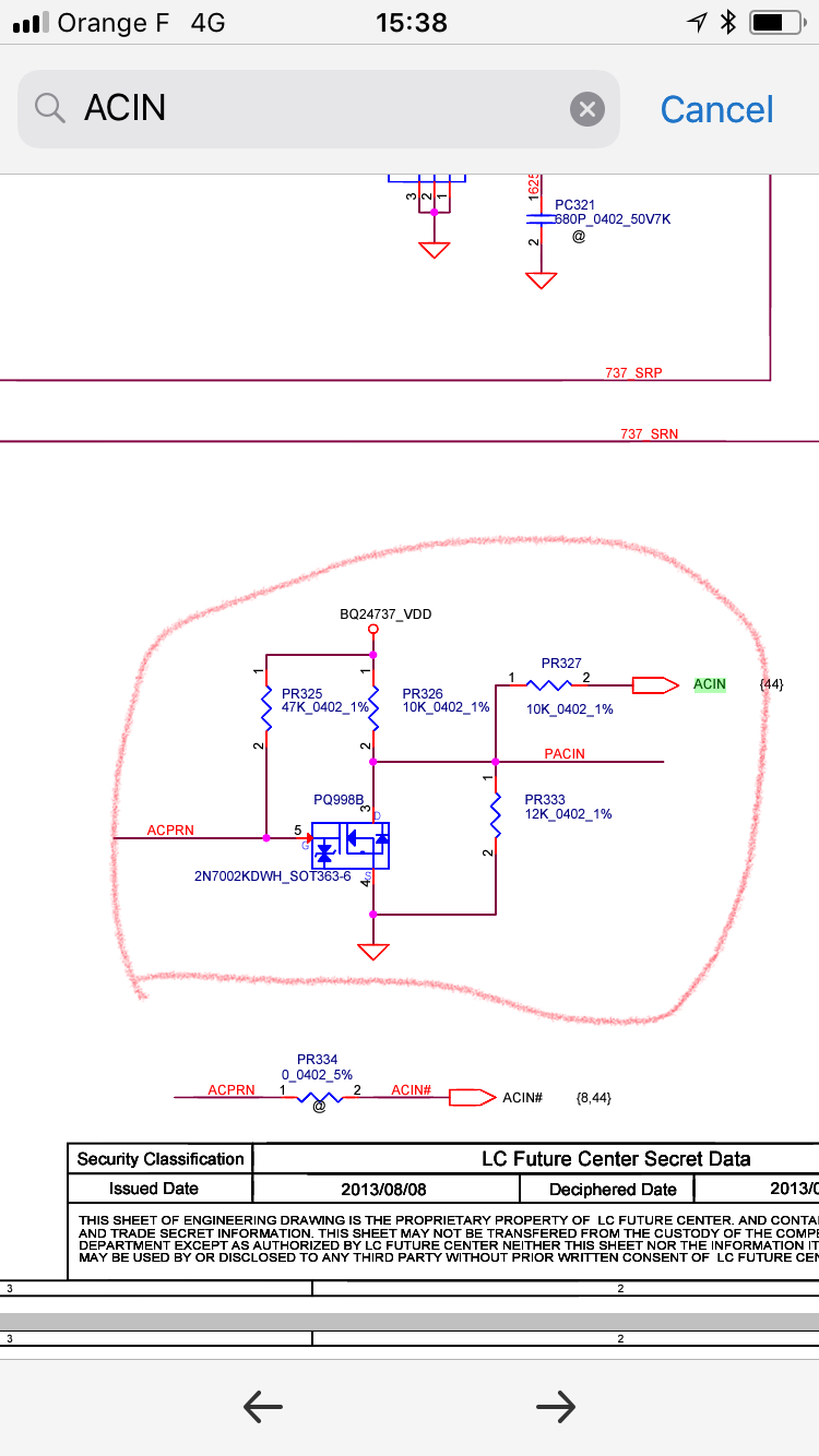

    I have Lenovo G50-80
    Mobo pn: Aclu3/Aclu4 NM-A361
    *Laptop Unit Status: if you plug the Charger Adapter. indicating power on status Light. i press the power Switch long Turn of then on the Light Again.
    *Before the unit before came in my technical Area. i pressing the power button unit turn on then light on indicator after 3 or 5 sec turn off?
    I decide dismantle the laptop unit. inspected first Check for water spilled negative on corroded mobo is clean. check the voltage from dc in. 20.2V.
    to fuse 20.3 on all rail.
    check on PQ301
    123 - 20.3V
    4 - 5V? i i have question for this. it is Voltage Drop?
    5678 - 20.3V
    I check the Mosfet. Mosfet is Good
    check on PQ302
    123 - 20.3V
    4 - 5V
    5678 - 20.2V
    Also This Mosfet is Good
    check ic - PU301
    1. 20.3V
    2. 20.3V
    3. 0V
    4. 1.6V
    5. 0V
    6. 2.6V
    7. 0V
    8. 3.3V
    9. 3.3V
    10. 00.8V
    11. 1.5V
    12. 1.8V
    13. 1.8V
    14. 0V
    15. 0V
    16. 5.9V
    17. 5.8V
    18. 1.8V
    19. 1.8V
    20. 20.3V
    try to change this IC. same Prod Code BQ737
    Same. Problem nothing Happen
    then i Check
    PQ303
    123 - 20.3V
    4 - 20.1V
    5678 -1.8V
    other i Check the Always... 3.3VALW & 5VALW.
    Which parts are Faulty?
    Need to your Advice.
    TIA.

    First 2 Fets are good pin 4- 5V is the gate pass to bypass Voltage it's a P-Channel fet

      PU301 pin 5 ACOK voltage is not correct 3.3V SIO is not detecting presence of ACOK signal trace it back test pic all components

          i Flash the bios. still same problem.
          I confuse why if i Plug the charger adapter automatic the light indicator has been light up? also i observe the battery pack installed 2 indicator light up and why not showing the orange light? only 2 white led only.
            thanks you. I will try Later
