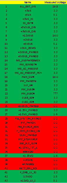

    Have this ASUS ROG G751JM that self start and no VCORE and VGPU
    attached readings and repair manual shows that PM_PWROK signals is missing
    later i make tabe from readings
    have anybody complete schematic for it?
    What can be wrong when it self start?

    Re: ASUS ROG G751JM - self start and no VCORE and VGPU
    from this table of measured voltages looks like it all started from missing 1.05VS_PWRGD signal. so tomorrow i start from it
      No schematics for newer Asus. Last one available is UX31A2 AFAIK.
      You're missing ALL_SYS_PWRGD so there's at least one S0 rail missing before VCore.
      You measure 0V on +1.05VS_PWRGD so the issue is probably there. With the boardview check the voltage on output, input and enable signal of the +1.05VS regulator. Then mesure the resistance to ground on output of the regulator.

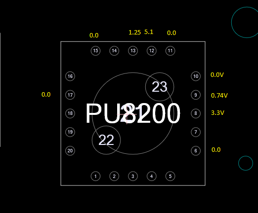

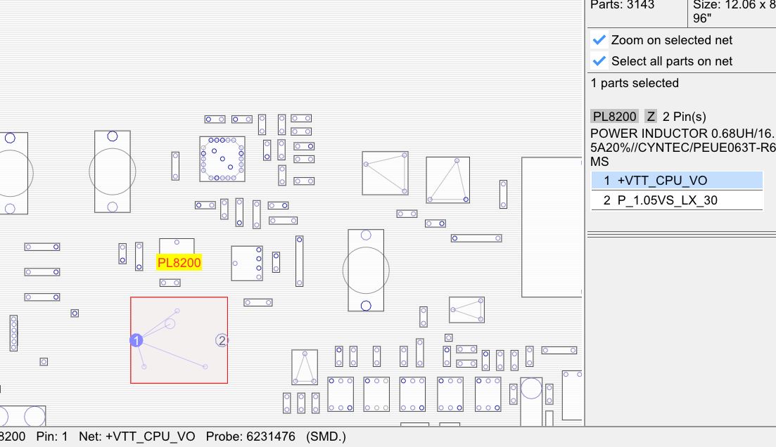

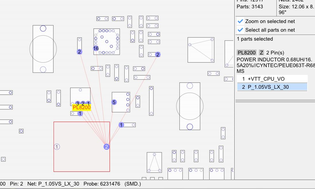

            i have readings from U8200 and i have VIN and EN. but this TON looks like low to me. what do u thing after this reading?
            resistance on 1.05V line is 76ohm

            • piernov
              • Jan 2016
              • 4437
              • France
              I think TON is supposed to be somewhat low.
              The regulator got input voltage and enable signal, but doesn't start switching at all. It is probably bad.
              Do a visual inspection of the circuit around it to make sure the resistors aren't missing/damaged.

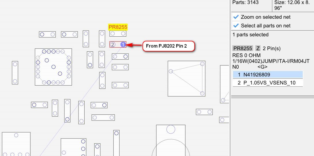

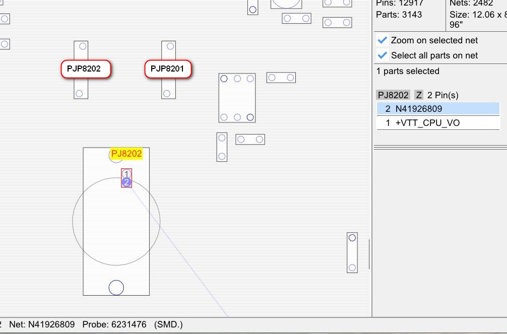

                        i noticed that on PJP8201 and PJP8202 which is rail for 1.05V is resistance 96ohm, but when i attach charger it goes to 0ohm. try to isolate short, but when i desolder both PJP i get 0ohm on both side of it

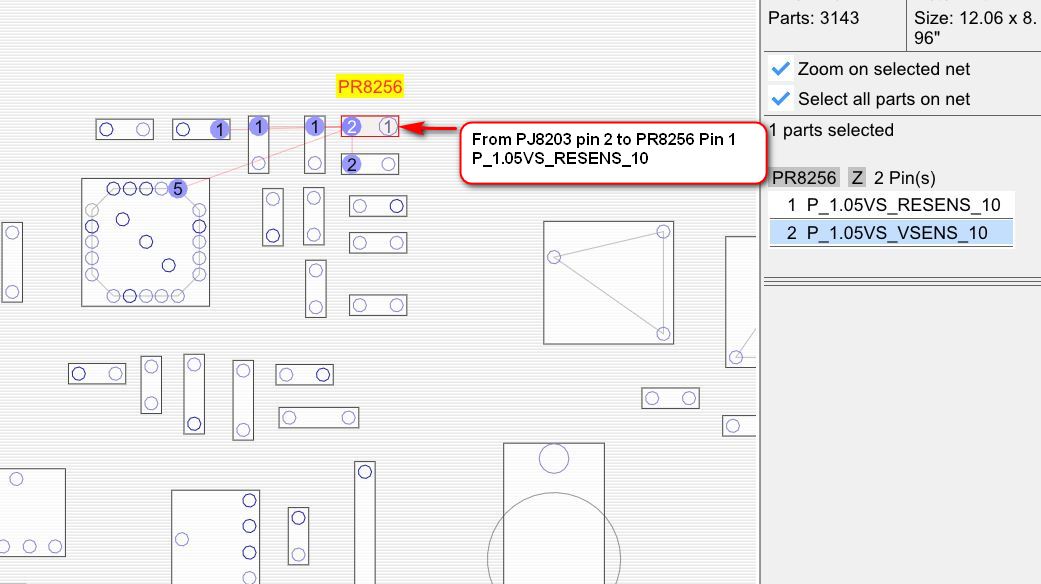

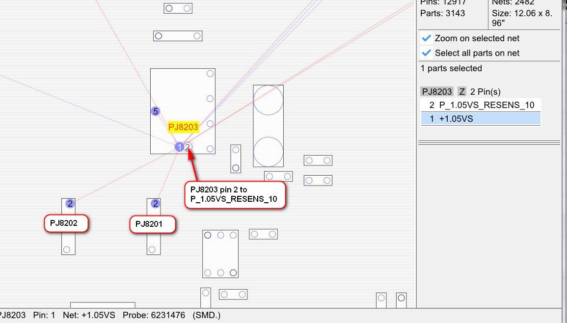

                          • 21197
                          Check jumpers PJ8203 ,PJ8202 and resistors PR8255 ,PR8256 and others in that area .

                              • 21197
                              No, just boardview. PJ8203 and PJ8202 are interlayer,if you trace where they go you can see why you get 0ohm on both sides of PJP8201 and PJP8202
                                i get 0 ohm only with power so there must be some switched power rail from 1.05 that is shorted. but im confused that when i remove both PJ still both side is shorted
                                  • 21197
                                  What boardview software are you using ?
                                    • 21197
                                    I think the short is around PR8255 and PR8256. You can see how PJP8201 and PJP8202 are connected,what pins 1 and 2 have in common.
