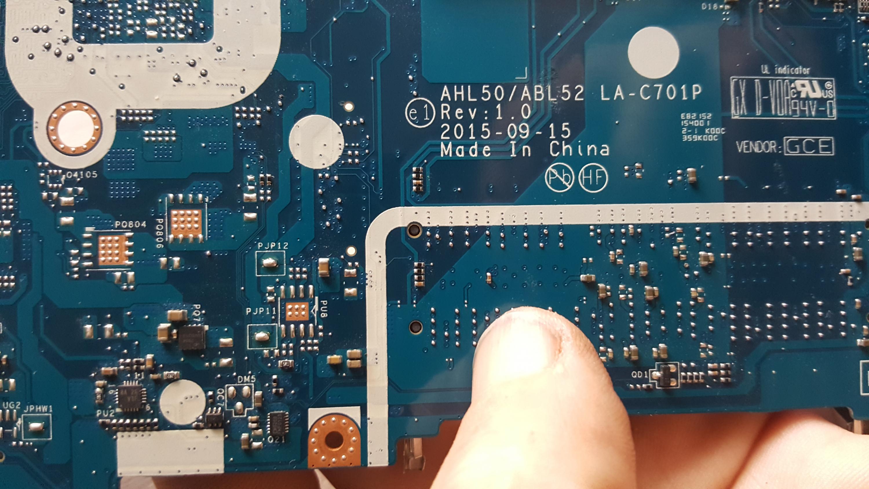

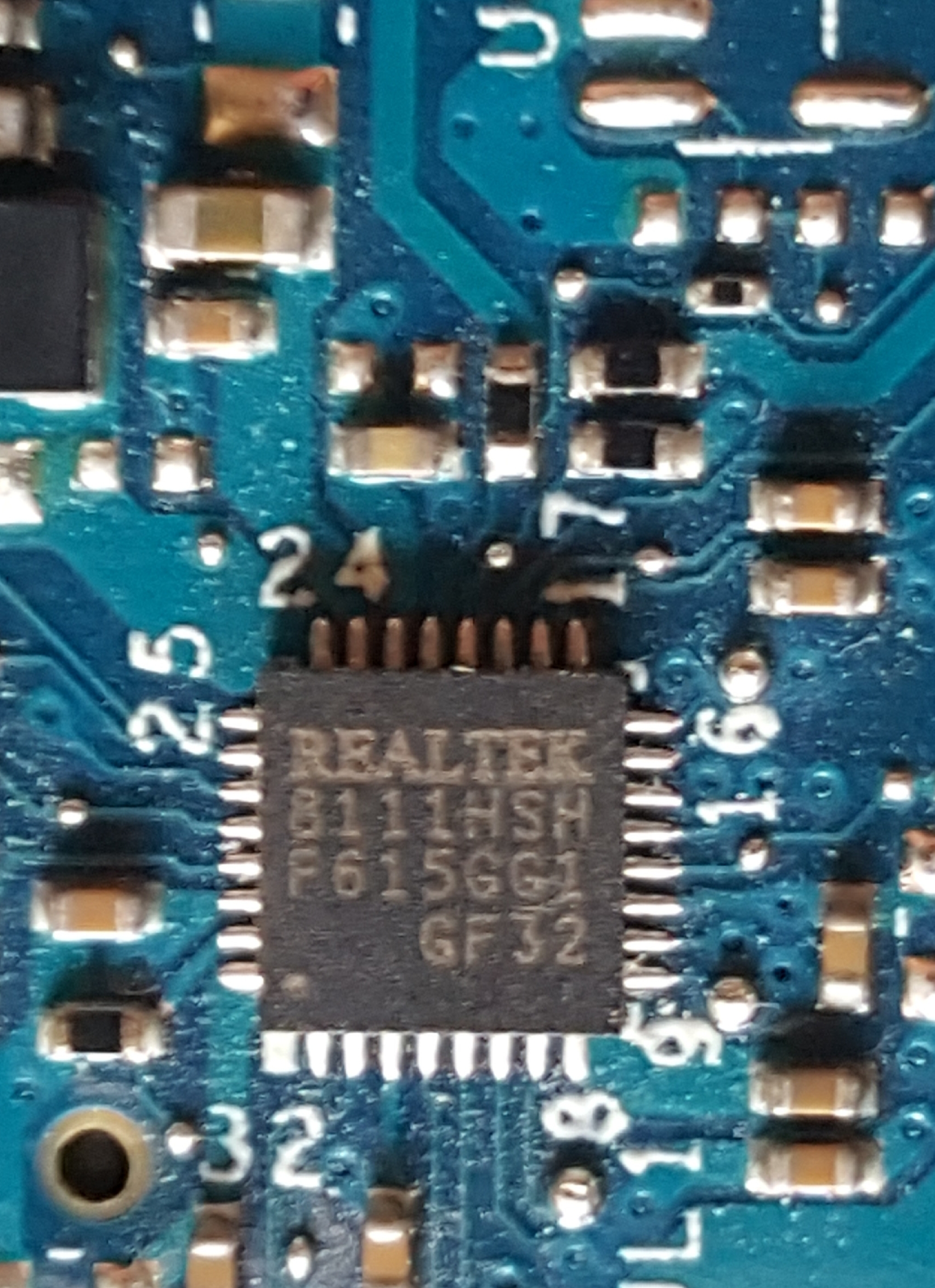

    I have to replace a realtek 8111GUX but I have a different version , 8111HSH.
    Unfortunately this chip is located on LA-c701P motherboard and there is not boardview or schematic to compare pin .
    It's possible ?

    Re: Realtek chip 8111XXX
    From photo by Rimas LA-C701P use RT8166EH:
    https://drive.google.com/file/d/0Bwq...85dVAyQm8/view
    Compal LA-C501P using RT8111HSH, that schematic quiet close with C701P
      I see your pics, the motherboard seem the same with a different chip.
      a new compatibility ?
        RT8111 vs RT8166
        Look like both are compatible, just be aware, seem for RT8166 unmount LL2 etc, meanwhile RT8111 need mount LL2 etc, try compare with High image Res LA-A994. Probably that REGOUT not compatible, unless need modify a few part.
        Also LA-A994 use RT8111G on schematic, in fact RT8166EH.
        RT8111HSH vs RT8111G
        I think totally compatible, but not sure 100%.
