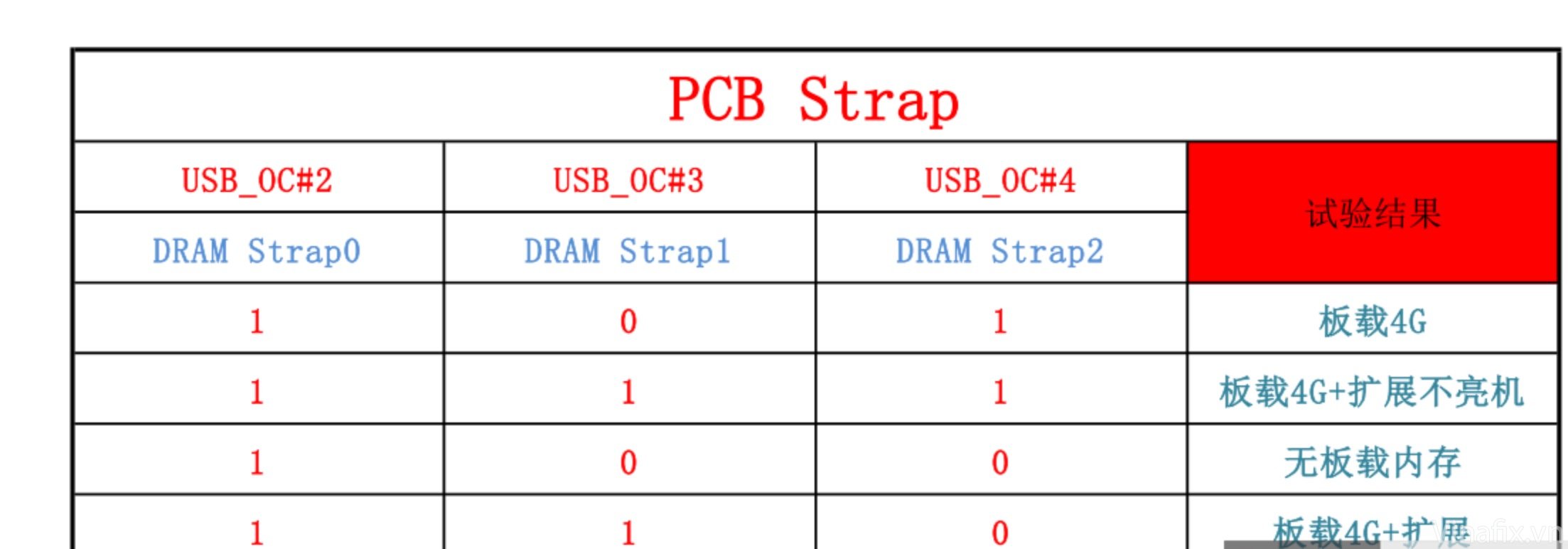

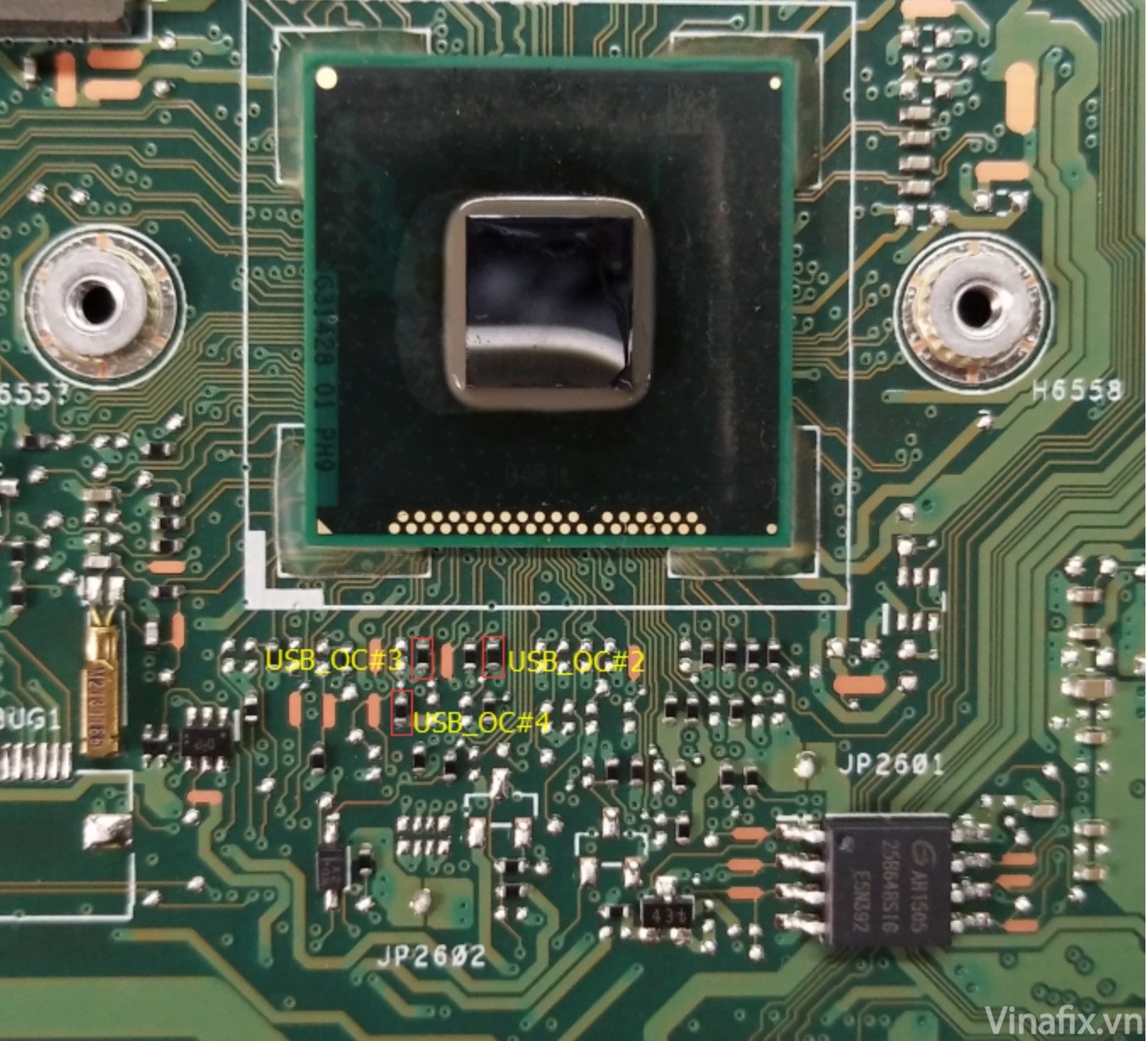

              Re: Asus x550jx onboard ram disable?is it possible
              I only have this for x550jx:
              1. it's Chinese, or another language incomprehensible to me
              2. move or remove?
              3. what configuration to choose?
              Would anyone know what to do about it?
              • satishkumar
                • Sep 2015
                • 164
                • India
                2. move or remove?
                Follow page no.26
