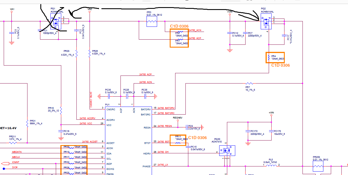

    Hi Guys , hi got this notebook in short .
    Initially was no short but totally dead , replaced PD1 but now i got short , when i plug a charger it , go in protection.
    Measuring in diode mode on pin 3 i got 0 short to ground . What can be checked ??? can i inject voltage with bench psu to detect heat?

    test PQ1 N Channel Fet in diode Source Drain Gate mode this might be your short
    test PC5 & PC1 Caps

          i removed pq1 and short is gone ... measuring it source to drain are 0 its gone ?

            i replaced with new one pq1 and now seem to be killed 0 in reading , beforce was like 390 in diode mode...

              ok with pq1 removed i found that source pin are short to ground

                yes so PQ2 section pc 12 and 7 .. . idont have boardview files

                  PQ1 is a N-Channel Fet place the Red Probe in either of pin 123 pins Source side & Black Probe in either pin 5 Drain side test Value & Black Probe in pin 4 Gate Red probe in Source either of pin 123 for Value & Black Probe in pin 4 Gate Red probe in Drain either of pin 5 for Value in diode mode if its 0 ohms that's bad

                      no need of Boardview Schematic is fine if you follow through, do you have bench psu if so you can inject voltage to find out the heating SMD components but no 19V

                        yes out of board i have now this situation with pq1 removed.
                        i already checked all the caps in the line out of the board but no one is in short
                        pc7 pc17 pc12 pc2 pc36 pc25 pc35

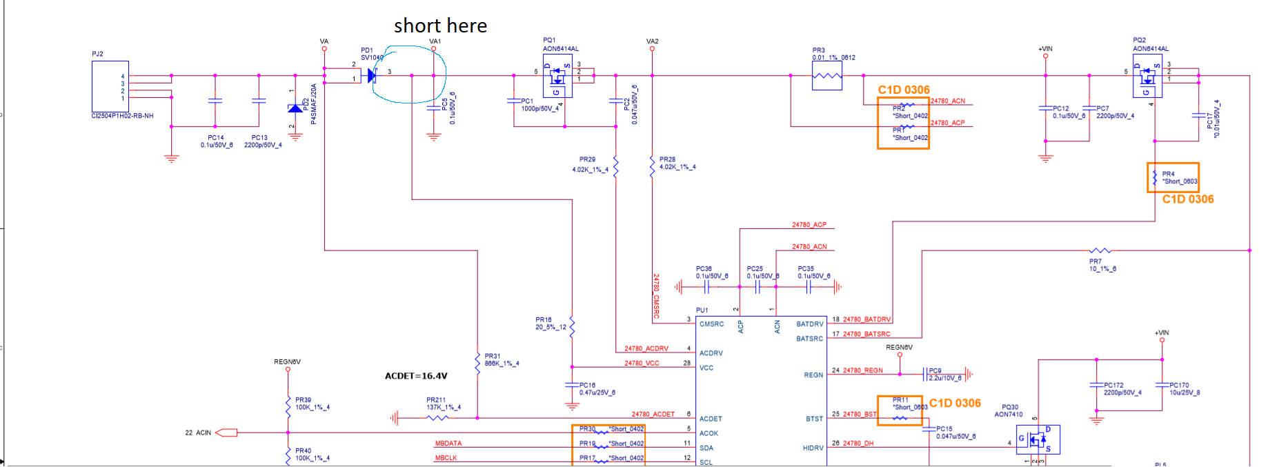

                          i injected 5v 2a but no heating that i can sense with hand ... ?? how many amps can i try ?

                                Since your CPU is getting hot you have to check 19V caps, SOC CPU all integrated PCH etc
                                Trace Schematic May be Page 27 28 29

                                  Test PJ8000 PC8001
