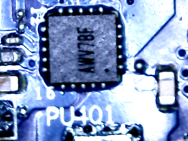

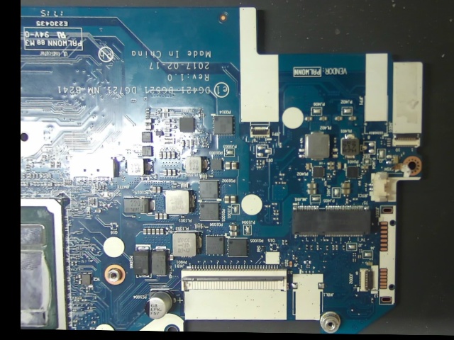

    HI.All.
    Lenovo IdeaPad 320 NM-B241 rev.v1
    Water damage
    this ic very hot PU101 :awv7bf I do not know what it is for
    what is AWV7BF

    Re: Lenovo IdeaPad 320 water damage
    Sy8286b

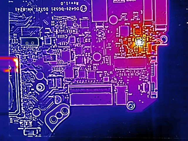

      nice. what camera u have and cost of it?
        Originally posted by torla
        HI.All.
        Water damage
        what is AWV7BF
        Same question what was the Cam?
          Originally posted by piernov
          Sy8286b
          thx thx thx bro
          this: super tools
          https://www.unionrepair.com/thermal-...ubleshoot.html
            I have a similar problem with an Ideapad 330
            It looks very similar and here the chip is a BQ24780S
