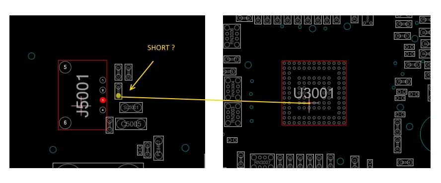

    Before opening this thread I read all the topics I could find on this forum about similar problems.
    I have an Asus Zenbook UX51V with a faulty mainboard (internally shorted PCH and ITE) and so I bought a used replacement board.
    Everything is working fine, Windows loads without problems, all drivers are installed and every device is working fine, except both fans are spinning all the time at full speed as soon as I turn on the laptop.
    In Windows, using HWMonitor temps are normal and if I stop the fans with my fingers temps do not rise suddenly (new thermal paste applied and heatpipe is making a good contact with both CPU, GPU and PCH).
    What I tried so far, based on my researches:
    - Installed Notebook Fan Control but it is not able to control the fan speed even if this notebook is fully supported;
    - Installed SpeedFan, shows cpu fan speed over 5700 rpm and if I slow down the fan with my finger the reading decreases accordingly;
    - Tried to update the bios with the Asus utility but it is already the latest version (v.204 is the latest for UX51VZA);
    - Desoldered the BIOS chip and dumped, cleaned ME and reflashed, no change, everything is working but fans are always at full speed;
    - Flashed with a BIOS dump (v.205 for UX51VZ) I found on this forum, no change;
    - Flashed with the BIOS dump of my old faulty board, no change;
    - Disconnected the LCD, keyboard, backlight etc., no change;
    At this point I think that the problem is not the BIOS (including EC firmware and ME).
    Any suggestion? If it is a simple fix I would like to avoid to contact the seller for a return/refund.
    Attached the original bios dump from the new board with the fan speed problem and the boardview.
    Thanks in advance.

      Check pwm on fan connector, it's common on this model that the pin on ec is in short, check with multimeter. This line is connected directly with EC so an overcurrent can damage it. If the line isn't in short you can try to reprogramm bios (only with a programmer or with FPT if the descriptor allow it). (there is a small capacitor near fan connector check it)

          pwm pin and tach pin are ok, didn't find any short.
          Both fans are OK, I tested them on another asus laptop.
          FPT doesn't work on this laptop.

                      Ok, I didn't solve the problem but I booted into Windows and noticed that the automatic brightness of the screen and of the KB backlight is not working.
                      I can see on the boardview that the SMB1_CLK_S and SMB1_DAT_S lines are shared between two temp sensors and the LCD.
                      Are these two lines also used to comunicate with the brightness sensor mounted on the screen?
                      If so this could be the problem

                            Re: Asus UX51VZA fans always full speed
                            Ok, solved.
                            Q2804 was faulty and was impeding the EC from reading the data of both the temperature sensors and the ambient light sensor.
                            Replacing it solved both the problems.
