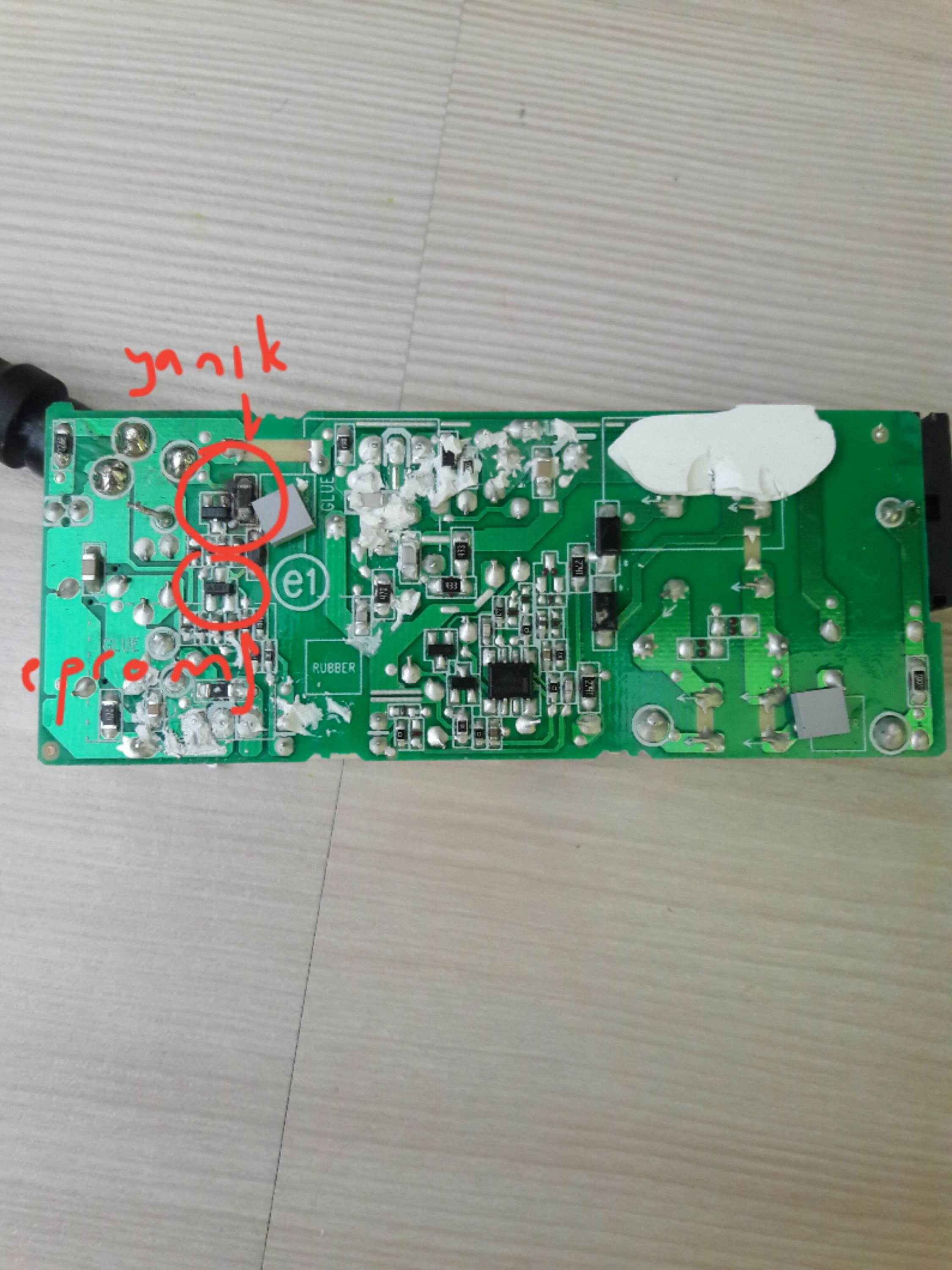

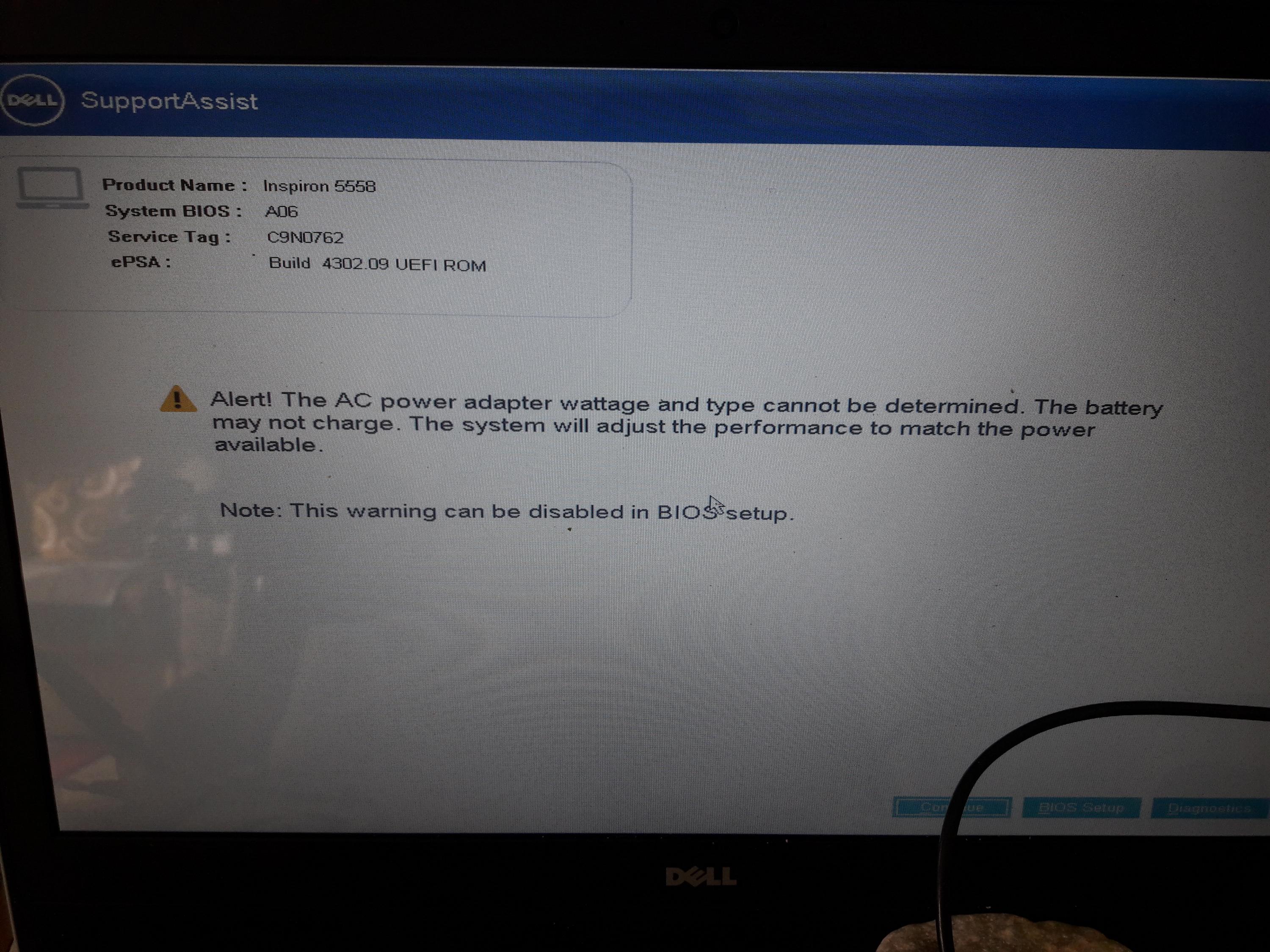

                              I met this problem .I found problem on ID pin's voltage of adaptor .ID pin or other name PSID_EC voltage must be 3.3v. Defective resistor can be 130 ohm.Charge is ok and there is no message on boot
                                Thats a different matter altogether. In my case psid_ec was ok at 3.3v.
