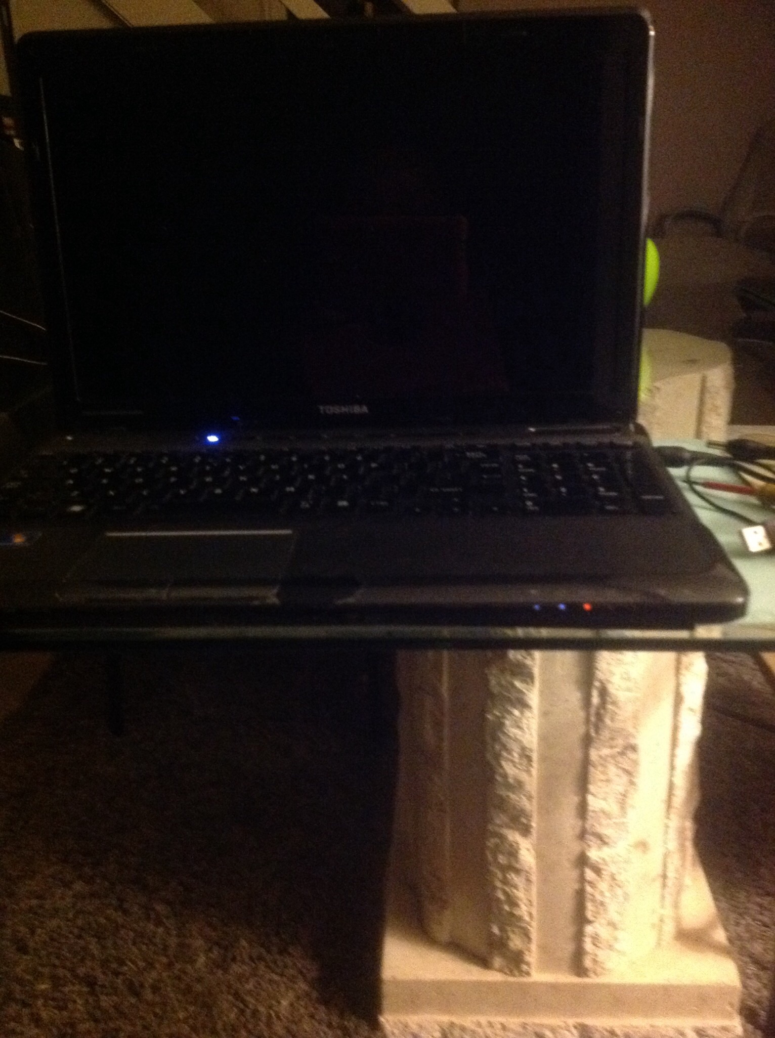

    Hi everybody
    Yesterday is my toshiba A665-14c fall out when my stepson was Watching movies on youtube.
    Now will the notebook not start up. I have only power light when i push the power button. The light wil go on from the power button. Battery light and powerplug light but no fa no hdd.
    What can I do to fix the nootbook. Is this hardware or a software problem.
    Please help me

            Re: Toshiba A665
            Hi bluemidnight
            Pictures with battery and whitout battery . With only battery no lights total dead then

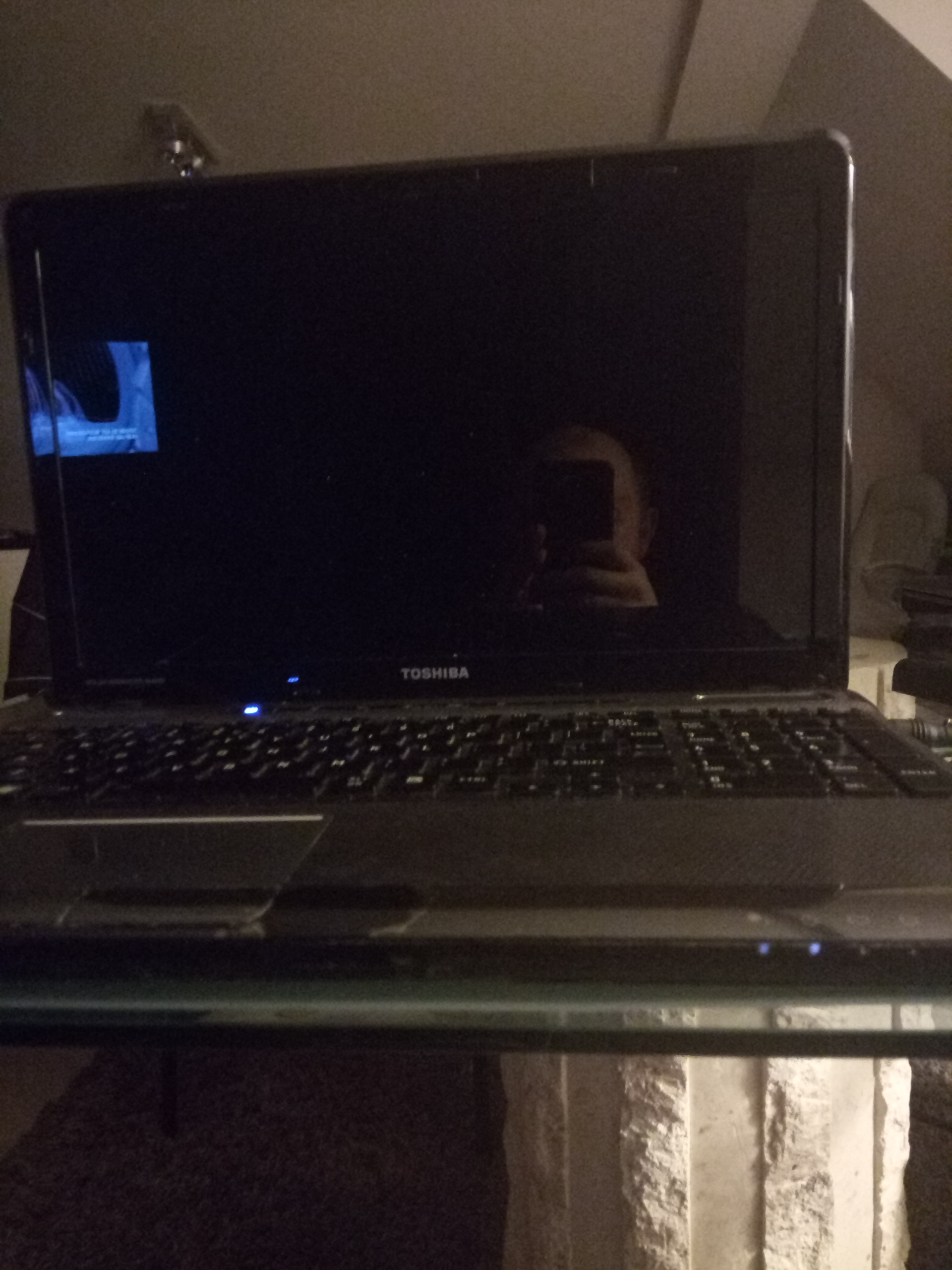

            • Stevedb
              Stevedb
              • Feb 2018
              • 624
              • Belgium
              Re: Toshiba A665
              The other picture

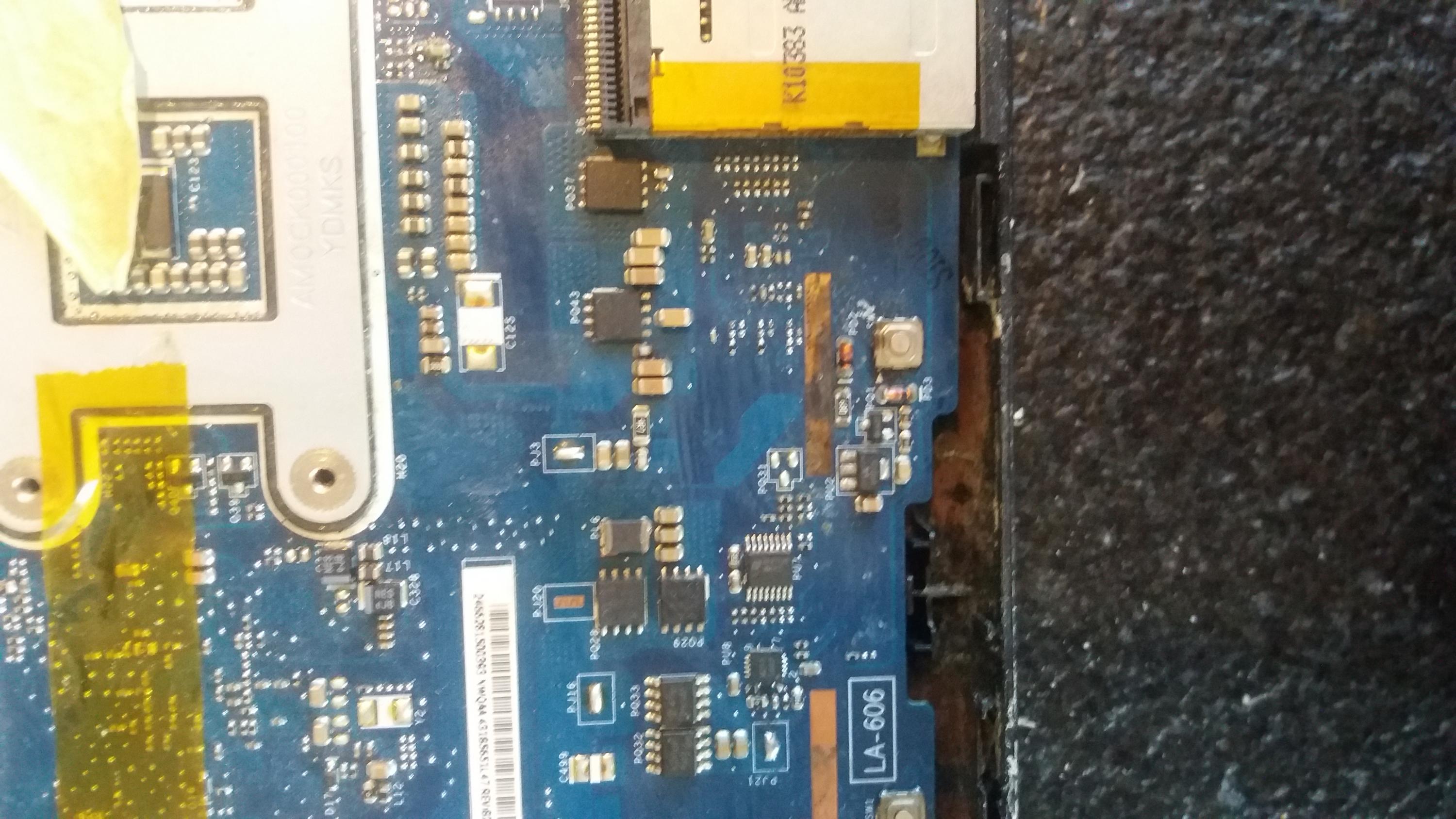

                      Re: Toshiba A665
                      Hi
                      I saw i got waterdamage on pu2 i removed waterdamage and musure on pu2 2,8 v
                      Bios battery 0,67. Battery and on pj5 0v and on pq8 pin1 8,6
                      The waterdame coms from my stepson salvita.
                      What is the next step. Please help or is the laptop not repairable.

                        0.67V is certainly too low for the battery. Is that 2.8V on pin 2 or pin 3 of PU2?
                        But all the other voltages are too low as well. So, let's just start at the beginning. When using AC power, what are the voltages on PQ7 and PQ8 (source, drain, and gate for each)?
                        • Stevedb
                          Stevedb
                          • Feb 2018
                          • 624
                          • Belgium
                          Re: Toshiba A665
                          Hi Bluemidnight
                          Thanks a lot for helping me again. I want be gratfull we can repair the laptop because that is only thing my stepson has. He is sitting in weelchair.
                          So I measure on pu 2 pin 1= 0v (ground) , pin 2 (4.32v) and pin 3( 2.16v)
                          Pq7 s(pin1) =19,54v g (pin 4)=8,32V en D=19,54v
                          Pq8 S=19,54V , G=8,32V en D=19,54v
                          I think G=8,32V
                          The bios battery is recharggeble must i order a new one?
                          Thank you for helping me.
                          Greetz steve
                          • BlueMidnight
                            • Jan 2015
                            • 489
                            Re: Toshiba A665
                            Okay, PQ7 and PQ8 are good. You originally wrote 8.6V on pin 1, but it was pin 4. So that's perfectly fine.
                            There is a problem at PU2 however. Pin 3 (the output) should be 3.3V. Pin 2 (the input) must be at least 6V for it to even work properly. In reality, this circuit will provide PU2 with a little less than either main battery voltage or AC adapter voltage (if plugged in).
                            Either PU2 is not being giving the right voltage, or it has an internal/external low-resistance path to ground.
                            So, next measure the pins on PQ1, PD2, and PD3. And make sure there isn't any more spill damage in that area.
