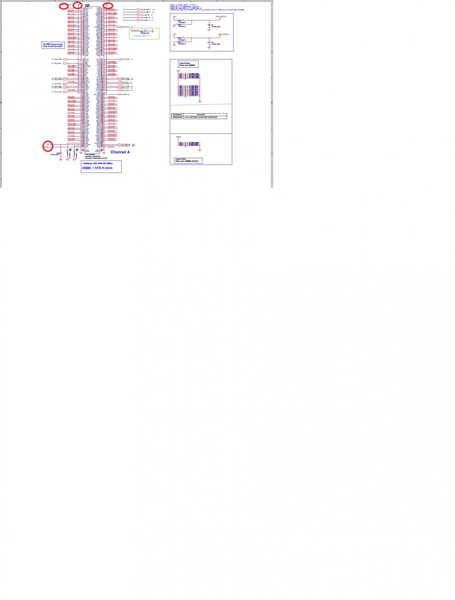

    Hello.
    i have Toshiba Satellite C50-b Motherboard LA-b303p rev 1.0
    Pressing the the power button the fan start to spins no stop....
    but no display at all
    i tried everything removing battery ,ram ,hdd but nothing changes
    tried a new ram but nothing
    tried flash bios and ec with new file nothing happen....
    please help me

        Re: Toshiba Satellite C50-b918 dead
        test
        PJW02
        PJW04
        PJ1103
        PJ1803
        +SOC VCC
        +SOC VNN
        • infoplus
          • Aug 2017
          • 83
          • ALGERIA
          Pjw02 ---- 1.35v
          pjw04----- 0.68v
          pj1103---- 1.0v
          pj1803---- 1.8v
          +soc vcc 0.72v
          +soc vnn 0.78v
          • Techtiger
            • Oct 2014
            • 1602
            • france
            did you try with a external Screen ?
            • infoplus
              • Aug 2017
              • 83
              • ALGERIA
              yes nothing ....
              • Techtiger
                • Oct 2014
                • 1602
                • france
                Also check the Ram slot for Voltage
                check PMC PLTRST
                If all power sequence is good you are having a Bios issue or a Dead SOC try to reflow the CPU
