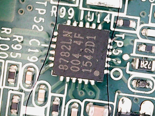

    Good day
    I'm looking for a schematic or info on the charging chip.
    Here is a photo as well.
    At the moment its not charging and not detecting the battery either though it works on the battery just fine. There are a bunch of other things wrong as well like the KB and TP not working.... It may be a semi faulty EC even... But as we all know it could be a few things... anyways after checking it for a while I saw the ID pin from the adapter has nothing on it so I'm now waiting for a new legit lenovo adapter.
    In the meantime a schematic or info on that chip would really be appreciated
    Thanks a million!

    Here is your charger datasheet extracted from a lenovo flex schematic.

      Re: Lenovo Yoga 300 - charging issue
      Is this the right motherboard schematic .
        Thanks guys you are amazing!
