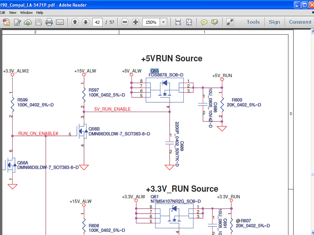

    Hy all tech friend , I have a dell laptop which problem is can not supply vs voltage. sometimes its display come, cpu fan spinning and sometimes not. Can any one help me

    Try with another, known good charger. Also check +5V_ALWP , and +3.3V_ALWP

      5V_ALWP , and +3.3V_ALWP are present.....but cannot pass on mosfet ......

        Check voltage on pin4(gate) of fets connected on vs lines. If gates are not opening you wont have vs voltage on the other side of mosfets. You need to check IC's connected with vs side of mosfet(mostly 3pin or 6 pin ic's). You can try by removing the mosfet and check gate voltage of fets. Sometimes the fet itself is defective though it will show normal rating while measured in diode mode.
