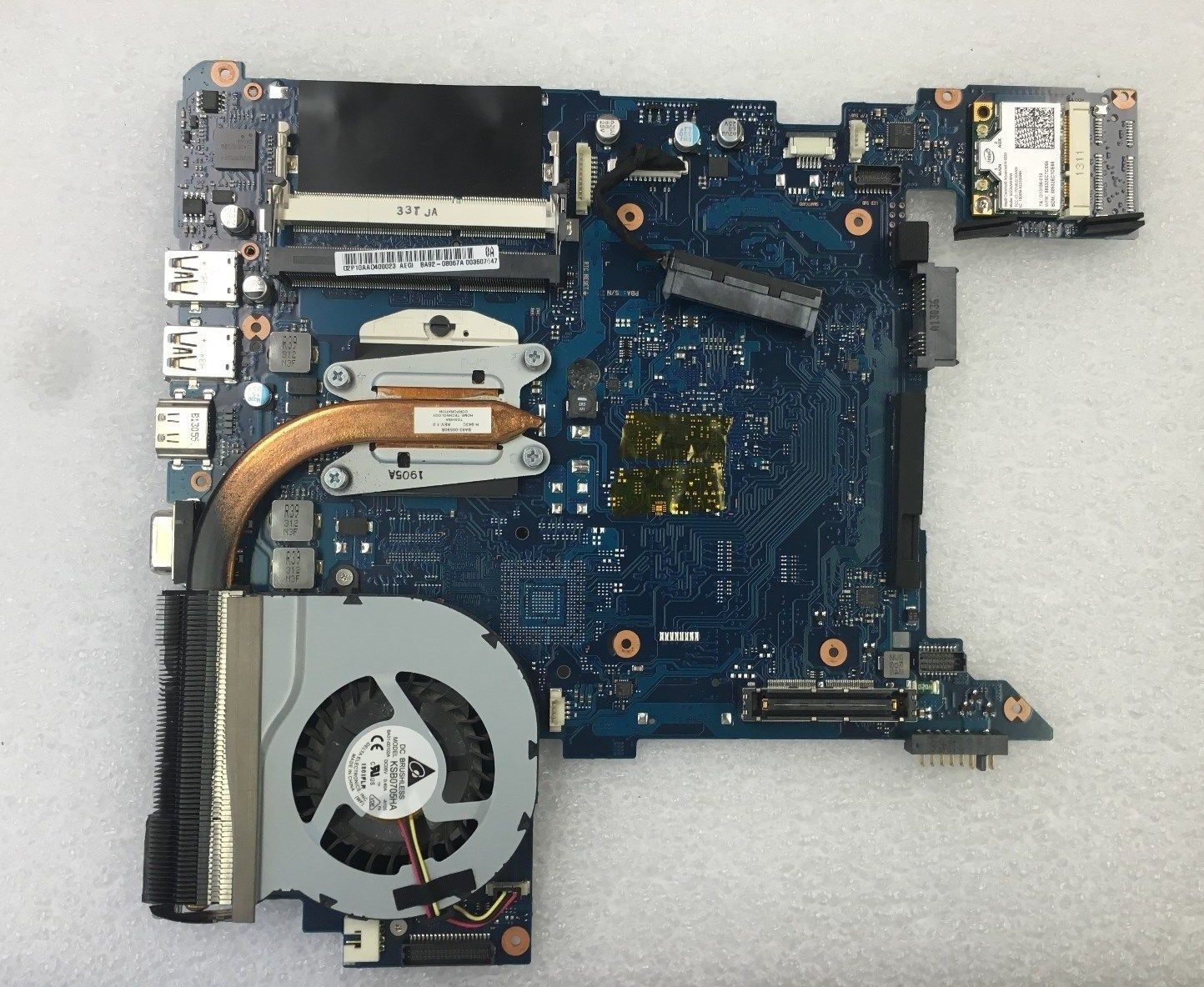

    i have this motherboard :
    Samsung NP600B4
    BA41-01794A
    is dead, nothings

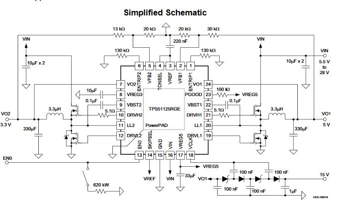

    i checked board and found TPS51125 chip ,not normal
    this chip have two regulate voltage :
    VREG3 & VREG5
    VREG3= 7.2 VOLT
    i changed this chip but without success
    someone can help me ?
    i dont have schematic and boardview

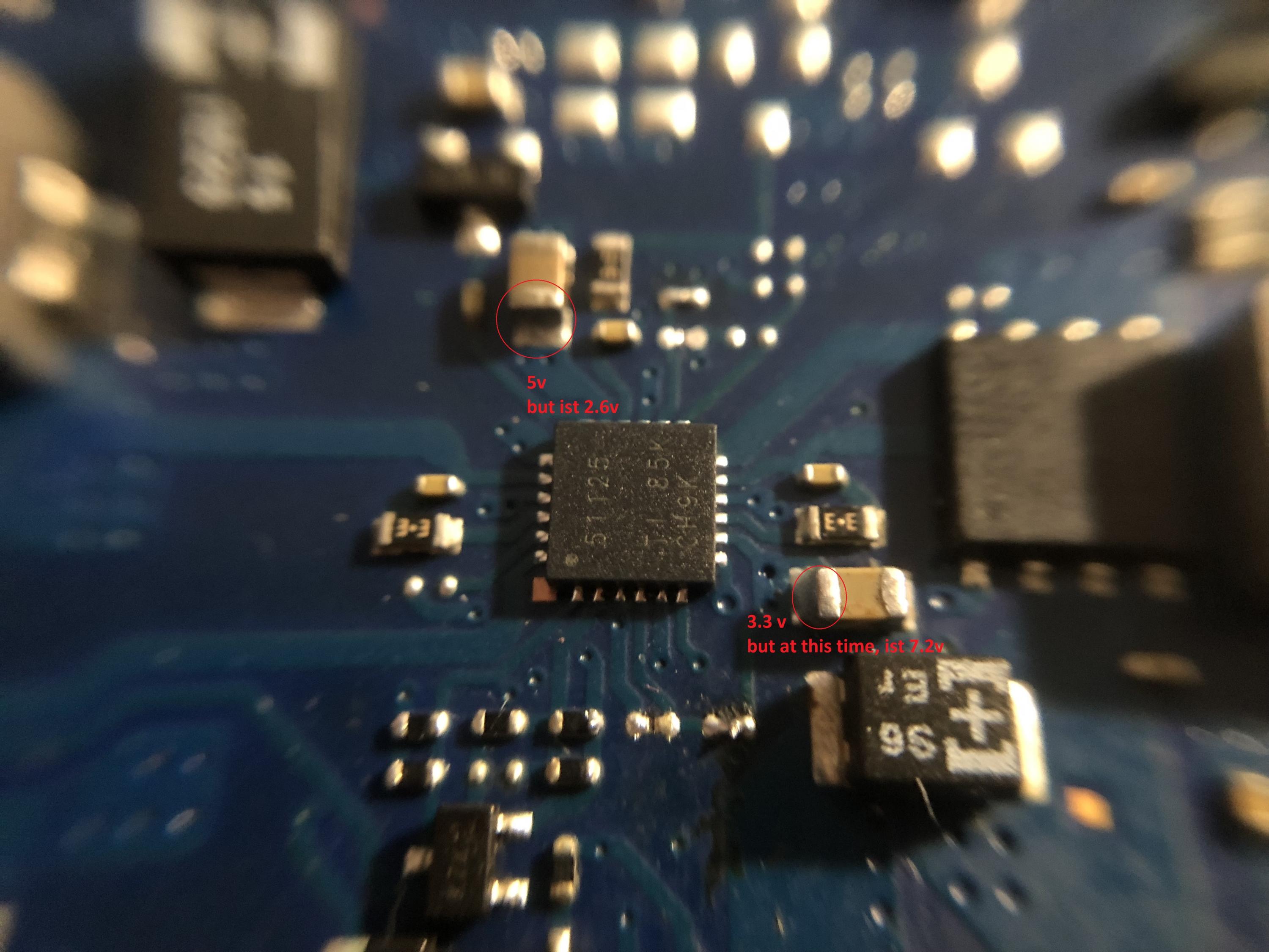

      Measure voltages on pin 8 and 17 and send
      • kokono
        • Jun 2018
        • 203
        Re: Samsung NP600B4 dead
        you can see in image
        pin 8 = 7.2v
        pin 17= 2.6v
        • mcplslg123
          • Jun 2015
          • 7262
          • india
          Vreg3 should be 3v,cant be 7.2. I doubt your measurement. Please recheck and measure.
          • kokono
            • Jun 2018
            • 203
            friend
            i replaced one time this chip(TPS51125)
            dont change
            i know, Vreg should have 3.3v
            but at this time is 7.2 v

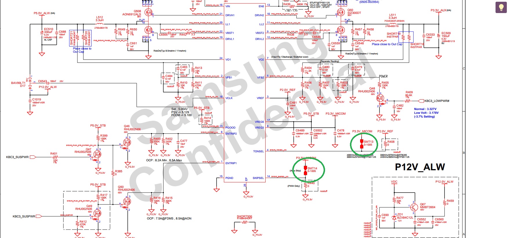

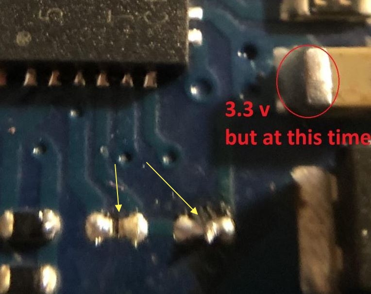

                  Whats with the solder blob,should`nt there be a resistor there. Pin 3 is the voltage reference.
                  https://cdn.badcaps-static.com/pdfs/...c3b552ae45.pdf
                  • kokono
                    • Jun 2018
                    • 203
                    no, ist jumper
                    • kokono
                      • Jun 2018
                      • 203
                      pin3 ist p2.0V_REF but at this time ist 3.4V
                        • 20674
                        3.4V is ok, on your schematic its needed for the micom .SMSC
