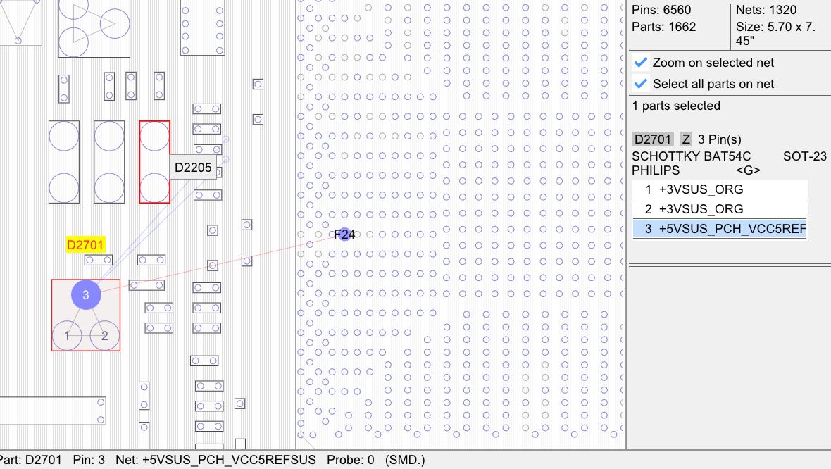

    Originally posted by SMDFlea
    Just uploading a picture of openboardview in use ,so you can see the difference between it and boardviewer.
    so the image you posted,it don't show any connections to the intel chip.
    but when i use boardview it shows connections to 1 pin of the intel chip
    here is the focused transistor am intersted to find short.
    the connected parts means how many components is connected to this line.
    look up this part on your boardviewer and se and compare it and look close their is 1 pin on intel chip connected to that transistor.
    i hear on video from a tech that half short means part of a section is shorted.
    full short is all over.
    i think this board has had beating.

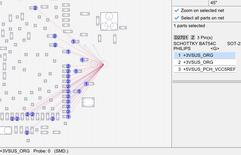

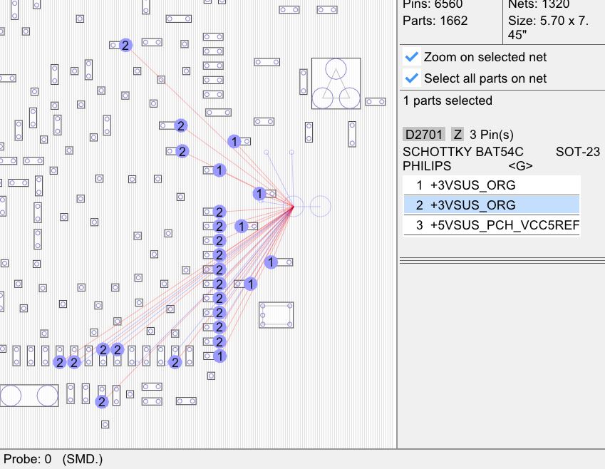

      Re: Asus k52f short
      QUOTE: "so the image you posted,it don't show any connections to the intel chip.
      but when i use boardview it shows connections to 1 pin of the intel chip"
      I know that,as i said it was only to show the difference between boardviewer and openboardview. So...... i`ll post some more pictures of D2701 pins 1,2,3 , using OpenBoardView.
      Test resistance to ground on each pin, and post your results here .

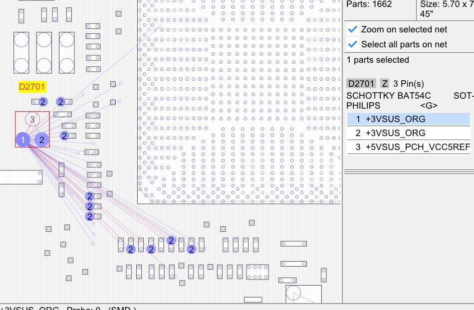

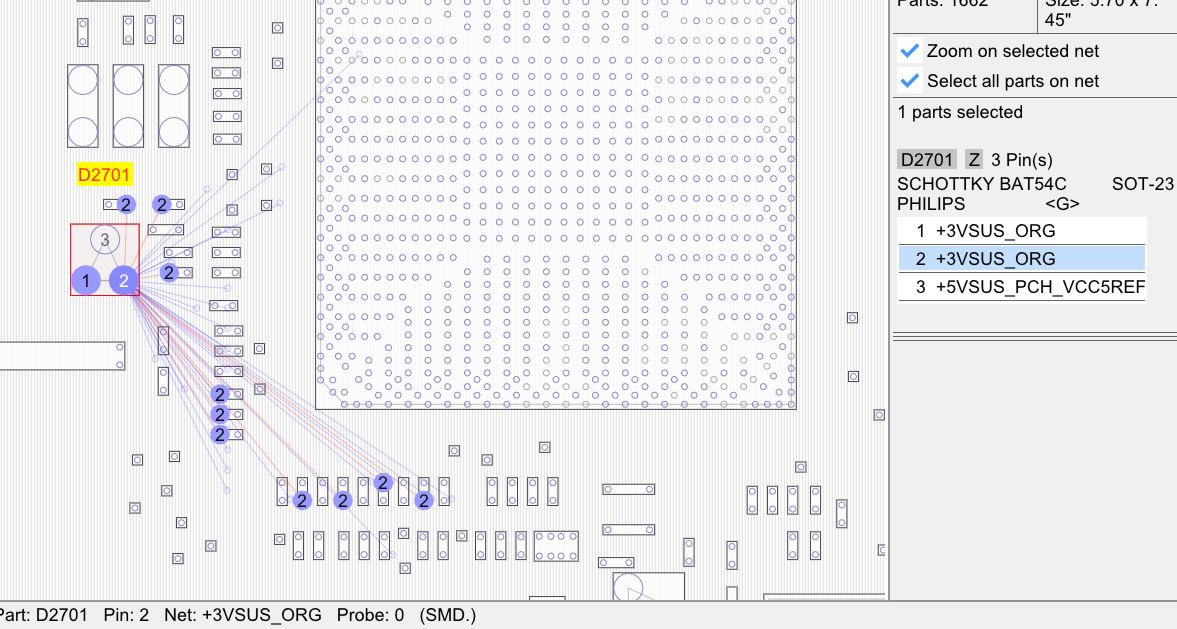

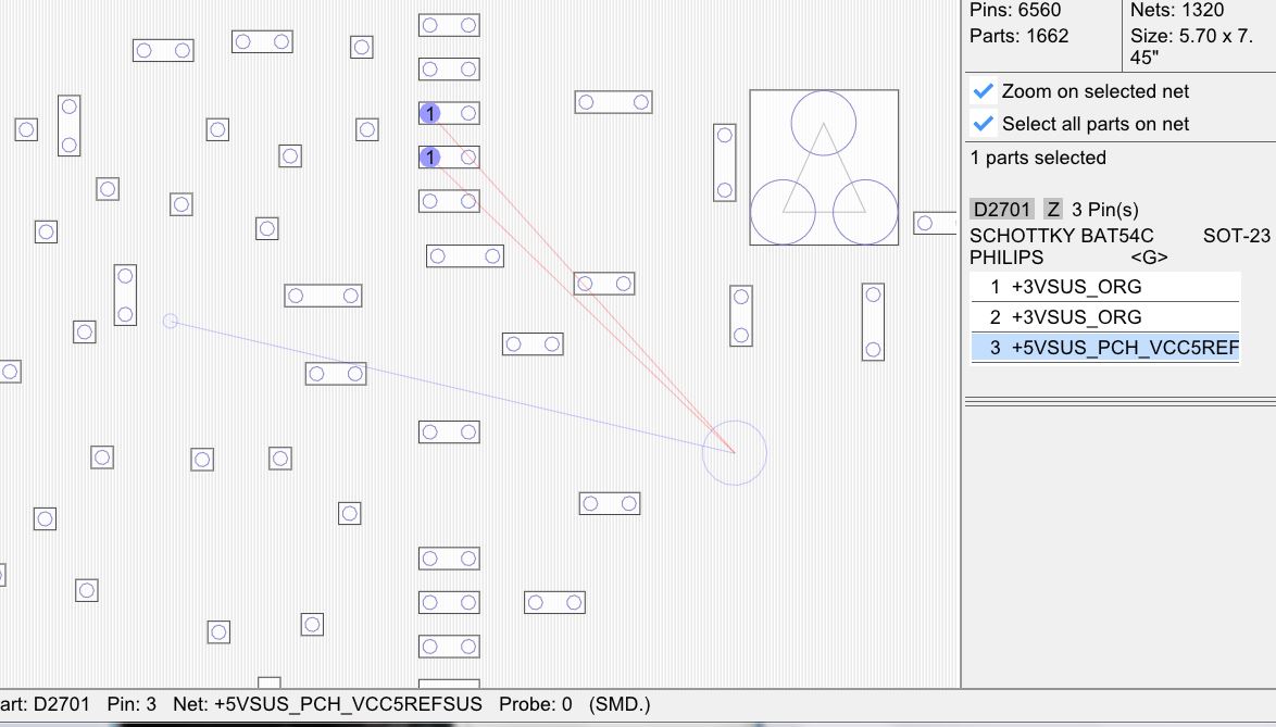

                Re: Asus k52f short
                RES 10K OHM 1/16W (0402) 5% TA-I/RM04JTN103
                most of them are 10k ohm and 200ohm
                they are either no buzz or no reading from them or buzz with probe to gnd both sides.
                look at the one on the right its missing.
                i noticed few missing in most areas and i ignored them as i thought its normal according to shem or boardview.
                i did a quick test of few of them their are no beeps
                i will update you with reading and non reading or with gnd
                i will try and make accurate reading with picture so its easy for u

                  Re: Asus k52f short
                  am 100% certain its u2001 ic.
                  their are other pin that connected to hdmi port are shorted and i kind of traced and seen that they also have 1 pin connected to that u2001 ic.
                  this board is a toy so is it ok for me to run a reflow test on it lol using heat gun.
                  its my first time so dont mind trying it out but can you tell me what way i should do it,should i add flux.
