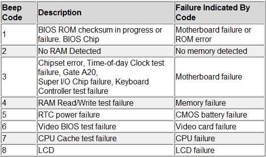

    Hi friends, I have dell inspiron 1564 DA0UM3MB8E0 REV:E REV:A00 PWB:5X2FJ UM6.the problem when plugged in and press power button turns on with 6beeps then followed by 5beeps then fan spins but no display.Anyone can help on this please

    Check the cmos battery voltage , take the hard drive out and see if it powers on. Try different memory . If none works it could be a bad gpu.

      thanks for the response i already done that replaced ram, replaced cmos battery but still the same issue, my mistake the model dell inspiron 1464 I3 CPu with no dedicated graphics

            Try check out this chart.. Maybe can help you.. TQ

              I reflowed the ATI chip the issue was gone and laptop boots fine, it's graphic issue.does anyone help me how to convert this from dis to uma or disable this ati chip?Please help

                      Dell inspiron 1464/1564 cannot be convrerted from dis to uma-100% sure. So dont waste your time-either change the graphics chip or look for a new mb.
