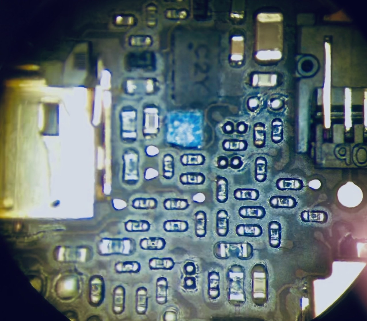

        Re: 820-00045-A NO Display
        I have 820-00045 no backlight ? 4 legs cristal node by the screen connecter broken no backlight don't have donner board is there a jump solution for now ?
          What voltage you get at the backlight FUSE?
