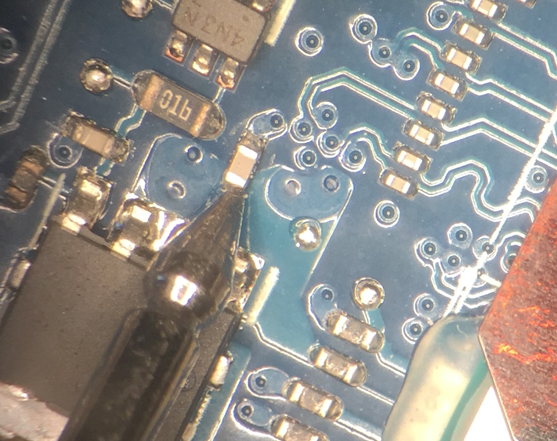

    I've searched the forum for this model and couldn't find anything.
    Please could someone look at the attachment and advise if this is indeed a capacitor as I suspect.
    I suspect it to be a capacitor and I have probed for continuity between ground and both sides of the cap and I get a constant beep on both.
    My questions:-
    1. If it is a capacitor then it should only beep momentarily and start charging right? This is the case with similar looking SMD components around it.
    2. If it is failed, how would I go about finding a value to replace it?
    Regards,
    MATT

    you have to measure in ohms to see if a capacitor is shorted or not. If you get 0 ohms there is a net short, then desolder it and try it out of the pcb. If, on the other hand, the measurement is a few ohms and not in a short net, it may be that the capacitor is in series to a circuit with strong currents such as the line feeding the cpu or gpu.
    A condenser if it beep for a few seconds and then stops means that it is charging or a parallel capacitor in parallel with large capacities that are being jammed. Desolder from the circuit and try it.
    For replace you need a schematic for find info.
    You can try without capacitor temporarily
    • diif
      • Feb 2014
      • 6978
      • England
      Re: Asus GL502VT - faulty capacitor?
      Depends where on the laptop it is then an educated guess can be made.
      25V 1uf or 10uf if it's on the 19v rail.
