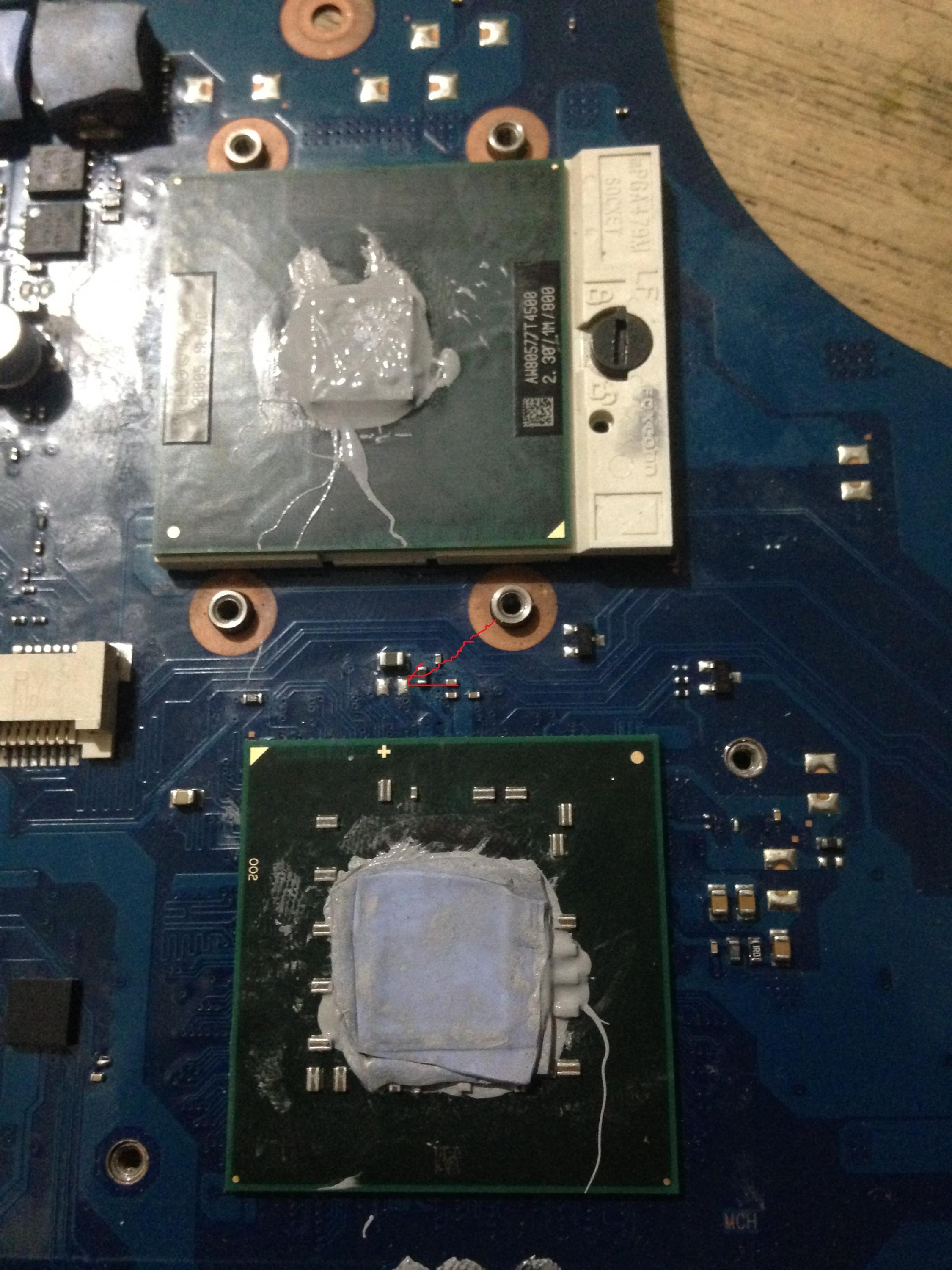

                              i have attached the image on the CPU and MCH,When i tried to reformat the laptop its stuck at 18percent then shuts off. I noticed there is a slot for another power supply ceramic caps could i try to add another ceramic caps on the one marked red?
                              • caspian
                                • Oct 2015
                                • 1589
                                • Laptop
                                Re: Samsung RV510 shuts off 5 to 8 minutes
                                If there was no capacitor there, there is no need to add one. Does any IC get hot near the CPU and the MCH?

                                    So, how about temperatures?
                                    Does it shutdown even in the bios page? If you restart it immediately after a shutdown does it work for another 5-8mins?

                                      even on the bios page it shuts off it it restart it does not work for 5-8mins. the hot component only is the MCH and this intel chip IntelĀ® 82801IBM
                                        and now it shuts off 1 minute. does this MCH is the problem?
