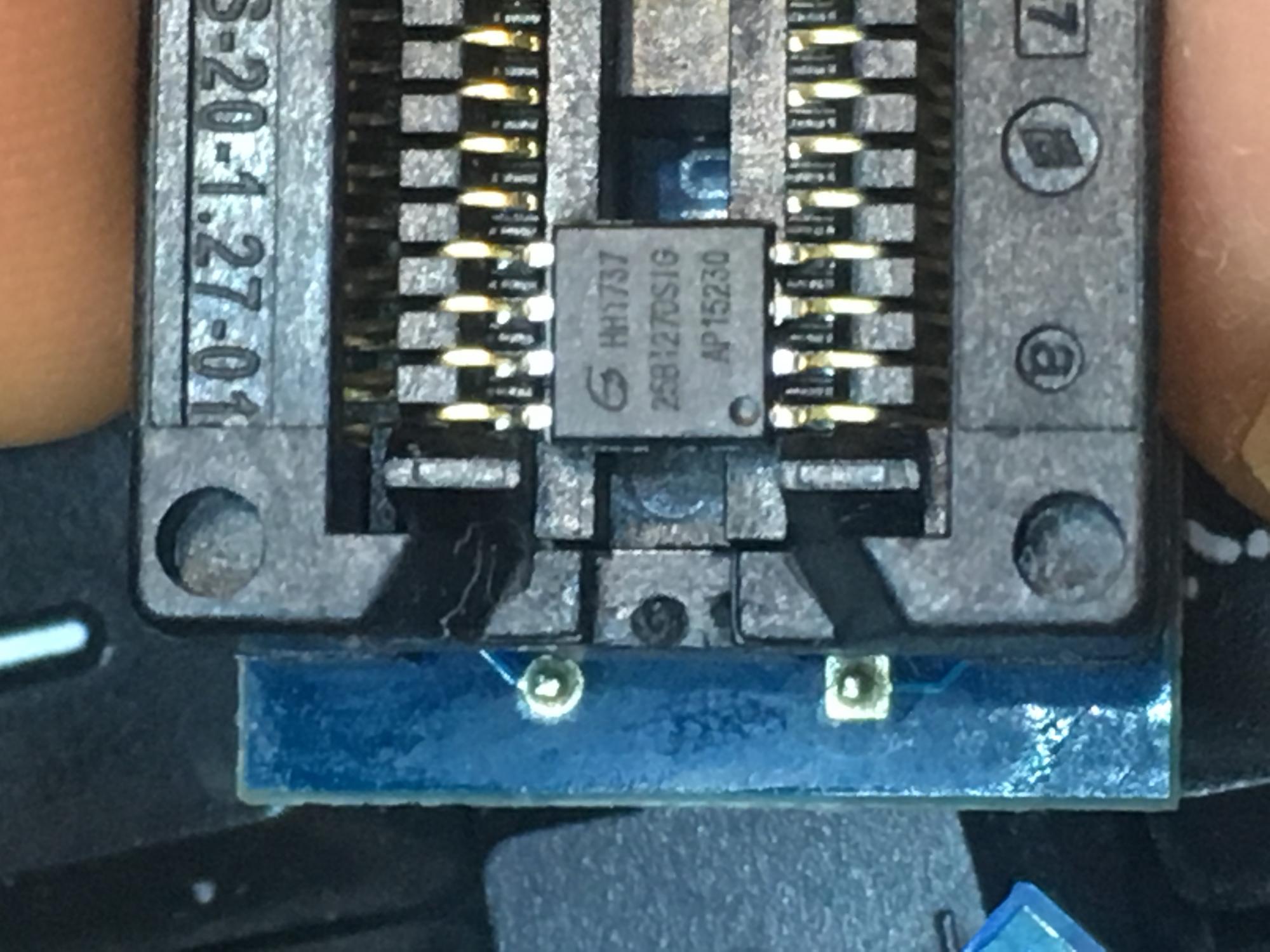

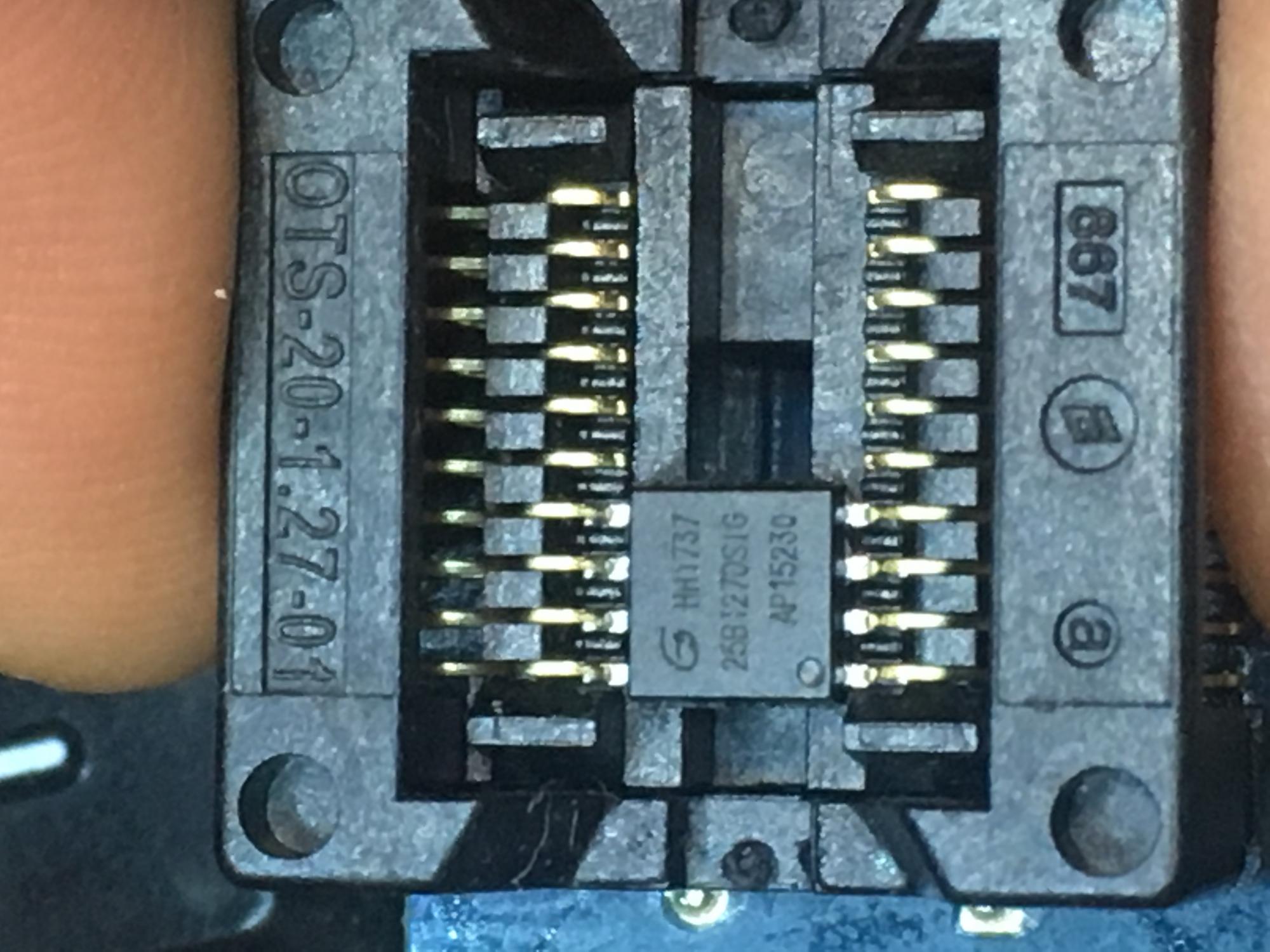

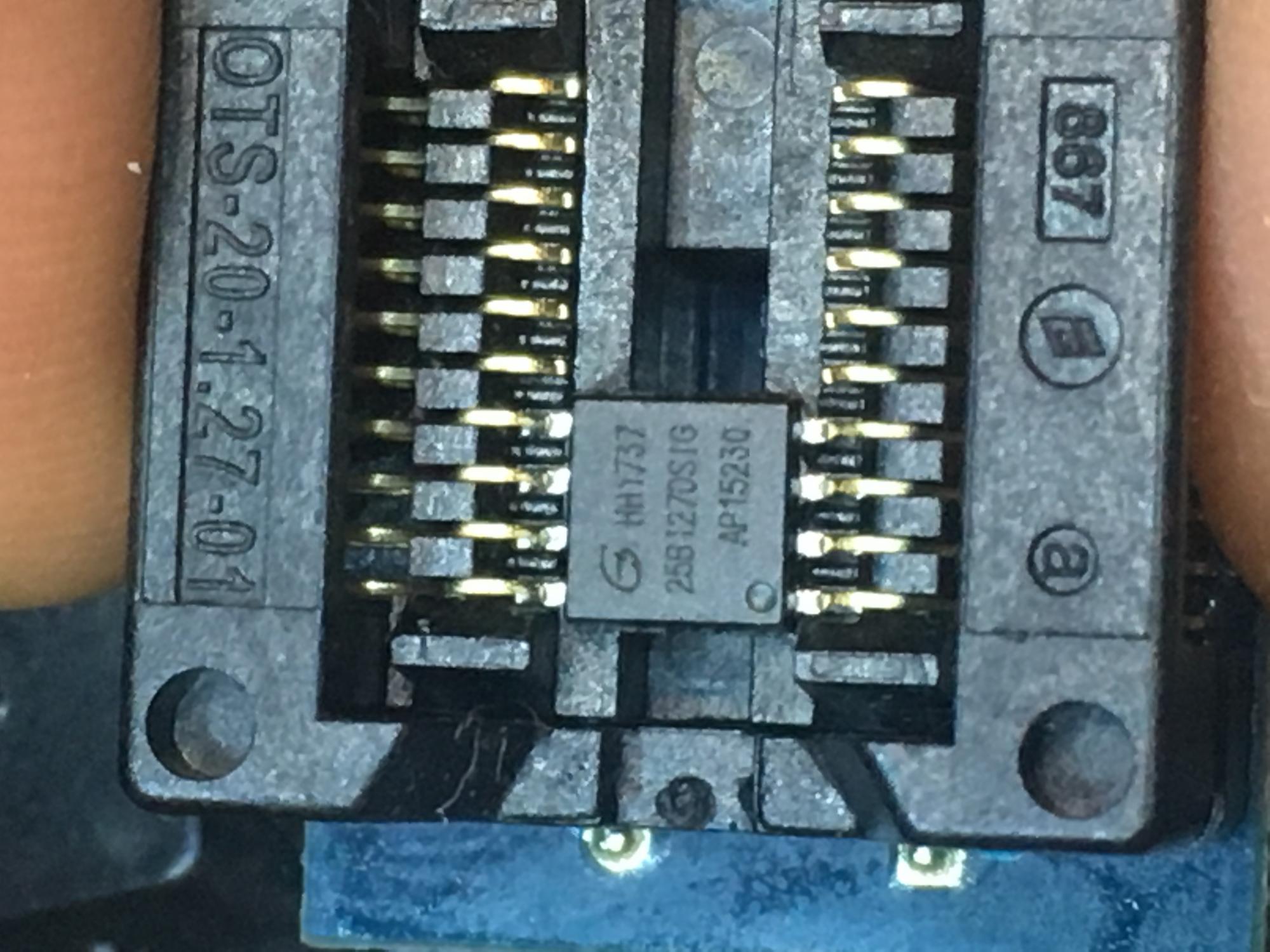

    Hello
    Can any one help me to identify this chip please it's 16mb but can't read it with my tl866a programmer
    Re: Chip eeprom not identified
    Eeprom identified thank you .
      Make both firmware and hardware update then try. If still has the problem then try RT809f.
        that is giga device bios
          Its nor 16mb its 2 mb bios.........foulu0238 you divided the bios ic by 8, any kind of number. example windbound 25q32f 32/8 = 4 mb , 25q64f 64/8= 8 mb................
