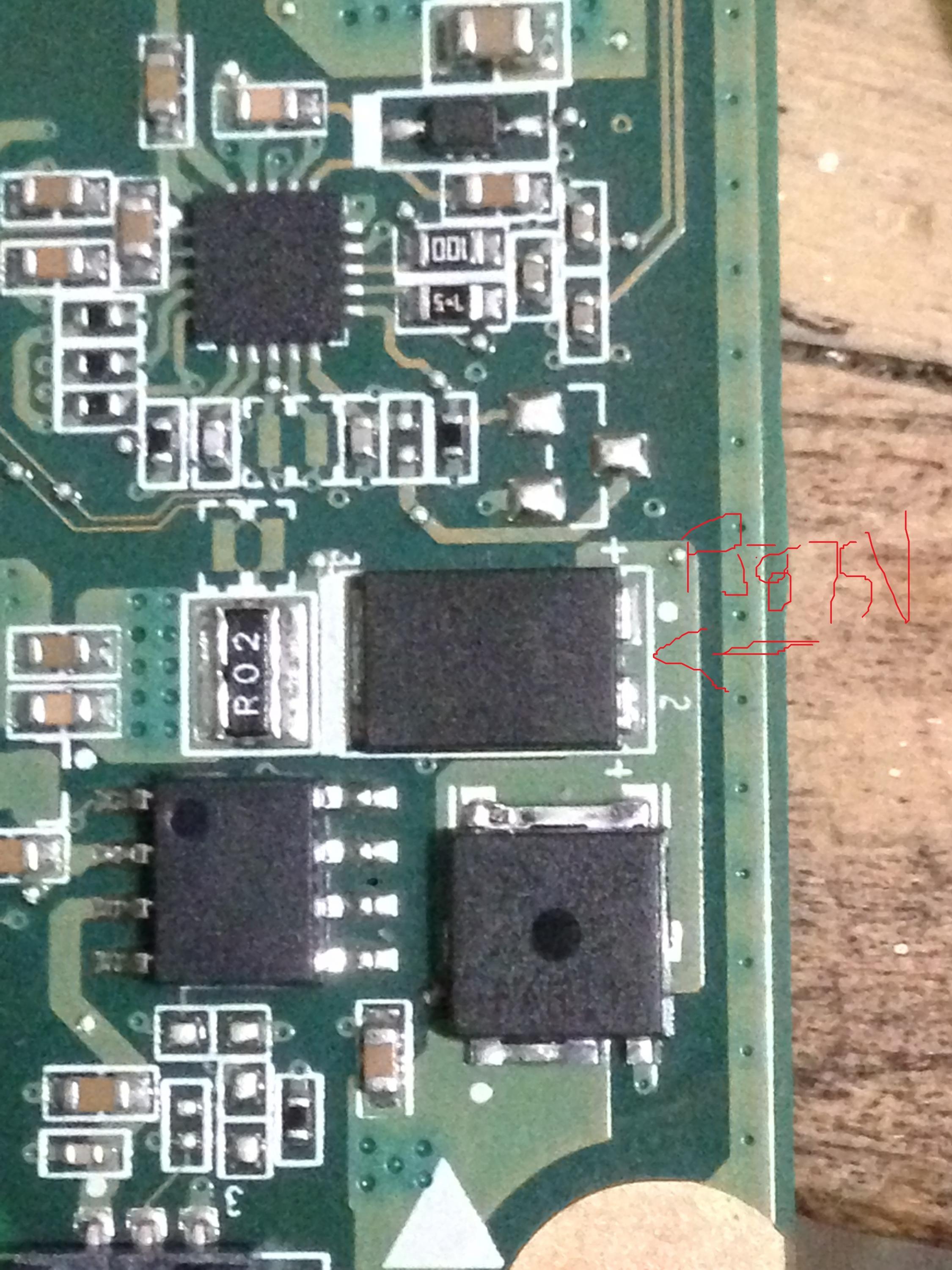

    Does anyone know what type of mosfet is this?I cannot find the same is there any replacement for this type?It has marking PJ587SV 1040 the board id for this motherboard Z8AD DAZ8ADMB6D0 REV.D

      thank you meritosari, so this is rectifier diode i have problem finding the same on scrapboard.Is there a chance that other replacement for this or a chance to bypass or bridge this?please help

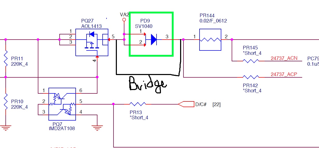

        Yes you can bridge and it will works perfectly( I did that many times), but be sure that there is no short after this component , see attached picture.

          thank you but where should i connect the wire form aol1413 mosfet pin 5 going to?please can show me please

            problem solved found shorted ceramic caps replaced it and now working fine
