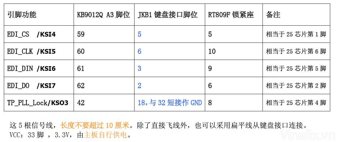

    Somebody please let me know what is ICSP Adapter provided with rt809f. How and in which condition I need this adapter.
    I have also KB9012 adapter included, I solder KB9012 but it can't be identified by programmer. Also it can't be identified even I select it from the drop down list.
    Last I want to ask is it similar way to reprogram KB9022 as we do for KB9012?

    it is better you solder the kb9012 chip in mother board and then connect rt809f through keyboard as per attachment example.
    note... pin 42 of kb9012 must be ground with mb and rt809f.
    you can program kb9010 ,9012,9016,9022 through rt809f.

      i know how to reprogram KB9012, and I have always having trouble to reprogram KB9022. Also I want to know what is ICSP adapter and how to use KB9012 adapter.
