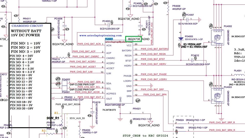

    Hy friends any one have tps 51125a,51123,
    rt 8223,
    good power ic operating voltage......
    I attach a example picture.......
    Thanks in advance........
