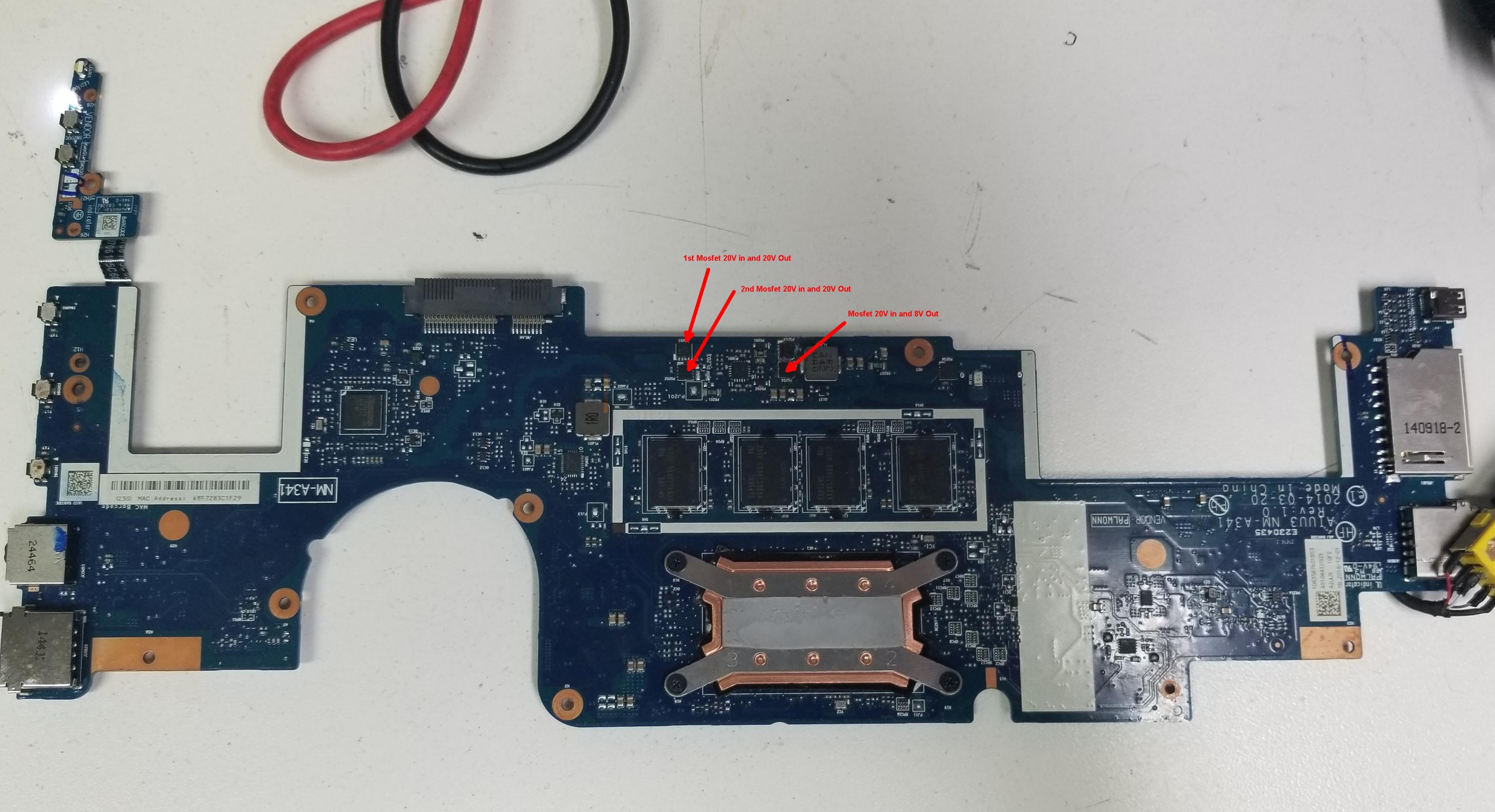

    I have a Lenovo Yoga 2 11 When i connect ac adapter i see the white light on solid and Orange light blinking. No display. If i press power button no change. I checked the 19-20V Power rail and at the output of 2nd mosfet i get 8V. Is this normal? I check all over the board and see the 1.5v, 3V and 5V rails but what i would think would be the 19V rail i get 7 to 8V. I attached a pic of the motherboard.

    What to do you mean by output of 2nd mosfet?? If you are getting 8v at 4th pin(gate) and 19v on pin1-3 /pin5-8, thats ok.

      i get 8v on pins 1-3

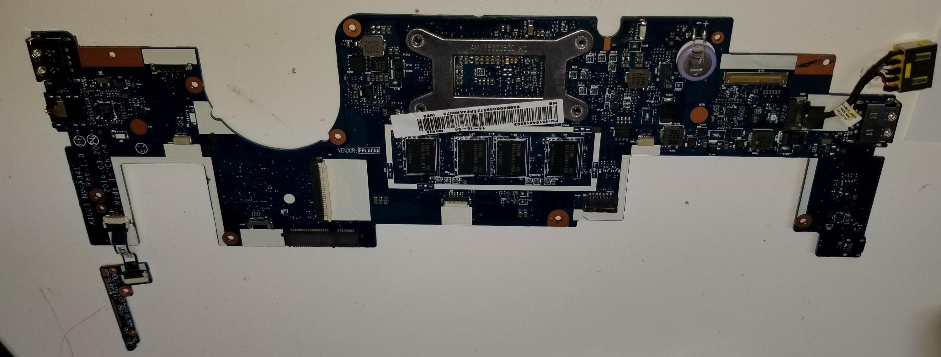

        im sorry i messed up. I attached a pic with the voltage readings. You will see powersupply that outputs 8V. i dont get 20v anywhere else on the motherboard. only 8v 5v 3v and 1.5v. My question is, is this normal to have 8V for the rest of the board? I dont know what else to check to see why its not booting up.

          Re: Lenovo Yoga 2 11 Motherboard Voltage Readings
          That seems to be ok. Disconnect cmos battery for atleast 24 hours(dont power during those 24 hrs) and see if it makes any difference. Recently had a similar hp DAG31 MOBOwith similar symptoms and it worked after long cmos reset. No harm in trying. I have observed result in lemovo G560 mobo also after long cmos reset.
