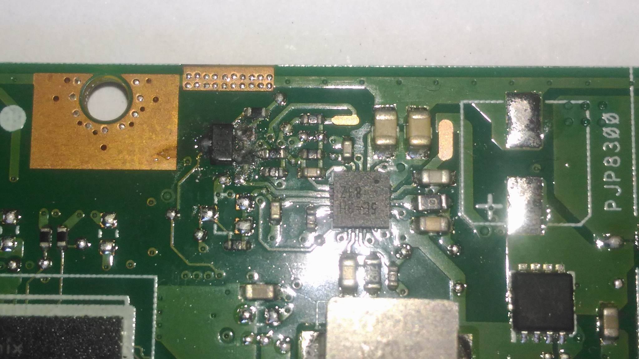

Hello good day! I have this ASUS X455L that wont turn on and even if i plug the power adapter it wont charge and the charging light indicator wont lit... i've done initial troubleshooting i found out that there is smd component marked 43t shorted but when i pull out it was ok, and there is 20 pin smd component beside it marked 5E=3H which im not sure what type of component it is and i suspected it to be shorted since some of its pins tested shorted. by the way can somebody share a schematic to me... thanks

5E= is Richtek RT8248A, which should be used for the RAM power supply so that's not your issue. Your issue seems to be related to charging circuit, most likely the DC-in MOSFET (there are probably 2 of them near the DC-in connector) which can be shorted or a defective charger IC (around this area too). You could have a shorted B+ line too, you can check that by measuring the resistance to ground after the DC-in MOSFETs.OpenBoardView — https://github.com/OpenBoardView/OpenBoardView -

i measured the resistance to ground after the DC mosfets it measured 2 ohms, is it normal for this model?5E= is Richtek RT8248A, which should be used for the RAM power supply so that's not your issue. Your issue seems to be related to charging circuit, most likely the DC-in MOSFET (there are probably 2 of them near the DC-in connector) which can be shorted or a defective charger IC (around this area too). You could have a shorted B+ line too, you can check that by measuring the resistance to ground after the DC-in MOSFETs.Comment

If you're measuring after the DC-in MOSFET (*not* the CPU ones) then 2 ohms is way too low, you should have at least several kohms. It means the B+ line is shorted. Inject 1V using a lab power supply and check which component gets hot. If the CPU/PCH/GPU don't get hot and nothing else get hot, you can increase the voltage a little.OpenBoardView — https://github.com/OpenBoardView/OpenBoardViewComment

i did what you advised me to do, i used my lab power supply and increase the voltage and current little by little until it reaches 19V 2A and found out that one of the internal RAM chip is getting significantly hot...If you're measuring after the DC-in MOSFET (*not* the CPU ones) then 2 ohms is way too low, you should have at least several kohms. It means the B+ line is shorted. Inject 1V using a lab power supply and check which component gets hot. If the CPU/PCH/GPU don't get hot and nothing else get hot, you can increase the voltage a little.Comment

Sorry my mistake, the RAM power supply circuit is indeed related to your issue.

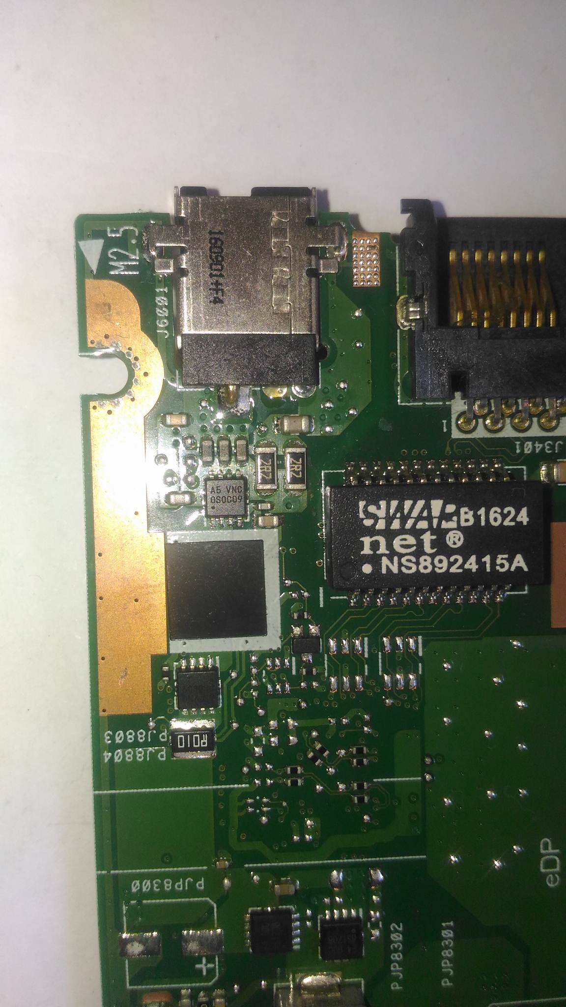

What's the resistance between the current sense resistor marked R010 on the first picture and the big coil on the bottom of your 2nd picture?OpenBoardView — https://github.com/OpenBoardView/OpenBoardViewComment

i measured it 1.5 ohm only... i try to removed that 5E=3H ic since i suspected it to be shorted but still there is that short...Comment
