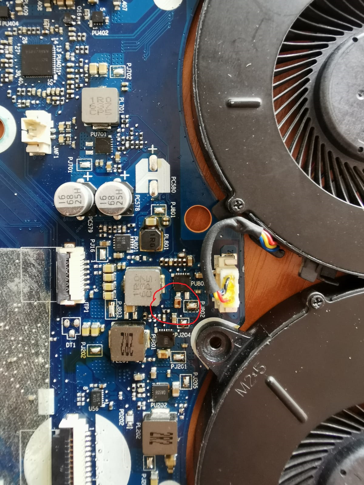

    Hi.
    I have a dead Lenovo Y700 MB: BY511 NM-A541.
    When connected to the AC adapter IC's PU802 and PU201, as well as coils PL802 and PL201, are getting really hot, really fast. Any caps that are close to those elements seem to be good (not shorting to ground). After desoldering PU802 and PJ 802, PU201 still gets really hot.
    As far as i know, there were problems with Touchpad and USB power before laptop went completly dead.
    I have access to bench power supply if needed.
    Thanks for any help.

    What's the resistance to ground on PL201?

      PL201 is 0.6ohm to ground.

        Ok, full short to ground. You may have a shorted PCH.
        Desolder PJ202. Check the resistance to ground on both pads. Inject 1V on the shorted side (should be pin 1 on the schematics), and check which component gets hot, probably the PCH.

          Yes after desoldering PJ202 and applying 1V, board draws 3.6A and PCH is getting hot. Will replacing PCH solve my problem or should i just replace whole board?

            If you have a BGA rework station, first remove the PCH and check if the short is gone, check the various voltage going to the PCH (especially +1.0VALW and +3VALW since they are the one shorted) and if everything is fine you can solder a new PCH. If you're lucky that's the only issue.
            If you don't have a BGA rework station, just replace the whole board.

              Thank you very much for your help. Looks like i'll be replacing whole board.
