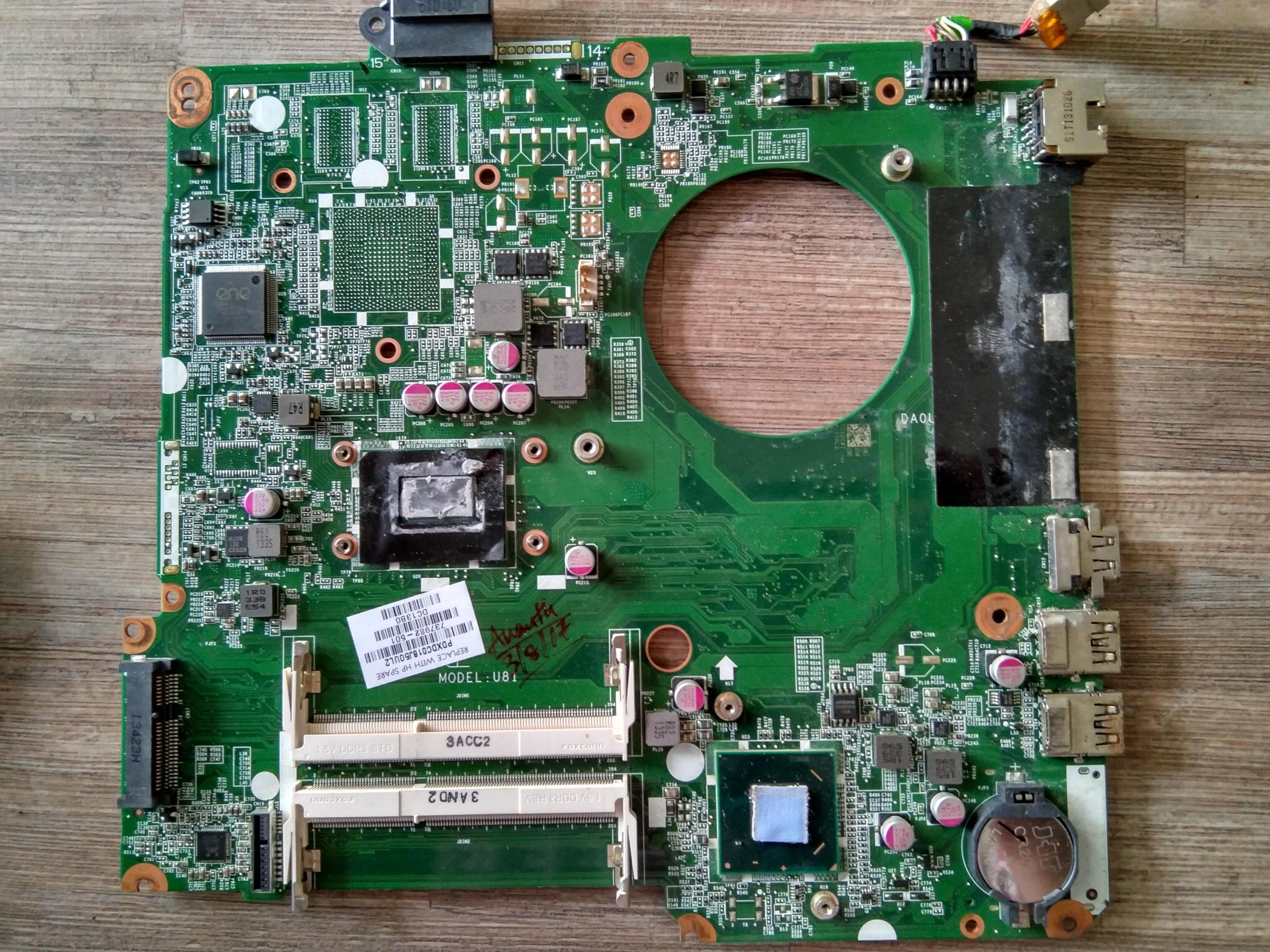

    Hp 15n da0u81mb6c0 laptop no display
    Dear Friends
    am having hp 15N with DA0U81MB6C0 motherboard which is not working.
    Laptop is powering on and fans are running. but no display,
    please tell me the voltage points to check and troubleshoot
    Thank you

    Re: Hp 15n da0u81mb6c0 laptop no display
    Check voltages on Coils ( Gray square components ) around CPU.
      Yes
      PL13-1.1v
      PL14- No voltage
        I suspect PU4 or PU3 or both. So check voltages according with Schematic.
                        check whether its a 1.8v chip. If so, you will require 1.8v adapter
                            Same problem to me also.Both bios flashed.but no vcore coming.1 caps lock blinking
                              Missing S0 rail and/or ALL_SYS_PWRGD maybe.
                                Hi, Same board,DA0U81MB6C0 with graphic -no display.
                                Found U24 Audio and U9 Lan chip heating removed both , but still no display.
                                U23 Intel seems heating bit more along with heat-sink around 50-55 max. Should i replace intel.
                                power at coils seems normal.PL13 1.1volt .no 0 volt at PL14.
                                Looking for bios with graphics. felt webcam also heating.
                                Please Guide me.
                                  Very likely a shorted pch on usb section. check reistance on D+/D- on usb port.
                                      Cheaked D+/D- showing 5.5 to 5.9 Meg-ohms .
                                        Audio/Lan/Webcam -all controlled by PCH. So i doubt some damage to PCH itself. USB resistance is fine though. PIN3 of PU4?? Disconnect webcam and try to boot. Is there display?
