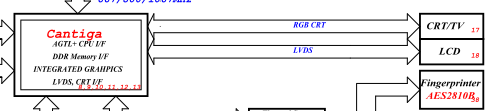

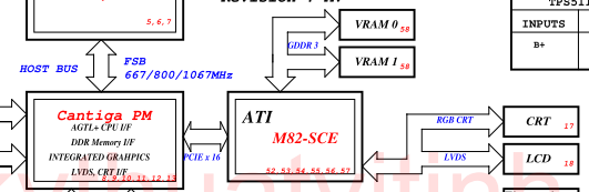

        Re: dis to uma conversion
        There are two versions of this motherboard , WISTRON KARIA DIScret & WISTRON KARIA UMA .
        IF your motherboard is P 40/45 north bridge, then you need to change it to G45 ...
        Find the scheme WISTRON KARIA DISCRETE and in the search for PDF VIEWER write the UMA
        The BIOS also needs to be changed
          Look at the pictures of difference
          I have both schemes, if required, I can upload here
                  WHICH NORTHERN BRIDGE IS WORTH?
                  Wistron_Karia_Dis
                  Wistron_Karia_UMA
