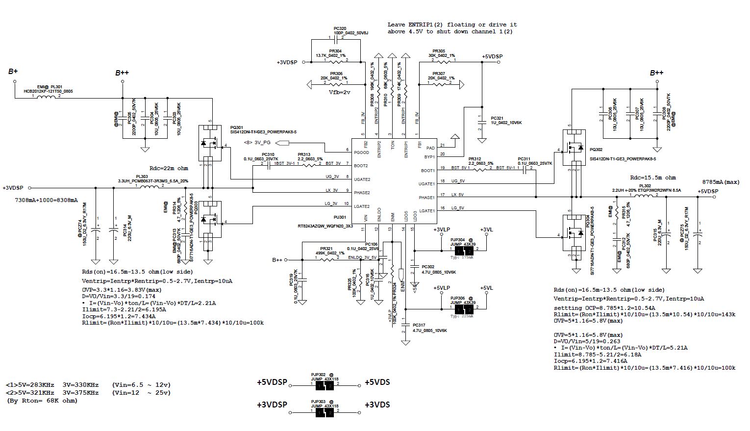

    While diagnosing the Power Supply controller in the picture shown, I may have shorted the 5VDSP at pin 1 and ENTRIP at pin 2. Since then, I no longer have an orange LED when plugging in the adapter. I now have a white LED which continuously flashes and the Power Button LED comes on without even pressing the button and stays on.
    Pin1 of this controller shown in the image is now at 2v and RSMRST at the SIO is no longer present.
    At the top of the page it says " Leave Entrip1 floating or drive it above 4.5v to shut down channel 1". I assume that is what I did, shut down channel 1.
    My questions are:
    What is channel 1?!
    What does it mean to 'shut down' a channel?
    Is there any way to reverse this?
    How come I get 5v at the coil at PL302, (+5VDSP towards the right), yet I only have 2V at pin 1 which should be coming from the same source, if i'm right on that?
    Any help would be much appreciated!
    Thank you

    a channel is an internal section of the IC that generates a specific voltage such as 3.3v or 5v.
    the shutdown occurs if a permanent voltage enters pin 2. Since you did a temporary short, it is not gonna be a problem.
    as long as you have a stable 5v present at PL302 and a stable 3.3v present at PL303, this IC (RT8243) is working fine and do not work on it.
    check other voltage rails on the board to discover which one is not present.

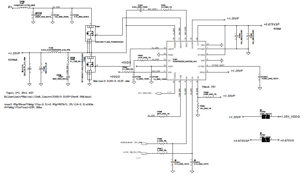

      At the IC RT8207MZQW, I should be getting an output of 1.35V and 0.675V. I'm not getting any output at all at any of the output pins.
      The top of the chip seems a little rough/corroded too, it doesn't have the shiny surface that other IC's have. But, could it be that this IC only outputs the 1.35V and 0.675V on the condition that SLP_S4# is present on pin 8? Or, is this irrelevant at this point?
      (btw, I don't have SLP_S4, but I do have SLP_S3.)

        SLP_S3# and SLP_S4# are enabling signals to RT8207 and are important. but do not get confused with them now.
        corrosion is a symptom of fault.
        now you have to check all the output voltages mentioned in page 58 of the schematics.
        and please confirm here all the missing ones.
