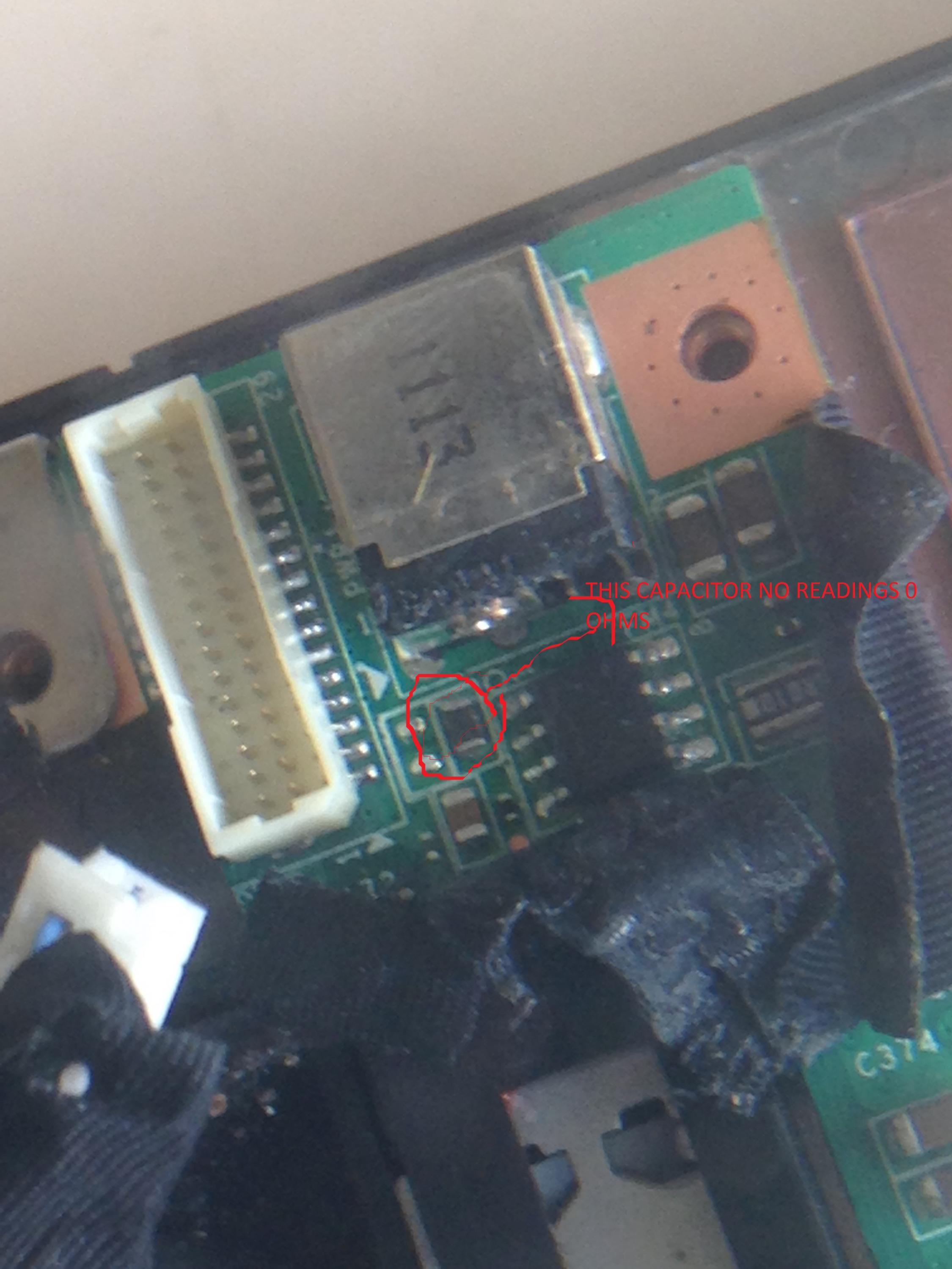

                            thanks for the response guys i measured again the mosfet AO4413 multimeter set to 200ohms
                            pin1 S1 black probe to pin 4 G1 red probe = 199.5 ohms
                            pin1 S1 black probe to pin5 D1 red probe = reading flashing
                            pin 4 G1 black probe to pin 5 D1 red probe = 193.6 ohms
                            pin 2 S2 black probe to pin 4 G1 red probe = 197 ohms
                            pin 2 S2 black probe to pin 5 D1 red probe = reading flashing
                            pin 4 G1 black probe to pin 6 D2 red probe = 190.3 ohms
                            pin 3 S3 black probe to pin 4 G1 red probe = 196.6 ohms
                            pin 3 S3 black probe to pin 5 D1 red probe = reading flashing
                            pin 4 G1 black probe to pin 7 D3 red probe = 188.6 ohms
                            pin 4 G1 black probe to pin 8 D4 red probe = 193.5 ohms
                            in seems that there is short on drain to source for the mosfet
                            and also notice 1 ceramip caps at back on dc have no resistance because ohms I Have attached the image. please anyone help on this please

                                  Re: msi netbook u135dx battery not charging
                                  any help on this please ill tried to change the mosfet AO4413 but i don't have the spare can anyone advise what compatible with this please
