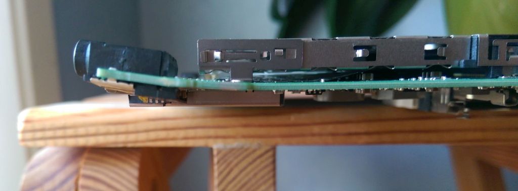

        It arrived in a flimsy cardboard box.
        Inside it lay loose in a US postal service paper bag inside an antistatic bag that did not even cover the whole board.
        As there was no filling in the box the board had moved around in there, and cracked it's PCB.

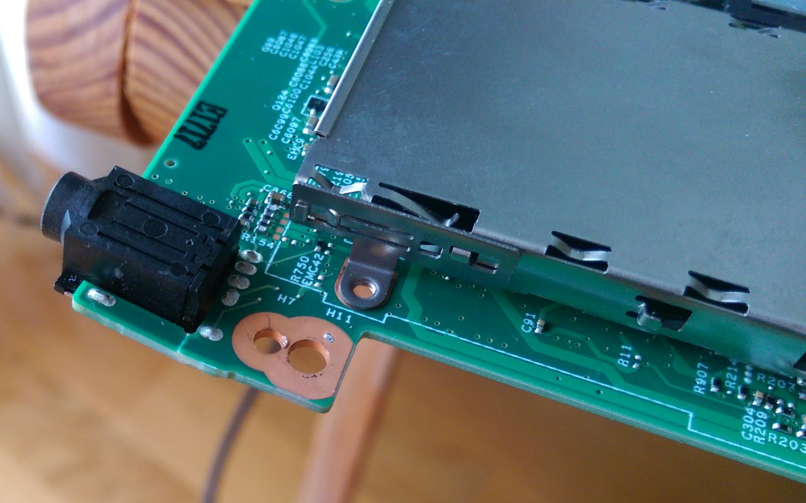

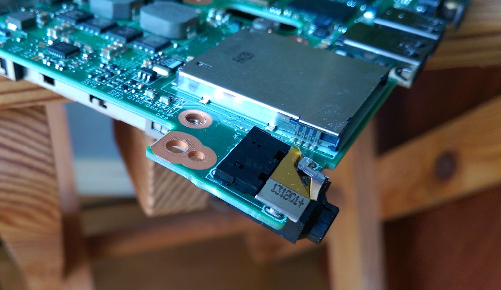

        But looking further this was the wrong PCB!
        When ordering I had compared the board I had very carefully with the posted pictures.
        But this had 4 RAM slots while mine had 2.
        It had a 8-pin CPU fan header while mine was 5-pin
        I thought ok no harm in trying it anyway and it actually posted, wow!
        But due to the different fan pinout I could not test it.
        Because if I tried to enter the BIOS or boot to a USB stick it just said CPU FAN Error and shut off.
