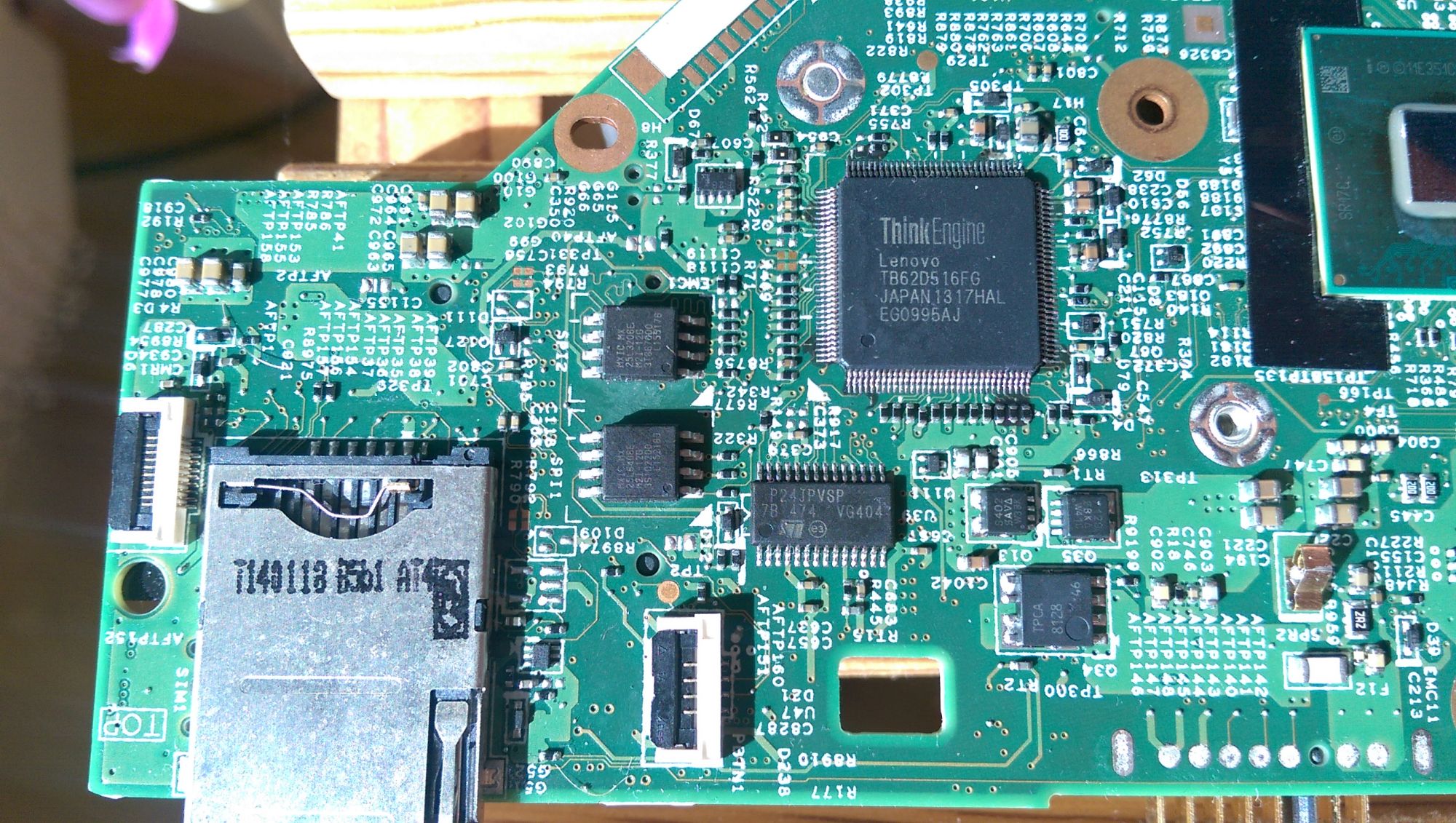

    I disassembled the laptop and found that the CMOS battery cable, which I had previously noticed was crimped between the PCB & magnesium frame was actually cut straight off!
    I desoldered the BIOS chips and tried to read them in my Willem GQ-4X programmer:
    The 8MB chip: MX25L6406EM2I-12G could be read.
    The 4MB chip: MX25L3206EM2I-12G could not even be identified by the programmer.
    So I ordered new pre-programmed chips on eBay and soldered them in, but still there was no video output.
    The new chips are: W25Q32FVSSIG & W25Q64FVSSIG

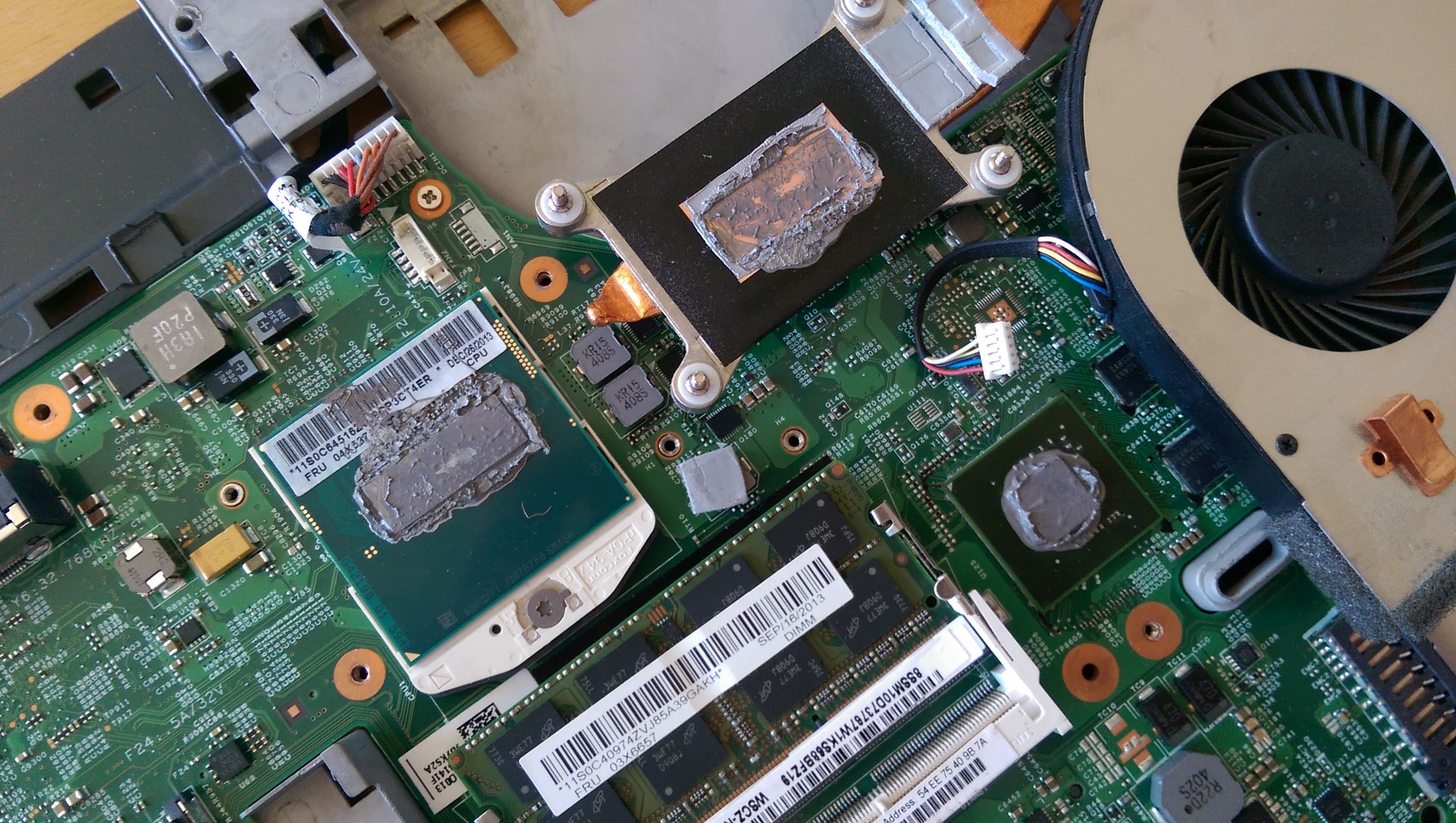

    So I took some measurements (have not located a schematic).
    Inductor L36 sees 1.35v (DDR3L)
    Inductor L8 sees 0.9v (nVidia GPU I think)
    Inductor L37, L38, L39 see 1.77v
    Obviously 1.77v is too high for the CPU but I've never looked at one so recent before.
    It is a 4:th generation Intel Core i7-4700MQ CPU with SSPEC: SR15H so Haswell based with integrated VRM in the CPU itself.
    What does 1.77v signify, does it mean the CPU is not communicating with the VRM?
    Or is it simply the VRM input voltage and if I want to know the VCORE voltage I have to get my hands dirty?

        To answer my own question above yes 1.77v is normal for the Fully Integrated Voltage Regulator (FIVR).

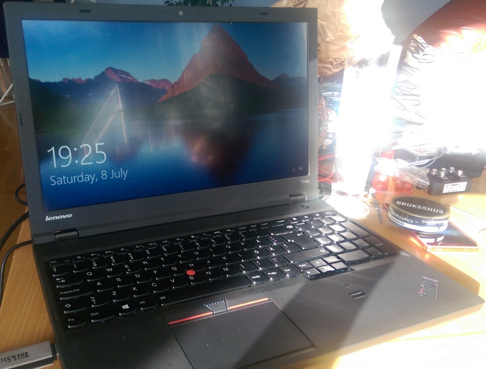

        When the fan arrived I tried it and sure enough, as I got into the BIOS for the first time I could verify that it was a W540!
        So now I installed Windows on the machine with the PCB bare on a table to check stability and it seemed ok!
        So I ordered a touchpad with 3 physical buttons because the original is this stupid thing with no buttons.
        When that finally arrived I reassembled the laptop, no missing screws after so many months passed!
        For ease of installation I had used Windows 10 during my testing, but now noticed a problem:
        The screen would intermittently go dark for a few seconds, I was quite sure this was a driver problem though:
        Because Win10 had happily overwritten Lenovo's combined Intel / nVidia driver that has the graphics adapter switching magic in it.
        And as I have grown a bigger hatred for Win10 the more I've used it I decided to put Win8 on it as the board has a license for it built into the BIOS.
        But sadly the issue remained in Windows 8.1 with the right drivers installed
        I have documented that issue in this separate thread but in the end what was necessary was to replace the 135W AC adapter with a 170W one.
        I do find that a bit strange because the W540 and T540p are very similar (they use the same chassis).
        The documentation for the W540 does state that if you get it with a quad core CPU it will come with a 170w adapter.
        But the same CPU in a T540p and it comes with a 135W adapter.
        The nVidia graphics card is slightly better in the W540, but it's not a significant difference... GT730M vs Quadro K1100M (33w vs 45w).
        After all of this I might just settle on Win7, because I just checked and it does have a SLIC 2.1 table in the BIOS, did not think it would have that!
        But I must say this laptop is fantastic, it has Lenovo's 2880x1620 IPS screen which is just amazing compared to my old trusty Eizo monitor!
