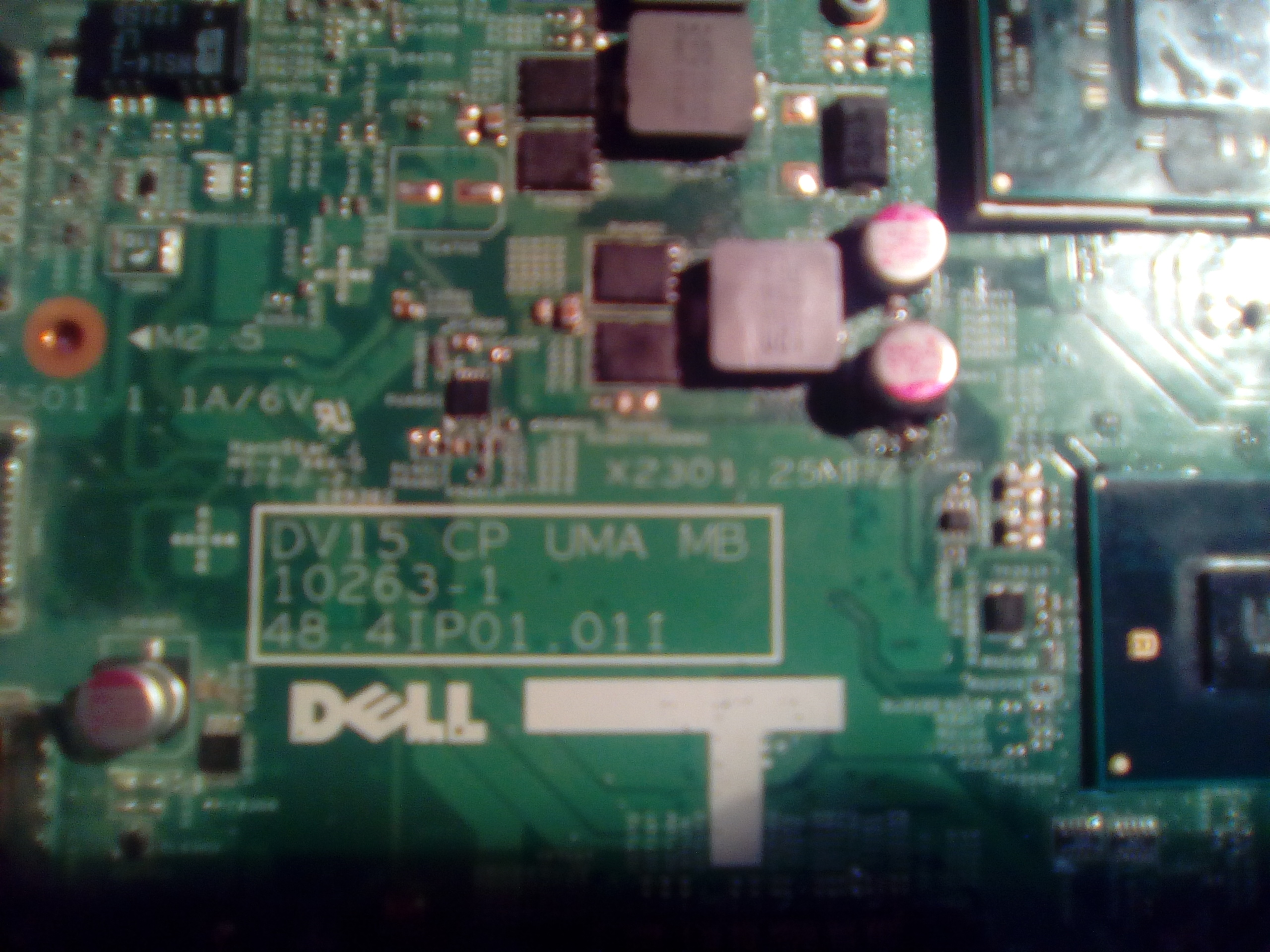

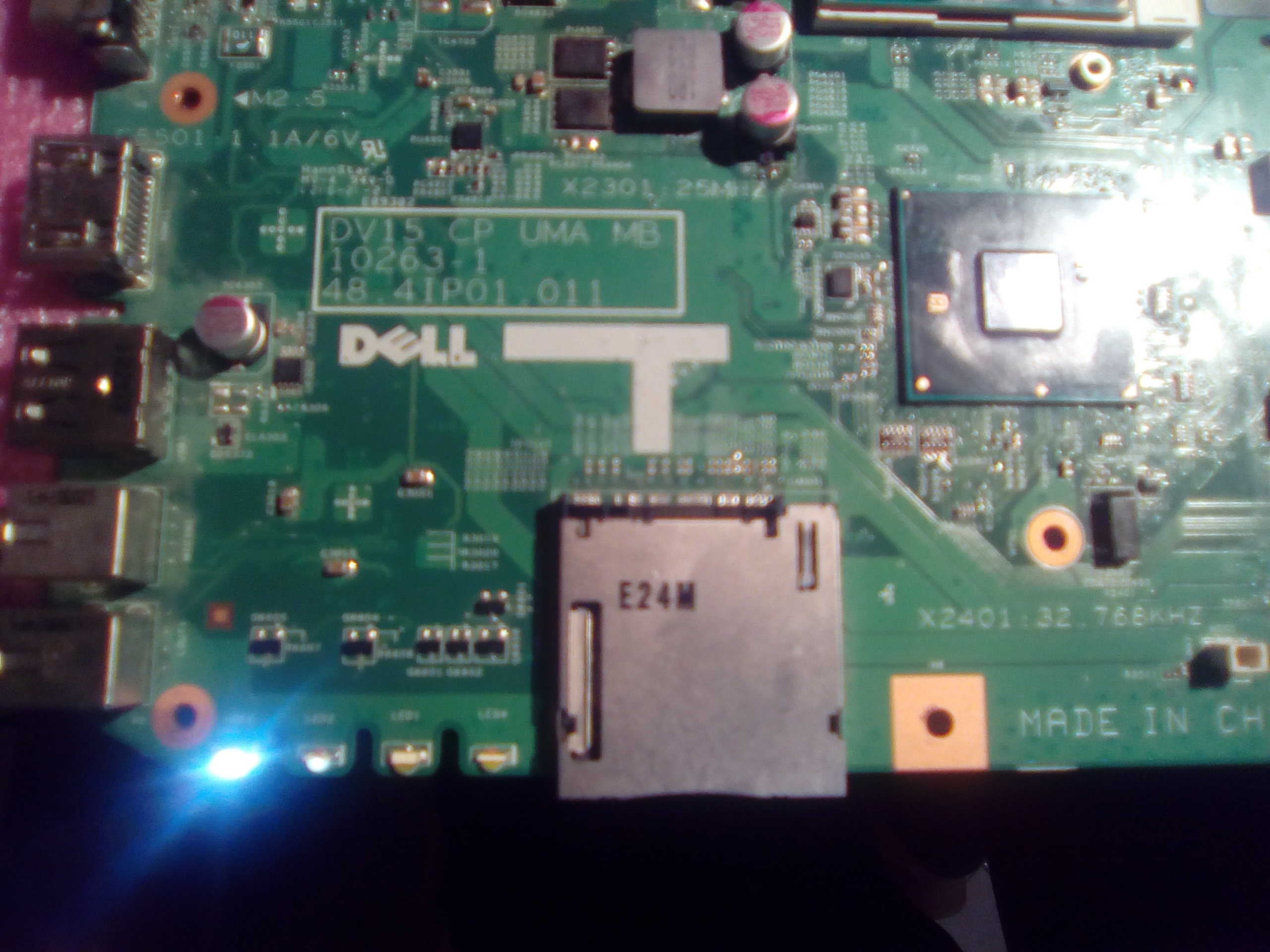

    Hi everyone,
    The problem is the laptop won’t turn on. When I connect the power adapter the LED of the power turns on without pressing power button, I measure 19.5v(power jack), 3.3v (battery connector),3.3V, 5V and 1.8v are present but CPU _core, 1.5v of memory are not present.
    There is no short to ground of Vcore, ddr circuit, no heating circuit, no Ampere consummation (tested with power bunch, 0.9 A)
    I flash bios with many worked files from the forum with no results.
    What can I do…please help me

    Re: Dell N5040 wont turn on
    1st check memory ic
    • ktmmotocross
      Boardkiller
      • Feb 2014
      • 3627
      • slovakia
      turning on without pressing powerbutton is mostly failure of SIO chip or NB
      try to heat up NB to 120c, let it cool a while and check
