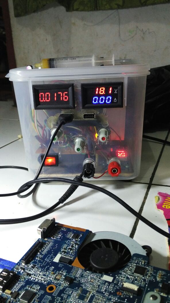

          Originally posted by cyberhack
          Or build DIY PSU bench supply that could controlling output limit of voltage and current.
          Our friend Kazia, He already managed to build PSU using PSU2 schema
