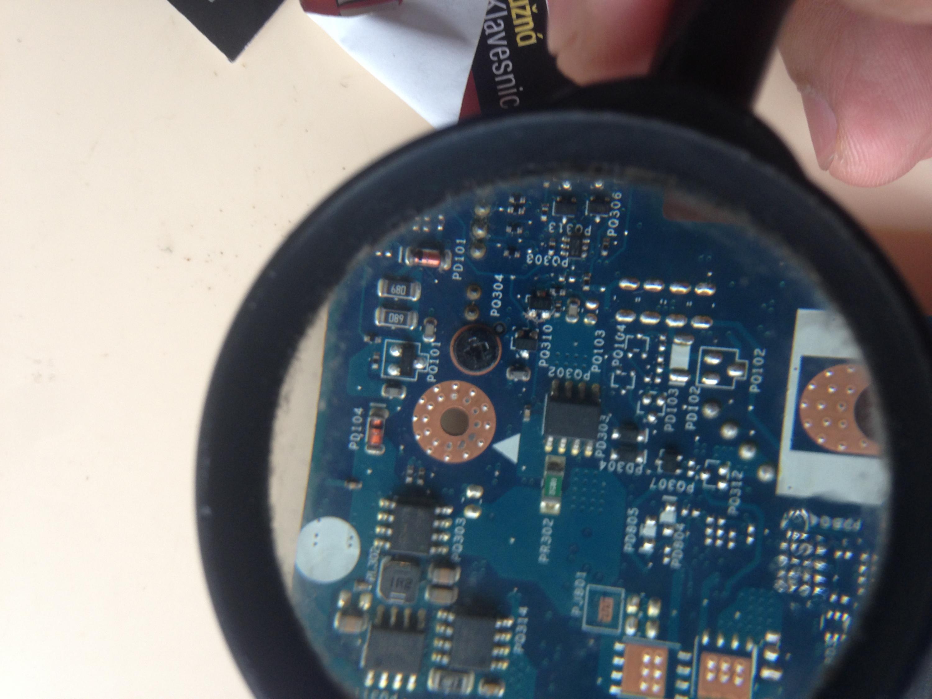

              Re: Lenovo g475 shuts off in 3minutes
              I measured PQ301 pin 2 to 4 all 19volts and 5 to 8 are 0volts and also i measurex a PU101 pin 1 to 5 are 0.25 volts and pin 6 2.45 vols and 7 0volts and 8 19 volts.i have attached the image
                Do you have schematic bro? Then chrck short or leackage capacitor in DC_Batout or Vin(I don't no exactly the signal name for this mobo) section. Ensure output voltage 18.5-19v. Then go through BIOS.

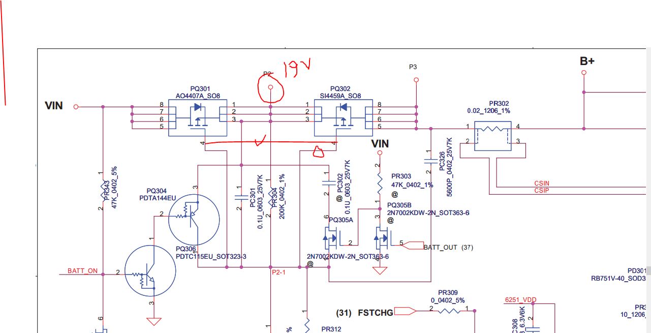

                  thanks for the response i will check the short capacitor on dc battout I have attached bro subroto the schematic thanks

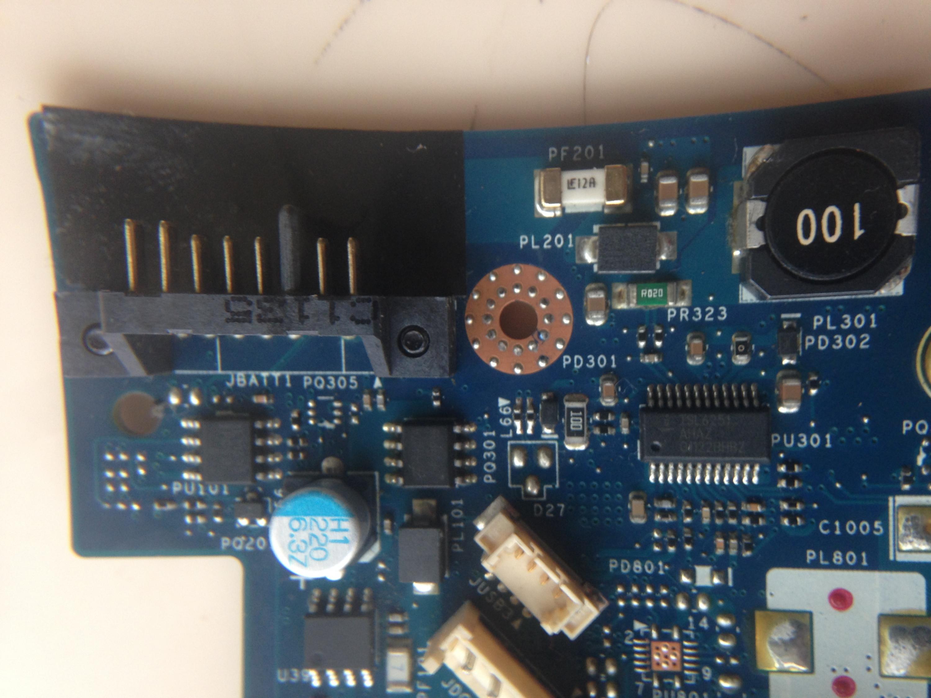

                        I measured gate pin 4 of pq301 its 19 v and i cannot find pq302 i found only pq303 and measured pin 4 is 0volts.

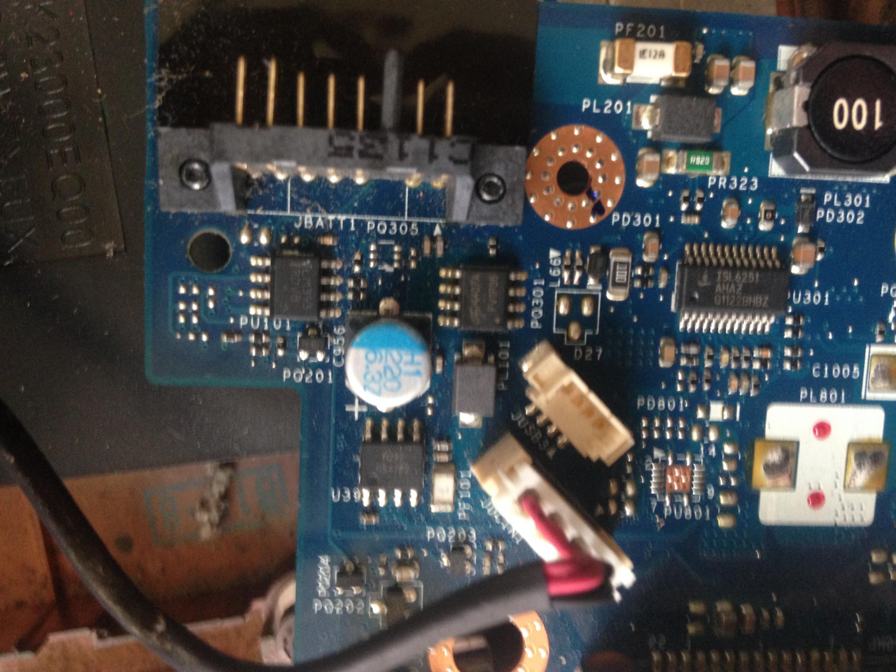

                          I have attched the image of the board
                              According to your schematic of page 38, check the source voltage of PQ301(P2 point voltage) and check the gate voltage of PQ302. If here is no voltage, then short the two gate of PQ301 and PQ302. You will find B+ voltage perfectly.
                                This is PQ302 in your pic.
                                  Thanks for the response bro subroto i done checked both pin 4 gate of pq301 and pq302 its 19.9 volts both and checked also as you mentioned pin 2 source of pq301 its also 19.9 volts.should i short the pin2 of pq301 and pin4 of pq302?please help thanks
                                        How much voltage at P3 point?
