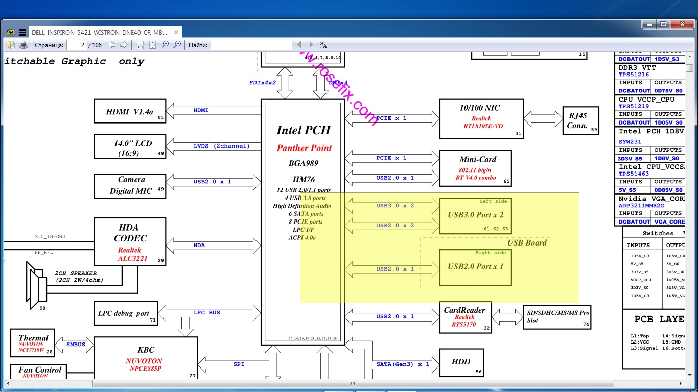

    Help me guys. I'm in stuck. Dell Inspiron 3421 USB ports are not working. Both USB2 & USB3.
    All other function is fully ok.
    The measurement on the following:
    Vcc= 5V
    D+= 3.3V
    D- =3.3V
    I've replaced U6102 but still have the problem.
    The schematic is in the attachment.
    Thanks guys.

        @oziel1 - does the in internal usb webcam work ?
        What are the voltages on the USB connector for each ?

            1) Post the voltages on each D+ and D- pins of the USB connector. Do this for each port on this box.
            2) You are unable to attach any USB device onto any of the ports and have them detected ? Are you running Windows or some other operating system? Does the Device Manager get busy once you dock a USB device onto the port ? Or sits there like a bump on a log ? Try assorted USB devices to be sure it is not your cable or single device.

                    What is the history of this computer? Was it working 100% and then just stopped working ?
                    It is strange that multiple ports are now defective.
                    Webcam works so the internal USB engine is working.
                    Perhaps some ESD transient that killed a port but having two damaged ports is quite strange.
                    Any liquid damage ?
                    You need to post more and full details - cannot guess each and every permutation.

                      Test the voltage on U6101 pin 4 USB_PWR_EN# .Are the USB`s enabled in bios settings

                          D+ and D- in all usb ports are ranging from 0.2v to 0.5v.
                          all option of usb are enabled on the bios.
                            Not OK. How about resistance to ground?
