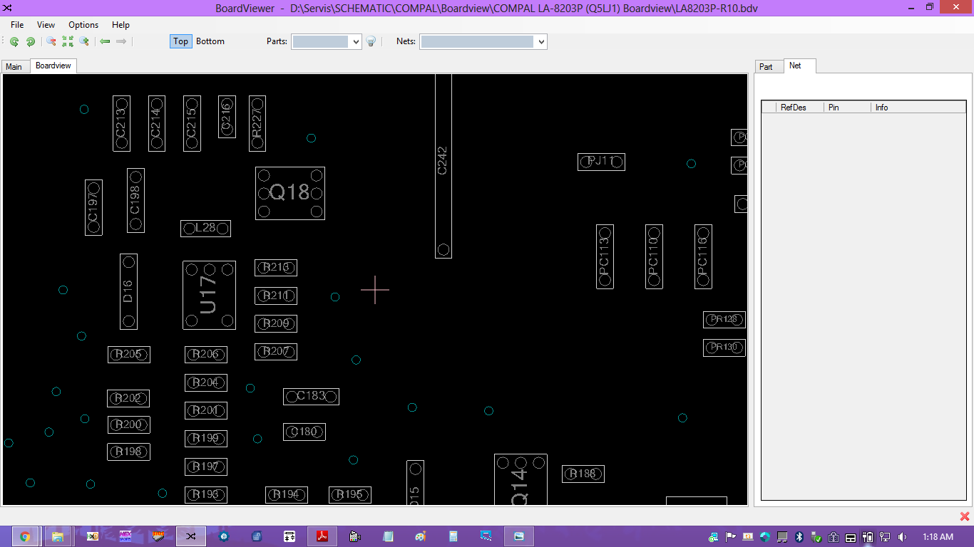

    Like the title says, this laptop doesn't detect the battery.
    I'm searching without success the boardview, i do have the shematics but i'm no good on finding the IC.
    Any help is much apreciated .

    Re: Acer Aspire M5-581TG battery not detected
    Here:
      Originally posted by meritosari
      Here:
      Thanks buddy, but there are no voltages, or IC names, just the components placement without any other info.
      Or i'm using the wrong viewer ?
      • meritosari
        • Oct 2010
        • 774
        • Indonesia
        the bv it only tell us part position of mobo, component must reading on scheme

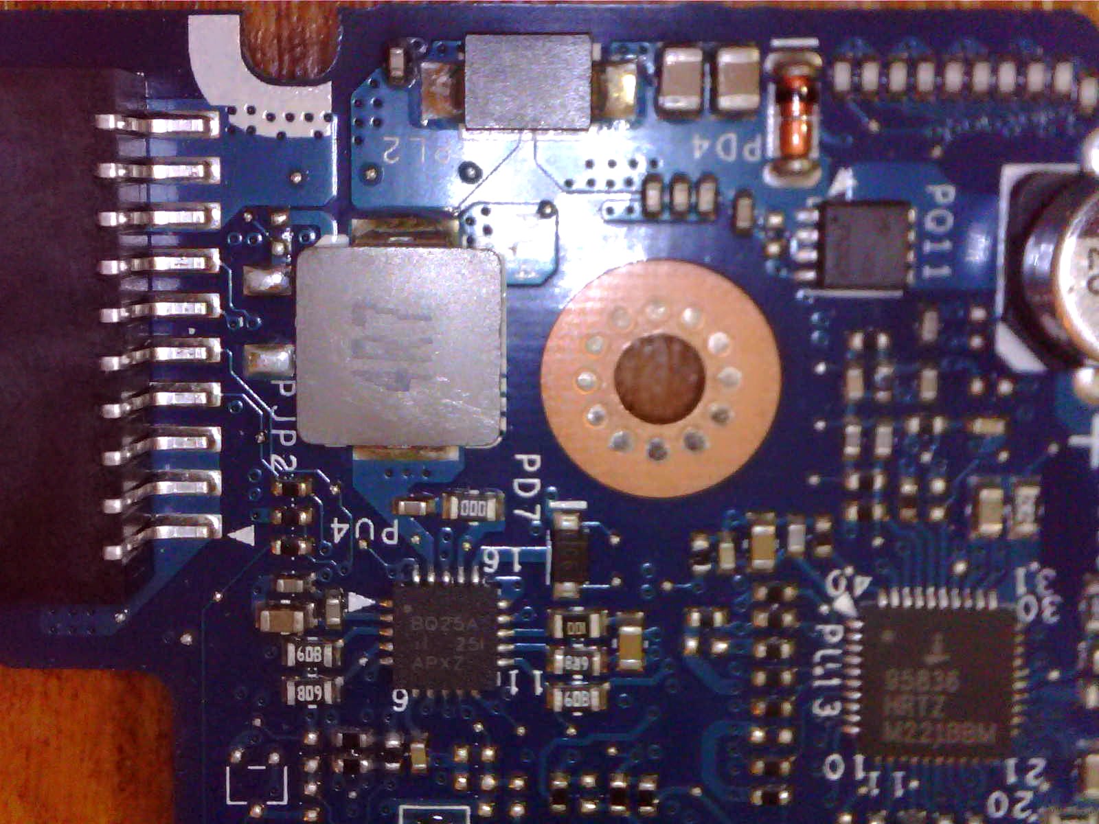

          OK, i guess i found it, it's PU4 ?
              I only have 3 and 1 Volt on the battery connector, which pins / components should i measure ?
                Any good soul to help me track the culprit ?
                Help ... please
