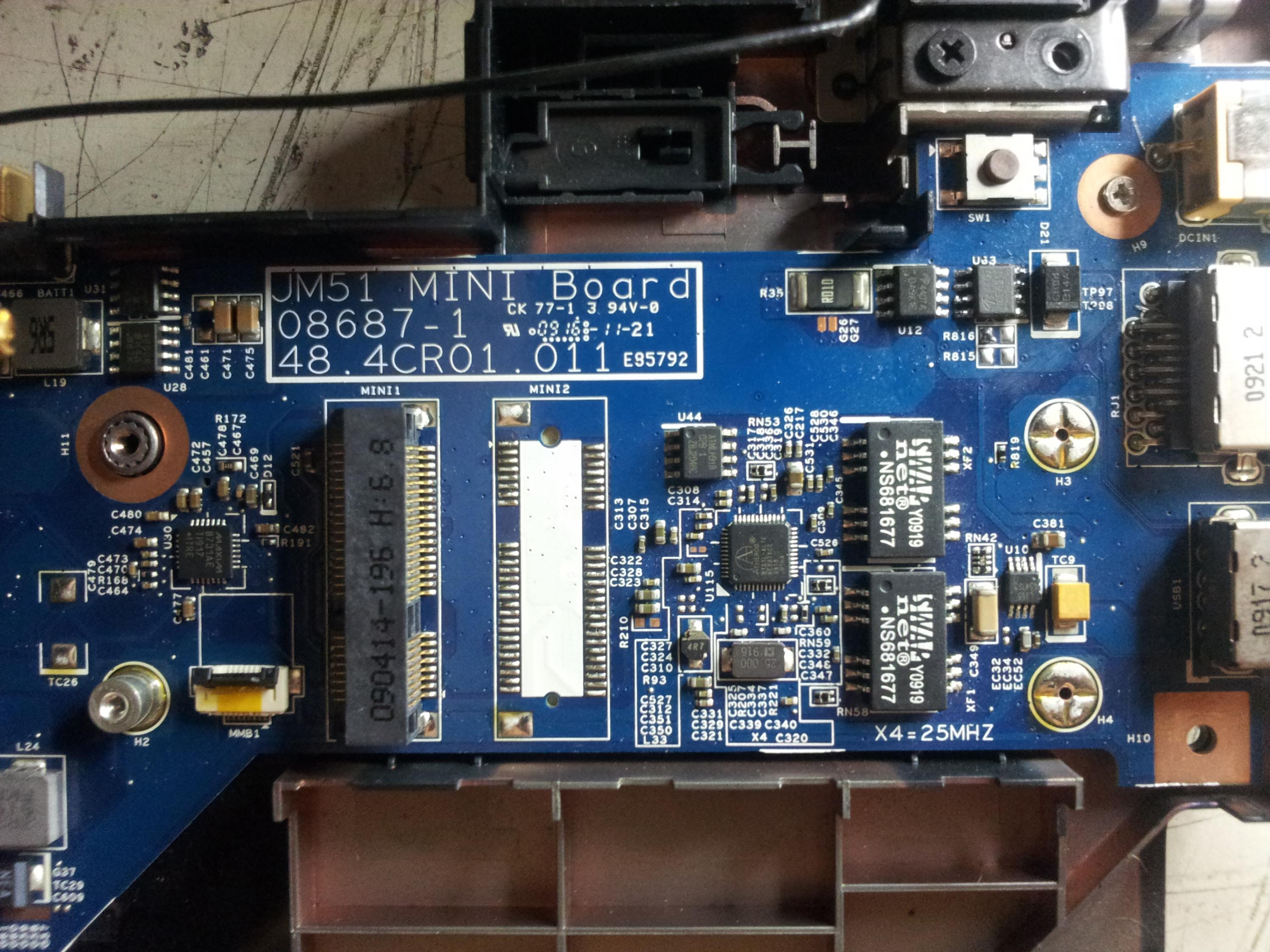

    Hello.
    This is my 3rd and last laptop that is completely dead, the schematics are a bit crap so if you have anything better or some knowledge to donate i will appreciate it
    So i have 19v at U63 (A04407) in both sides, i have 19v at U12 (A04407) in Drain side and on all Source pins.Gate has 1,7v.
    I also got 3v to the power switch.

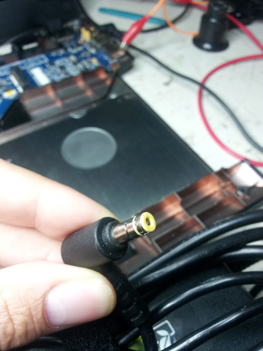

    Other notices : The charger is 3 pin and appears broken, i get voltage from a regular 2 pin charger from another Acer.

    The schematic only shows the main board. The DC jack and 3V/5V chip, etc. are on a separate board called the "MINI Board". They put each board in its own schematic. I'm attaching the schematic for that one.
    First, check the 3V/5V chip. Since it's on the back side of that mini board, the easiest way to check the outputs (without removing the board from the case) is at the inductors L24 and L25. The 3V for the power button comes from the linear 3V output and not the switching 3V output. So we want to check that the switching outputs are working.

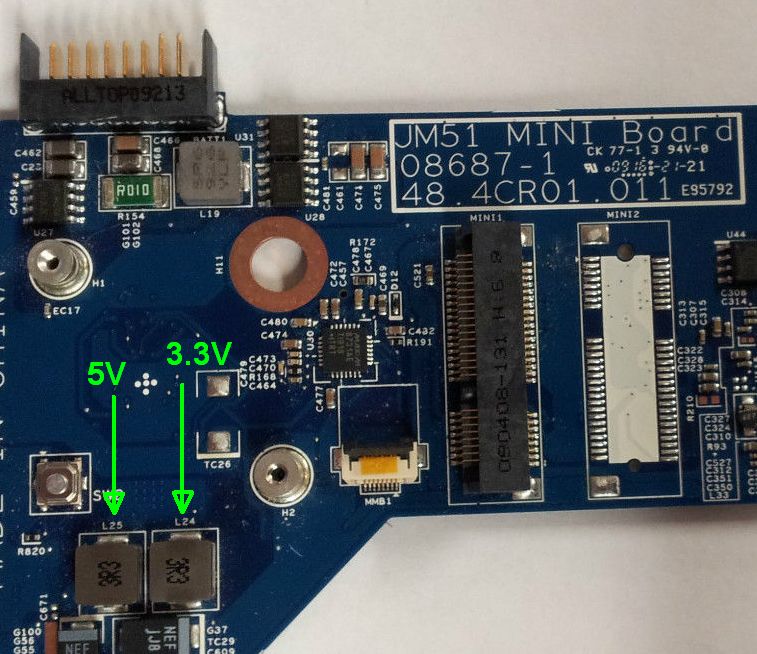

      Re: Acer Aspire 5810T Completely dead, no lights at all.
      No voltage at all at L24 and L25.
      Now i'm trying to found U58 but i don't see it anywhere....
      Is there a chance to require only the 3pin charger that came with from factory?
      Never seen a charger like this in Acer again.

        The schematic I gave you is only for that DC-IN board labeled "MINI Board". The schematic you provided is for the main board (the one with the CPU, RAM, etc). There are also at least two other boards connected through ribbon cables. Each board has its own PDF.
        This is going to be a similar situation to the first one I helped you with. You are going to have to remove the main board and the mini board from the case and then (while keeping them connected together), plug in the AC adapter. Then, measure all the pins of the 3V/5V chip (U58). Also check all the outputs for shorts.

            Yes, pins are always numbered counter-clockwise (except for some random 3pin components I've seen).
            You'll be checking for shorts on the outputs of U58. The switching outputs can be easily checked at the inductors L24 and L25. The linear outputs can be checked at pins 8 and 17.
            But it looks like U58 is not even being told to turn on. So let's investigate that signal. Measure all pins on Q11 and Q12 (they both have 6 pins and are located very close to U58).

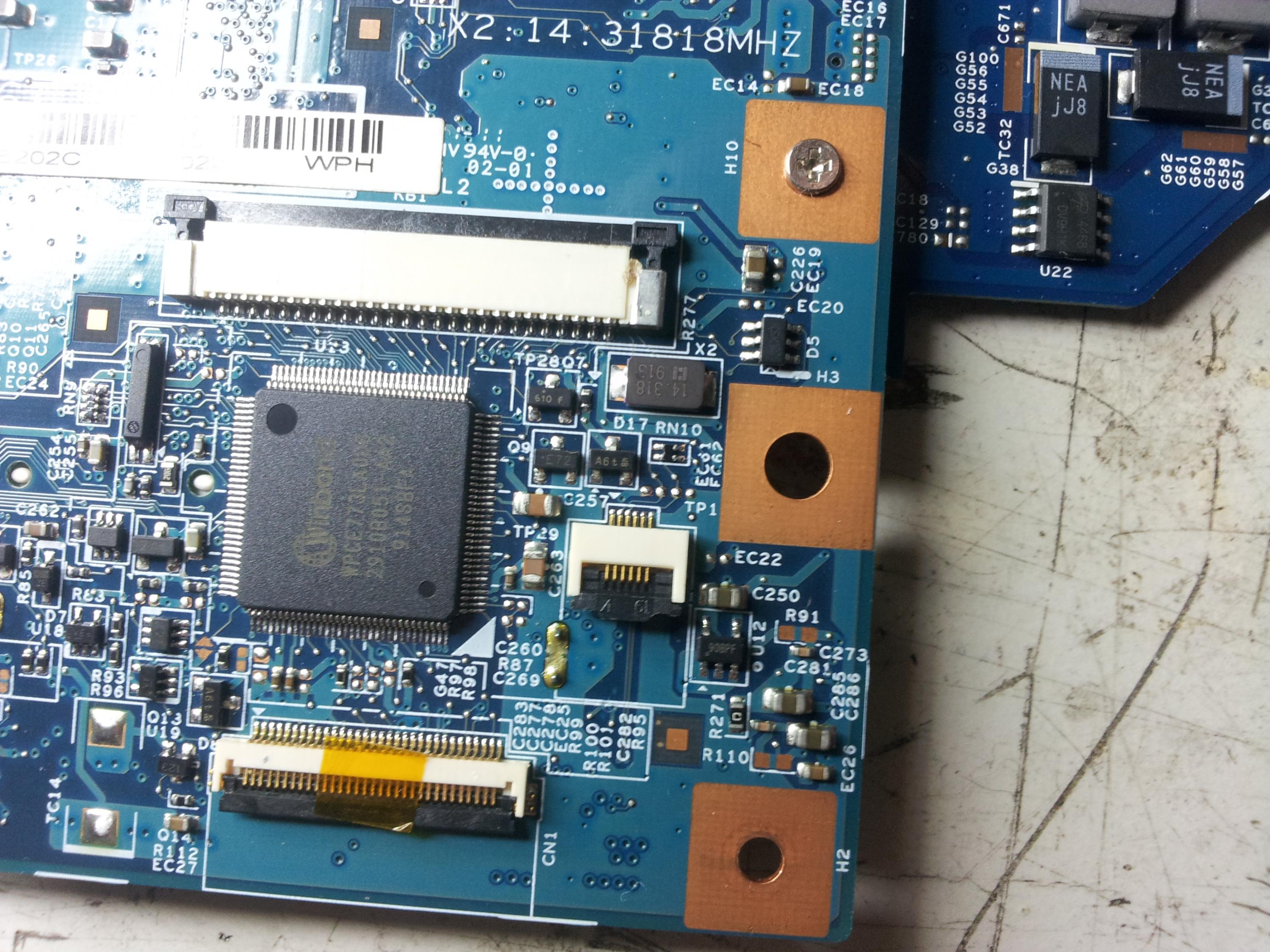

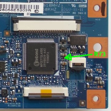

                      Hello again, got some connection problems but now all set.
                      So my mainboard is a little different than photo.Please check the picture.
                      I found R73 on the other side, not sure if still the resistor we want since the board is different, but i got no voltage on both pins.
                        I found a better schematic for your board. It looks like the other one is for the version with a separate GPU. That does change things a little. The pin you need to check is still pin 15 though. Don't worry about the resistor unless you get voltage at pin 15 because it's not right next to the pin like on the other version of the board. It's R214 and it is on the opposite side of the board.
                          No voltage at pin 15, no voltage at R214 both sides.

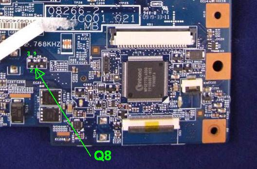

                              So the 3V/5V outputs truly are being told to stay off. Next, test some other voltages:
                              All 3 pins of Q8
                              Also, on the EC/KBC/SIO chip (U13):

                                On Q8 i get 3.3v only at Collector (rest 0v) and on U13 i get 3.3v as well at pin 85 and 0v at pin 93
                                No AC_IN? What the heck?

                                  I don't have AC_IN neither in BTB1 connector, is this a chance that this model requires the 3 pin (ID) charger that came with and cannot work with the usual 2 pin?

                                    It just uses 2 wires in the AC adapter. But the center hole has a thin piece of metal on each side of the hole. If the plastic is broken off, it might look like it has 2 pins inside and also the surrounding ground connection. But the 2 pins inside are connected together. The jack on the motherboard has an extra detection pin but that just touches the ground on the barrel connector to detect physical insertion of the adapter. There's nothing special about the AC adapter itself.
