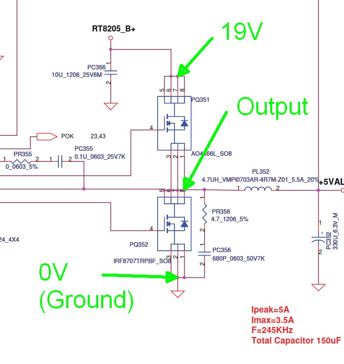

          Another evidence is the the 11 and 20 pind both take voltage from PQ331-PQ332 and PQ351-PQ352 so i'm thinking that perhaps a voltage from the FET's is missing?
          What do you thing?

            The rail that powers the MOSFETs is the same one that powers PU330 itself, so that seems unlikely. You can check if the chip is being told to turn on the outputs though. Measure the voltage on pins 1 and 6. A reading of 0V means "turn off" and something higher (e.g. 1.5V) means "turn on".
            • Andreasbest
              • Aug 2014
              • 1179
              • Hellas ( Greece )
              Re: Toshiba C660 -1MK Completely dead, no lights at all.
              PQ331 and PQ351 have only the 19V DC on one side, no other voltages.
              The PQ332 and PQ352 have no voltages at all.

                    PU332 and PU352 are controlled by PU330. They help create the output voltage (3V or 5V in this example). But since there is no output voltage, the only thing you will find is the 19V on one side of the top MOSFETs. (see attached image)
                    Search the web for "synchronous buck converter" tutorials if you want to learn more about how it all works.
                    1.66V is normal for pins 1 and 6. The outputs should be on. So that likely means PU330 is bad and/or there is a short on one of the outputs.

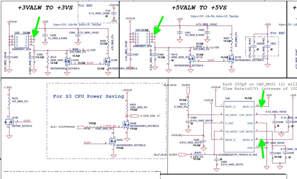

                        Look at page 41 of the schematic. The board doesn't allow the 3V and 5V to go everywhere right away. There are transistors (Q29, Q30, U46) that disconnect parts of the board until the power is plugged in (also known as "load switches" when used this way). If there is a short behind a load switch, you won't be able to detect it at PU330..
                        You need to test for shorts on the other side of those load switches. See the attached pic for the points to test (meter in diode mode, red on ground, black on pin to test). I don't think you will have all 3 of those switches though. Either your board will have Q29 & Q30 or it will just have U46.
                        • Andreasbest
                          • Aug 2014
                          • 1179
                          • Hellas ( Greece )
                          No shorts on Q29 Q30 (no U46 on board) and also no voltages at all.Before them?

                              PGOOD indicates stable outputs. Since we already know the outputs have no voltage, this unfortunately provides no new information.
                              We have reached the end of what can be done easily without soldering. You might want to return the board to the seller. But if you want to continue, read on..
                              Isolating the 3V/5V outputs is incredibly easy on boards like this one. The separate power rails of the board are connected with solder jumpers. You will find them on page 42 of the schematic.
                              To disconnect the outputs of PU330 from the rest of the board, all you have to do is use some desoldering braid to remove the solder jumpers from PJ332, PJ352, and PJ333 (there is no solder jumper for VREG5). Now plug in the board and test the voltages on PU330 pins pins 8, 17, 20, and 11. They should all be either 3V or 5V. If not, then PU330 is probably bad.

                                Pin 23 has no voltage at all.but we went way back to q29 and q30 that haven't voltage either,they start the pu330 to start the fet's.now I'm trying to found out from where the q29 and q30 get voltage from....
                                • BlueMidnight
                                  • Jan 2015
                                  • 489
                                  Wow, posted at the same moment.
                                  Just a clarification... Q29 and Q30 are on the outputs of PU330, not the inputs. But you don't have to worry about those anymore. If you want, follow the instructions in my previous post.
