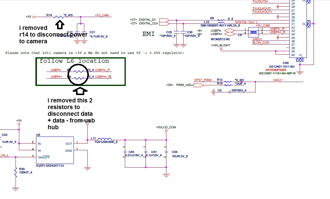

    hello everyone I need your help guys
    this laptop came up with not working usb port 2xusb3 1xusb2
    no sound card or camera in devices,1 unkown device on usb hub probably camera also Sound IC is burnt customer mentioned that smoke cam out from laptop once but laptop was working with it's touchpad and keyboard boot to windows
    so I tried to check out what's wrong I've tried to disconnect camera from mainboard
    R14 3v camera removed also r8,r9 they are usb data + data - to camera
    plug adapter try to power on computer it didn't work at all
    reconnect r14 3v and retry nothing reconnect r8 r9
    laptop power up with no data caps lock blinking south bridge getting hot
    my problem that I want to make this laptop boot again at least like previous condition I'm pretty sure I didn't do something wrong
    how to check Southbridge if it's working or not
    what could cause this,,, Bios, Southbridge, burnt sound ic or something else
    please help me guys

    Re: pavilion g6-2163se Motherboard problem
    Have you tried it yourself and it was working according to your description before trying to fix? Or is it so u just believed the other guy?
      yes it was working he even said wifi not working also I check out
      no drivers were installed I install all it's drivers
      wifi worked 2 vga cards worked but no usb or sound card Plus 1 unknown device in usb device controllers
      :'( I really didn't do something extra just remove those resistors and I was very careful not to do something wrong ;'(
      what I did was mentioned for real
          check y5,y6 ,y7,y8,and specially y9 (25MHz frequency Crystal ) may be damage.
            Then have you removed the burned audio codec chip before desoldering other components?
            If the audio codec not removed, start there, remove it, resolder any other component you took off the see if it helps.
            Its very likely you now totally fried the PCH if nothing moves. good luck.
              thanks for helping me tibd
              you were right PCH was fried
              LCD/Camera Cable was damaged and shorted and i didn't notice it till it was too late
              wish i could replace PGA chips here in egypt
              i wish i could have access to buy PCH ICs and solider it
