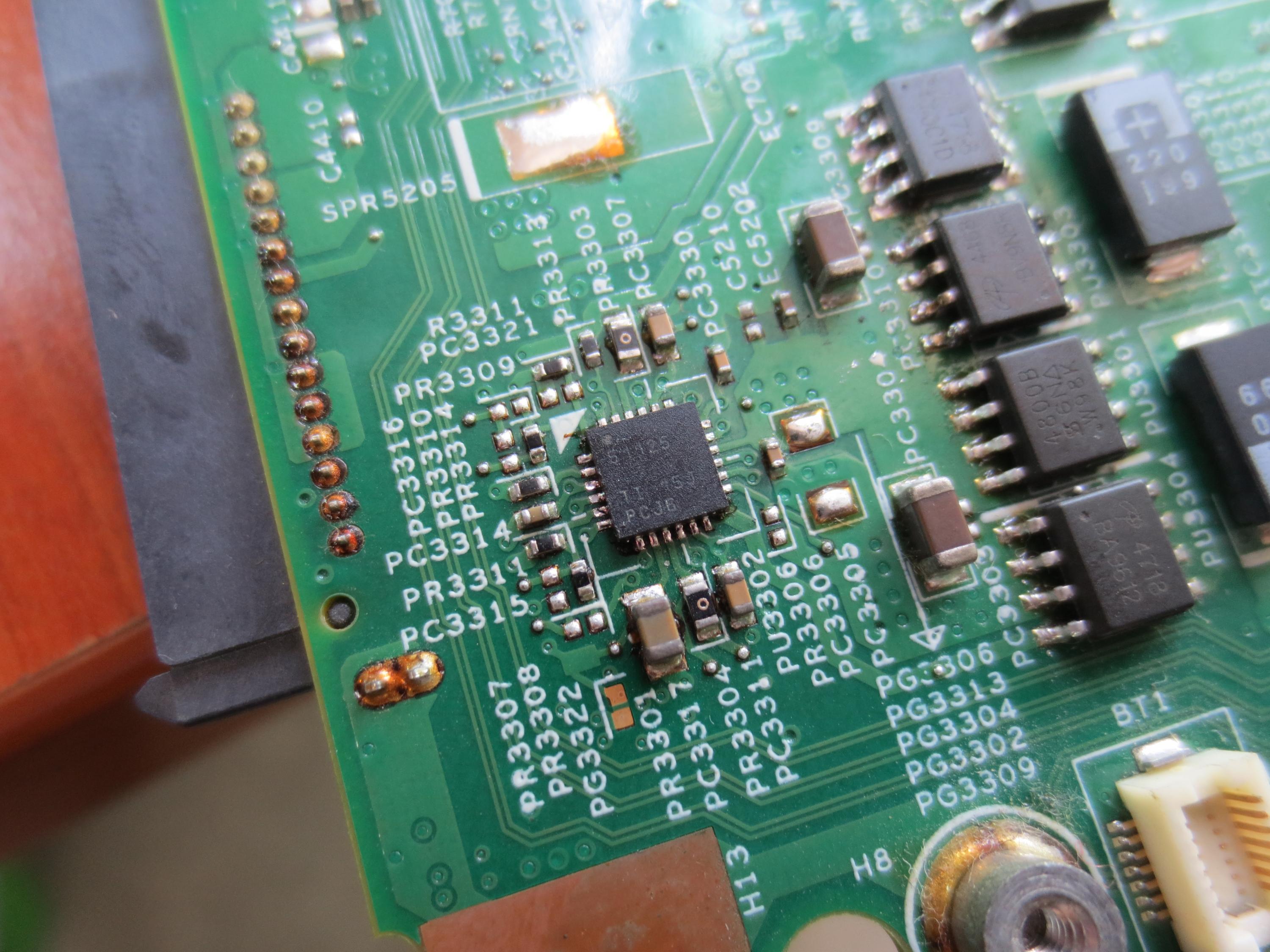

    Hi everyone here,
    I hope somebody can give some advise for me.

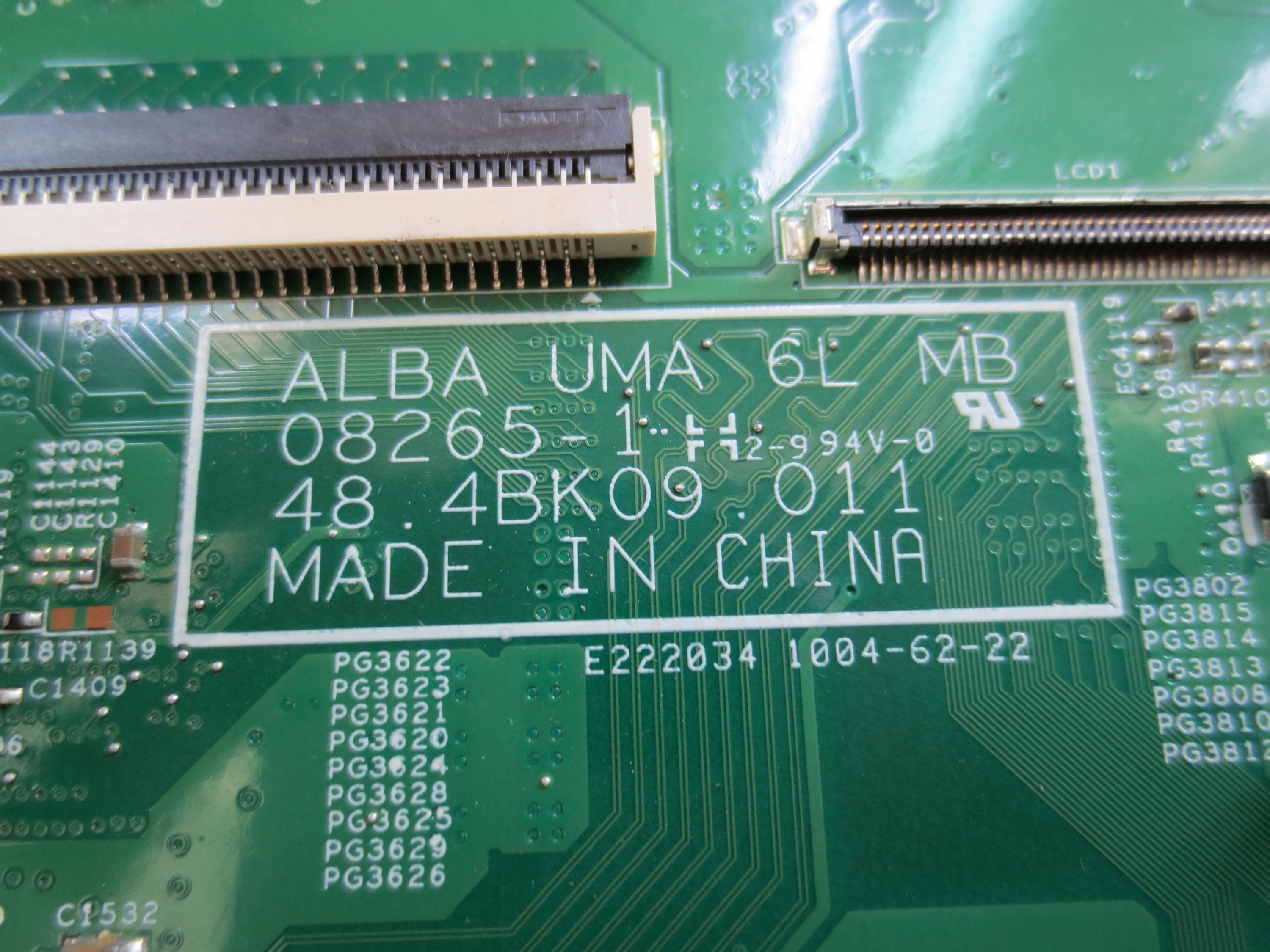

    Dell Inspiron 1440
    Board ALBA UMA 6L MB 08265-1
    Original the chip TI51125 burnt and shorted.
    Had it replace with a new chip.
    Now I have 3.3V at PTC3301 capacitor, but PTC3302 only register 1.168V instead of 5V.
    Does anyone knows where should I look into ?

    Re: Dell Inspiron 1440 5V not present
    replace the mosfet of 5v.
      first check any short on 5V coil.
        that is problem mean you have some pins is not connected correctly .
        you need to use flux and solder all pins ... i hope it will work
          Tried all but no luck though....
