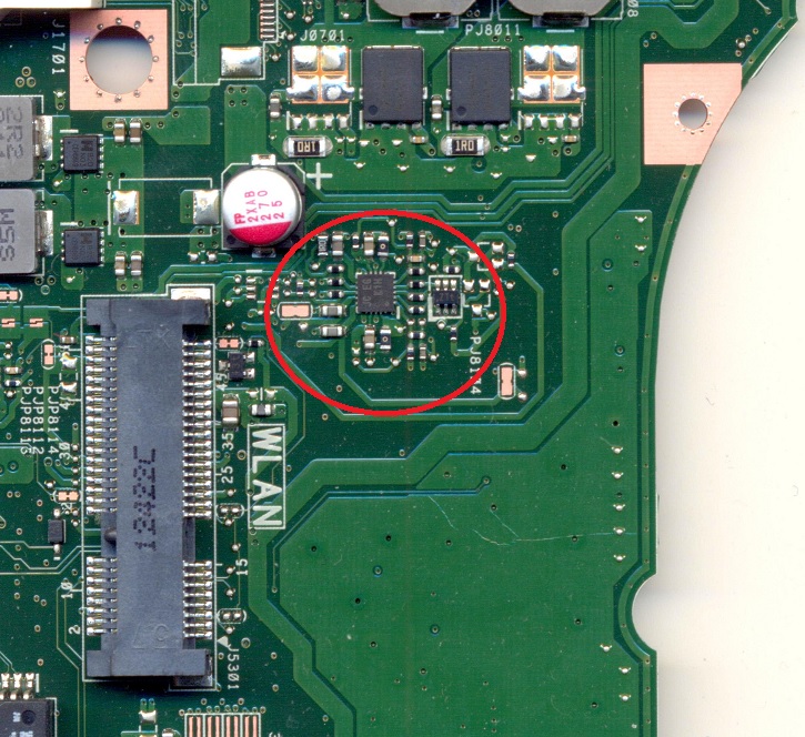

    I need to know this component from picture, is getting hot , laptop not charging , not powers up

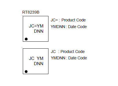

      Re: Asus K55VD - No Power -
      Rt8239bzqw
                  PU8100 gets a little hot because of the I/O. Change the I/O (IT8517E) and check everything is fine. Good luck.
