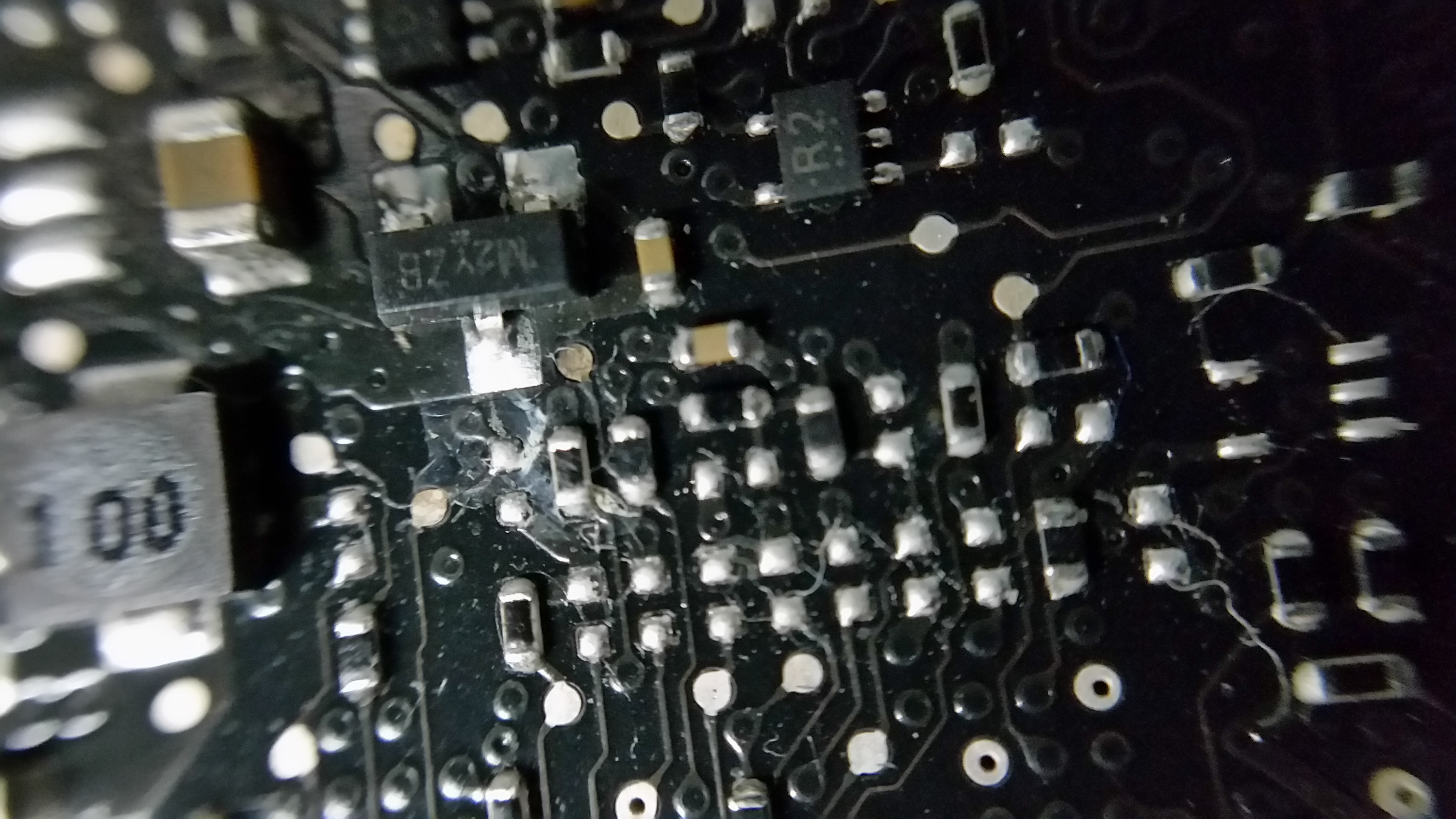

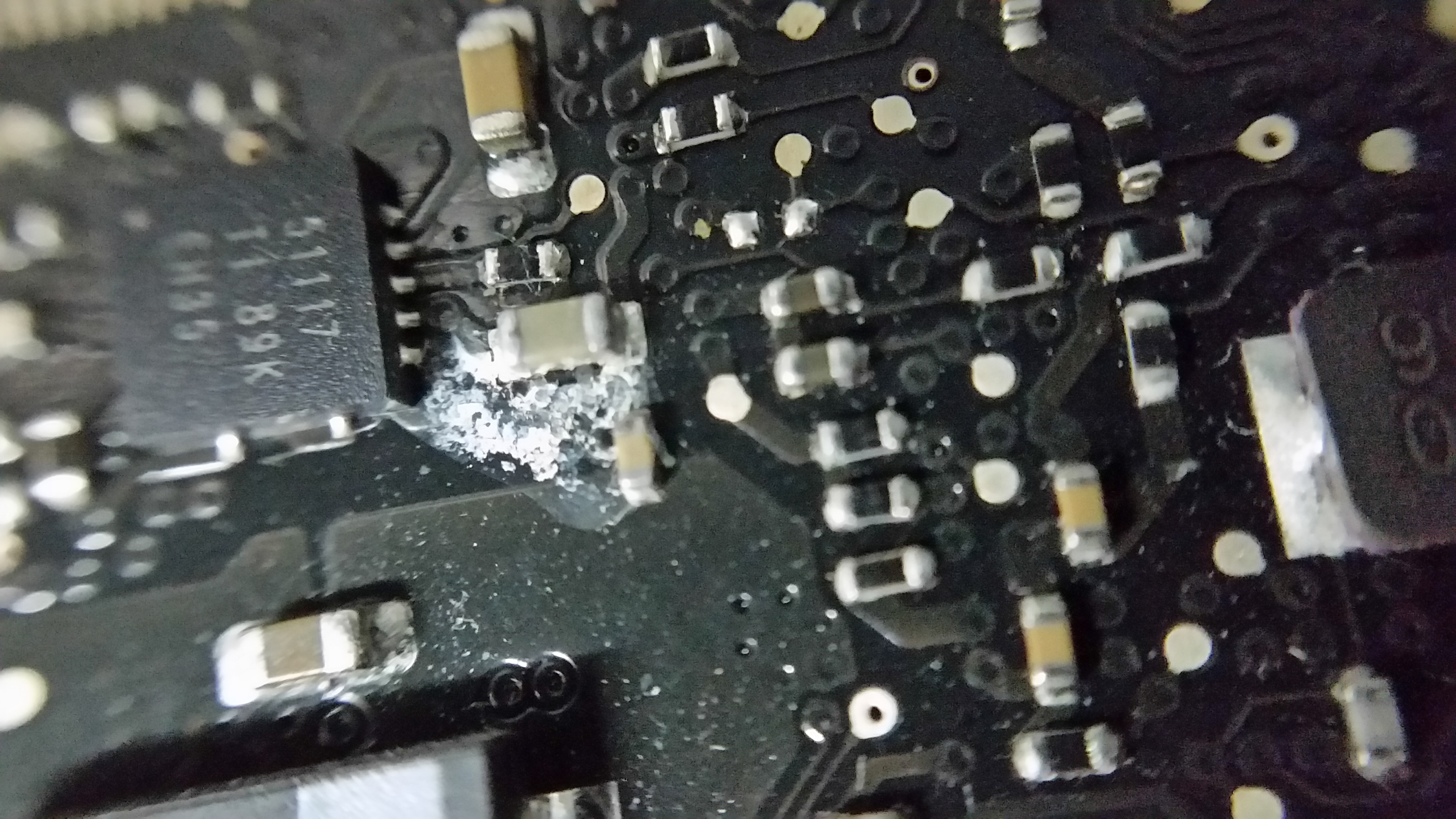

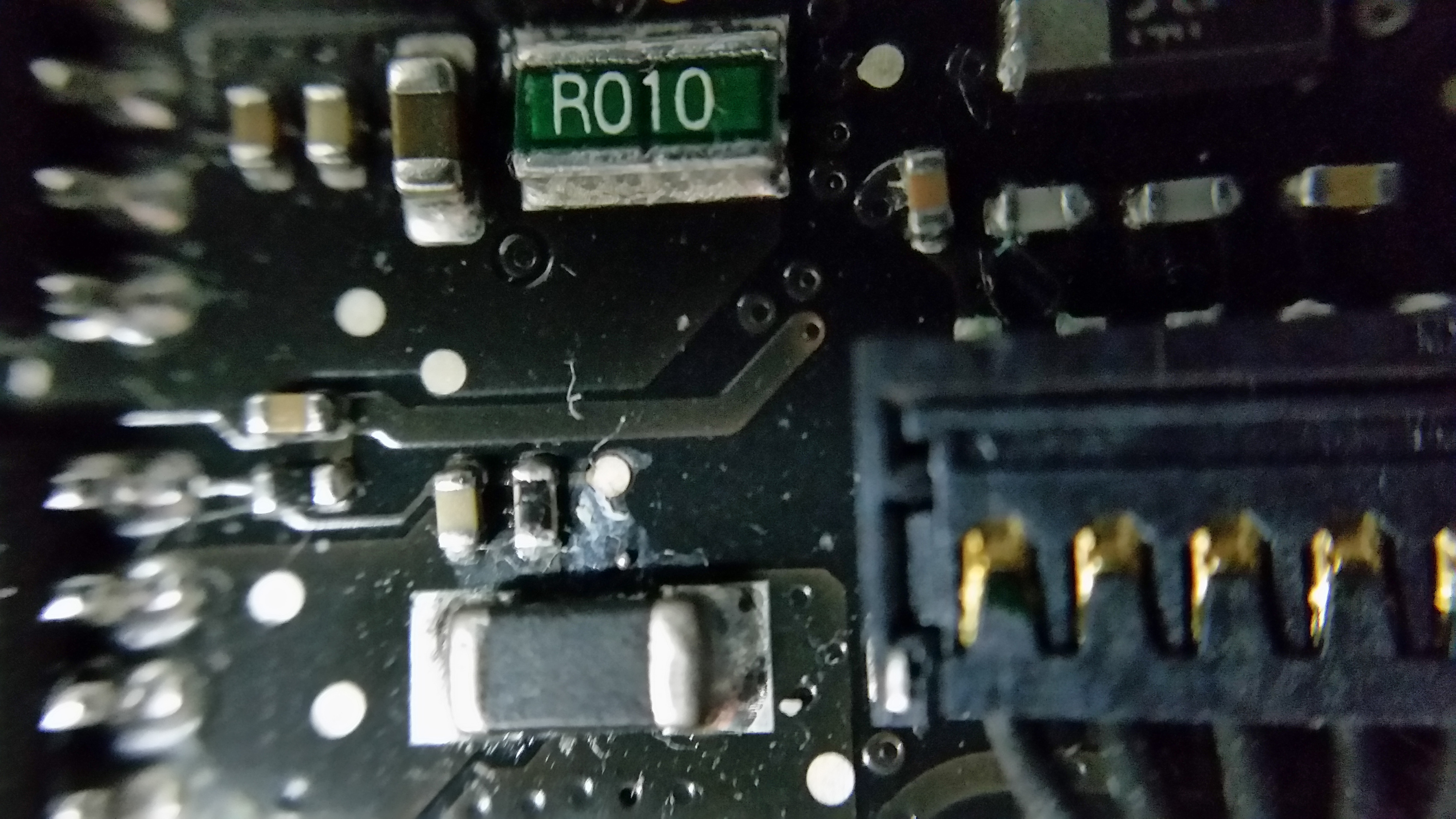

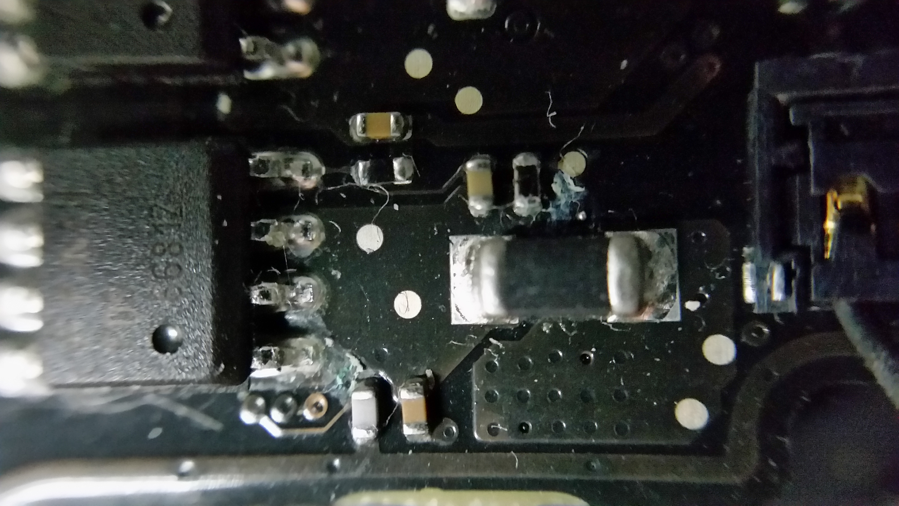

    820-2327 trackpad cant click.
    When the trackpad is plugged in you can't click on anything even with an external mouse. If I unplug the track pad and external mouse works but the keyboard stops.
    This machine has some visible water damage.
    I thought the Q5701 was bad but is think it is working properly bringing BUTTON_DISABLE to ground when not asleep if I read the schematic correctly I have the board view file and the schematic.
    I was surprised the keyboard didn't work when the trackpad was unplugged is that normal for this board?
    I would be happy if I could just have the kbd work with and external mouse.

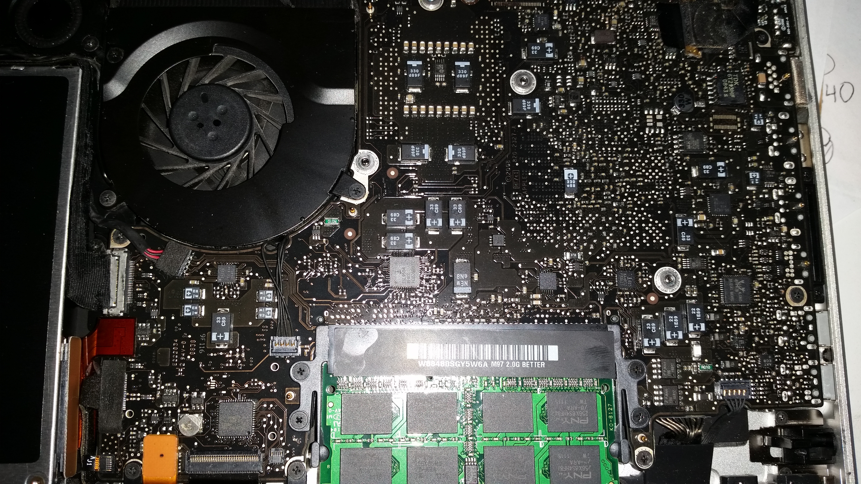

      post picture of board back and front in high quality.

          I all ready cleaned the board I can post some close ups of the areas that had visible damage before i cleaned them but I didn't take a over all picture then.

            Re: 820-2327 trackpad cant click.
            Here are some pictures. I didn't see any water damage on the backside.
