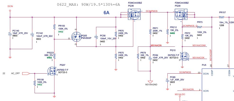

    Hi guys,

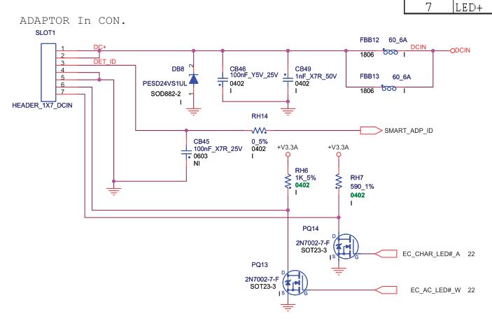

    have problems with compaq cq62. Laptop sometimes starts, works fine for some time and start switching between AC and battery. AC adaptor is ok, checked voltages, so are adaptor connector going on motherboard. When working normally all voltages readings are fine (checked only few components following DCIN).
    After some time LED signal (ACLED on image 1 in attachments) on connector stops shining and I hear component on motherboard clicking, as it appears to me it is coming from inductor PL7 (1R0). Also voltages which are in normal mode stable start to changle in clicking rithm. Anyone had similar problem?
    Voltages reading in working mode:
    DCIN = 19.48V
    PQ37 Drain = 19.15V
    PQ36 pin 4 = 9.59V
    PQ55 Gate = 19.28V
    when stops working all voltages except DCIN starts changing abnormally (for example PQ37 Drain changing between 5-19V).
    Please give me some advice what to do? I can upload full schematics if needed and measure voltages in points you tell me. Also can record sound if that could shorten diagnosis.

          Also AC_OFF signal is 0V in working mode, and when component starts making noise it changes between 0-3V.

                  Re: Compaq CQ62 power problem
                  You hear clicking of inductors most likely due to mosfet leaking...
                  When you pull out the battery,so that the laptop is only on adapter ,do you hear clicking...?
                  What are voltages in non working mode on :
                  +VBAT rail
                  ACIN,ACOK on MAX8731 ic
                  PQ55 drain
                  PQ38 gate
                  Acin needs to be low in order to have acok high to drive that transistor...Something could be wrong with internal comparator...
                  8731 is most likely culprit here,if you have it try to change it...if doesn`twork after replacement we will help you to diagnose it further...
