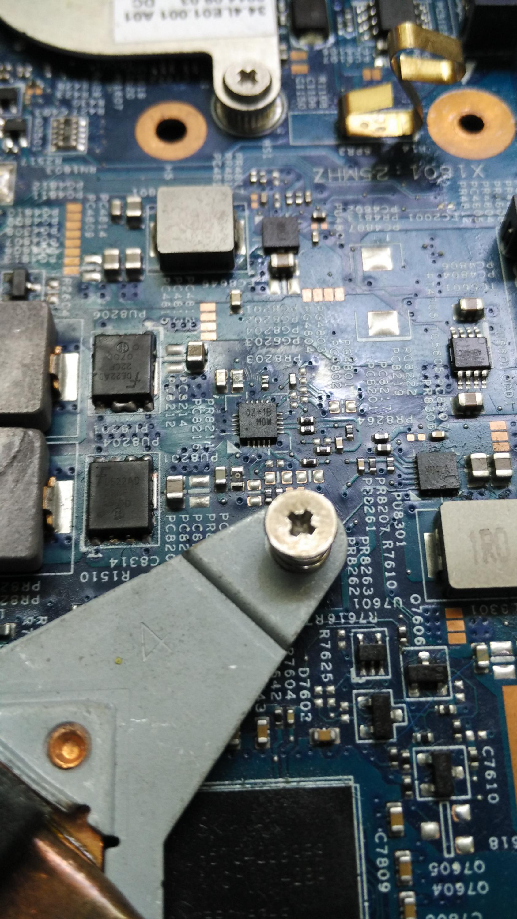

Help, I cant determine what type of ic is that
  • kazia
    • May 2015
    • 145
    • indonesia
    I cant determine what type of this IC, OZ=1B.
    it's asus x450 board, no out put on coil, and its for vga power.
    any one know this IC type.

    Re: Help, I cant determine what type of ic is that
    try this :
    http://ru.aliexpress.com/item/RT8812...287117881.html
      THX, it was RT8812A.
