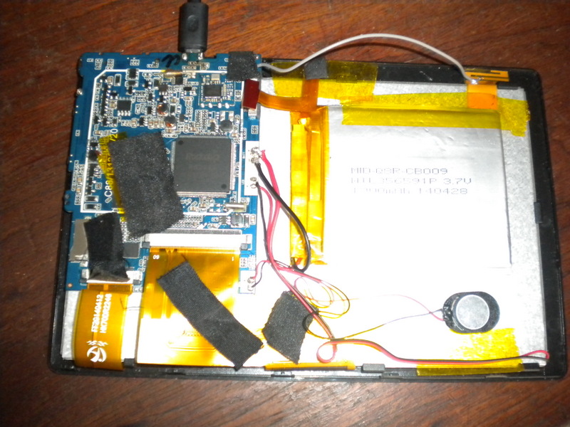

    Hi
    Got for repair dead "YOOZ mypad one" tablet
    platform : C88/131206/V20
    Found micro-usb power connector shorted inside and D+, D- and Id tracks burned.
    Changed connector, now powering is ok but could not find where to shunt Id, D+ and D- pins to motherboard, as tracks were damaged.
    Need schematic or a clear topside mobo photo or any suggestion as where to link Id, D+ and D- pins to mobo.
    Thank you

    can you make some clear photo with macro on the pins?
